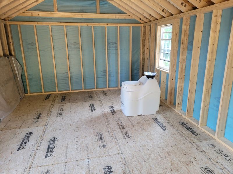

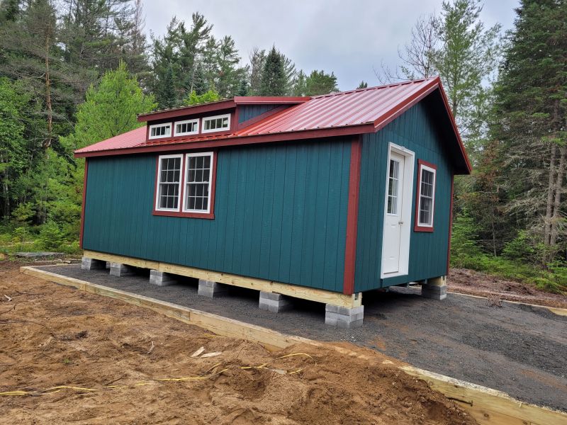

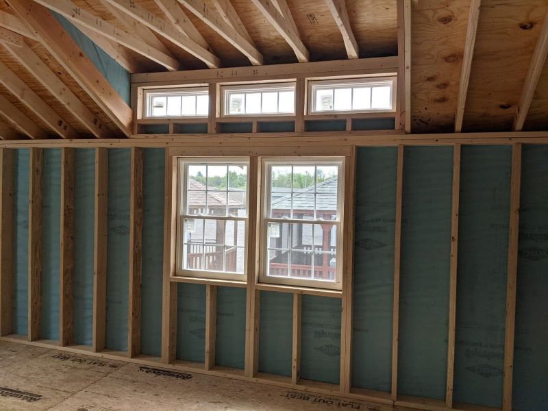

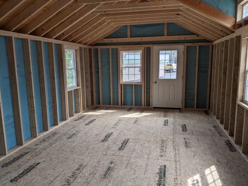

geobuild
# Posted: 25 Aug 2021 11:51am
Here are some pics.......

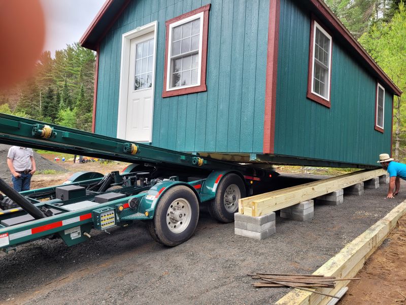

geobuild
# Posted: 25 Aug 2021 11:58am
I had a local Amish fellow and his crew build the crushed stone foundation and skids and will have them back next summer to build a 10 x 12 screened-in porch added to the 14'x24' cabin.

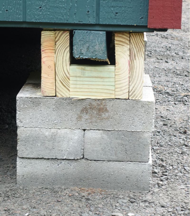

geobuild
# Posted: 25 Aug 2021 12:01pm - Edited by: geobuild
Foundation pics.....
geobuild
# Posted: 25 Aug 2021 12:08pm
Foundation pics (second try....)
5
5
6
6
7
7
jsahara24
# Posted: 25 Aug 2021 02:34pm
Nice setup!
# Posted: 25 Aug 2021 03:23pm - Edited by: Steve_S
I'm looking at the pictures and am curious.
What is that "blue" between the studs and sheathing ? Or is that wrap under the T-111 and that's all between the studs & cladding ?
geobuild
# Posted: 25 Aug 2021 04:20pm
Quoting: Steve_S
Hi Steve.... that's Dow building wrap....... Duratemp then wrap then studs......
