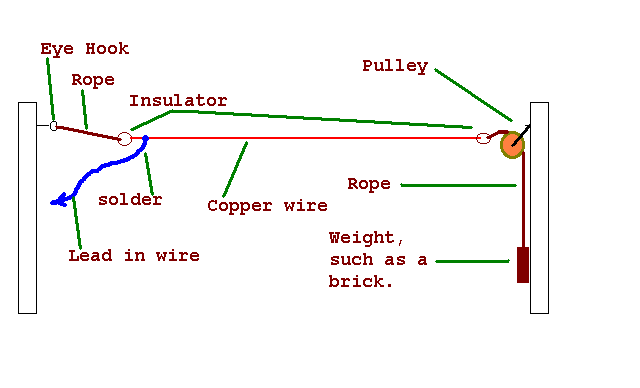

# Posted: 1 Jan 2021 08:33pm
Paulz,
Thanks for the kind words! I’m no expert, just an experimenter. I’ve had some good luck with outdoor wire antennas.
See attached image. An outdoor antenna up high gives great AM reception. One pictured uses a weight and pulley to keep wire from snapping with swaying tree. I’ve got about 100 feet or so up high, plus a ground rod. I connect antenna to ground when not in use; wind or snow can give a static charge, let alone lightning.
With a good outdoor antenna, you can get more signal. You may find too much signal on AM, receiving multiple stations on same frequency at night. An antenna run north-south will favor east- west reception and visa-versa, so you may want to orient according to your desired stations.
Any wire will work, go for durable.
Brettny, SSB or single side band is used by hams and pirate radio. If radio used doesn’t have SSB feature, the SSB sounds like Donald Duck. Pirates broadcast often on weekends and holidays. Rural areas have less man made radio interference and might get better reception. 6975 kHz is one common pirate frequency.
