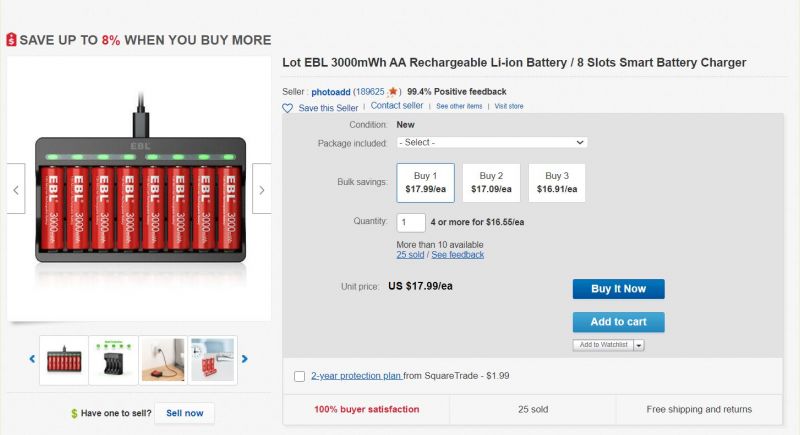

  I see HF sells Nimh rechargeable batteries and the charger, going there today so probly get some.  But while surfing I did notice some rechargeable lithiums, fwiw, no idea how good.
  Thanks guys.

  I have used Sanyo/Panasonic Eneloop AA and AAA NiMH rechargeable cells for probably 15 years now. They have made a few versions over the years, each one an improvement. Older NiMH cells had a higher rate of self-discharge. The latest version has an extremely low self-discharge.
  NiMH cells have a rated voltage of 1.2 volts. They work in almost all devices that are made to use alkaline batteries. Alkaline cells start with a higher voltage and drop continuously as they are used. The NiMH cells hold their voltage through virtually the entire discharge. As I said, most devices work well on them as most devices are made to work as alkaline cell voltage drops.
  To me, Eneloops are a little like Honda generators. Eneloops cost more than the other brands of NiMH. But like the Honda generator, they work well and are very long-lived.
  Those AA-sized rechargeable lithium-ion cells actually contain a small lithium-ion cell; the same chemistry that is used to make the 18650 3.6/3.7 volt rechargeable cells. The AA cells use a circuit board in each cell to reduce the voltage to 1.5 volts. It also boosts the charge voltage when the cells are charged. The idea is good, I am just not sure what the lifespan will be. That depends on the quality of the electronic components as well as the quality of the lithium-ion cells that are used in each cell.

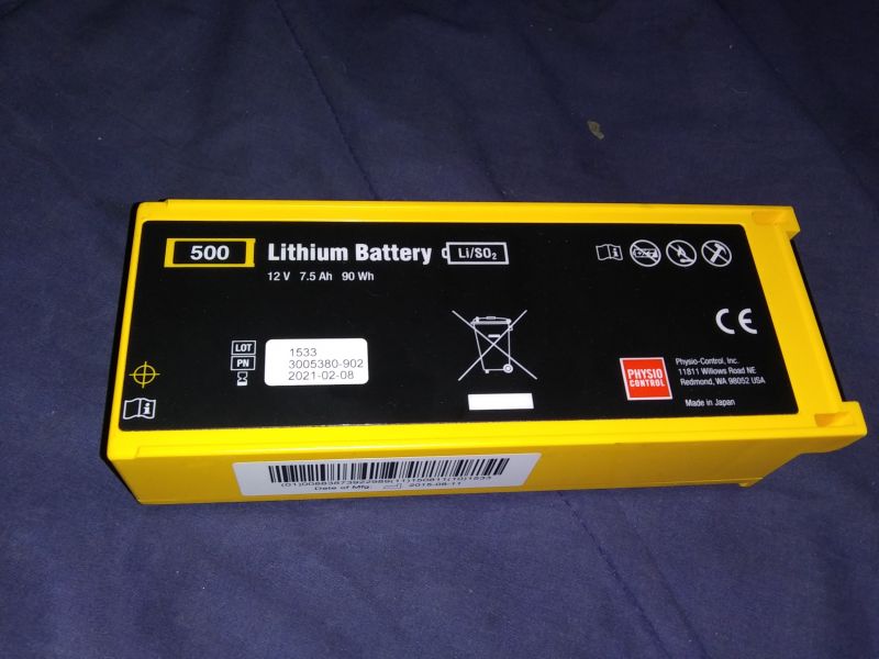

  While we're on the subject, I grabbed this out of the recycle box at the firehouse the other day, I think it went to a handheld light.  It's a lithium S02, sulfur.  dated 2016 but probably hardly used.  Thought maybe it might be salvageable but has les than a volt.
  Watcha think?
# Posted: 8 Mar 2021 10:32pm
  https://www.physio-control.com/product/LIFEPAK500/Power-Options/Li-SO2-Non-Rechargeab le-Battery/
# Posted: 9 Mar 2021 08:25am
  Ah, yes, it's out of a defibrillator.  Thanks.

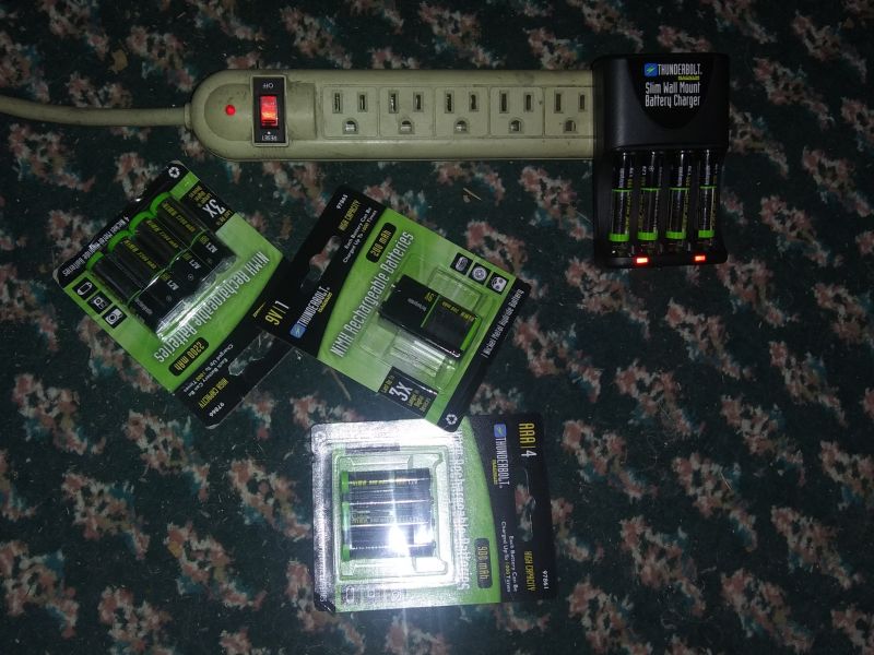

  Well Harbor Freight got me again, 30% off items up to $10, 5 item limit.  Did I mention HF is near my city house?
  On the charger now..
