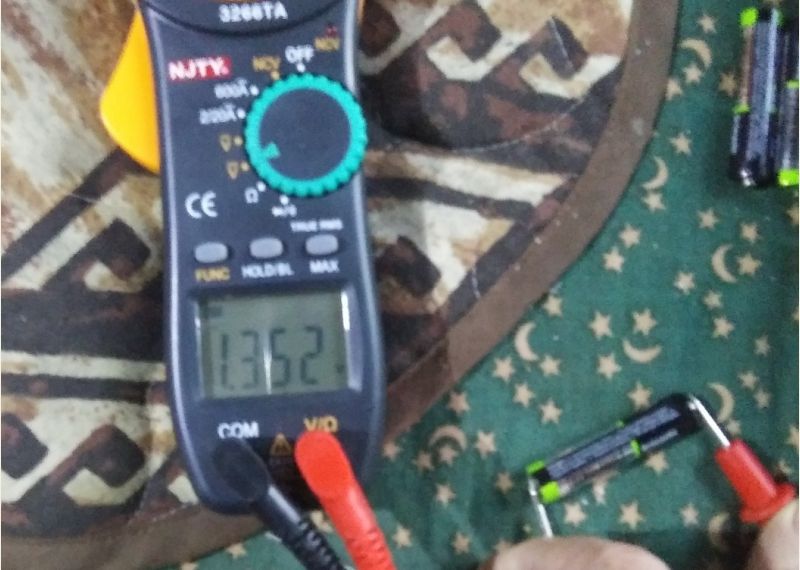

# Posted: 21 Mar 2021 10:46am
I put my new, freshly charged batteries in a led flashlight earlier this week, used it only briefly so far but pulled them out this morning, still reading 1.35v. I'll check again after I use it more.
