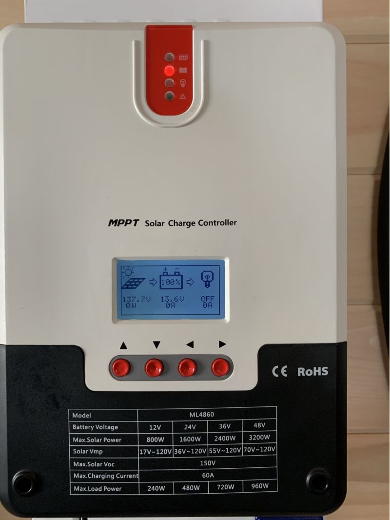

So I believe that leaves you with a charge controller that failed in some way. The picture
indicates the PV was connected and had a 137.7 voltage. The CC read the battery voltage as 13.6 and thought the batteries state of charge was 100%. That indicates something wrong.
IF that CC meter is like most others it is simply giving a % reading based on the range of voltage expected from a lead-acid string of batteries. A reading of 100% would be expected IF the batteries were configured as a 12 volt system. With the system configured as a 24 volt system, a 13.6 volt reading should have been indicating 0%.
When you last saw the CC it had been working properly and supplying readings in the expected 24 to 28 volt range?
I wonder if it is possible that because the voltage fell so low, because of the output draw, if it is possible that the CC reconfigured itself to believe it was connected to a 12 volt battery?
But that still does not explain why the CC system quit charging the batteries. There had been no other strange behavior in the time the system was used prior to being left sitting?

A question of sorts.... The 137.7 volts is quite close to the maximum voltage the CC will accept. It is supposed to shut down when voltage hits 150+. As it gets colder the voltage rises. Depending on how cold it gets it is possible the system shuts off on a very cold sunny day if the voltage rises too high. So, in theory you could have had sunny days and the panel power was not used.

I agree - the reading on the CC seems odd
Batteries were not 100% and all had failed with meter readings of around 0.9/1.1V
Likewise the 13.6V reading seems incorrect due to my 24V battery set up?
Interesting point in the CC reverting to thinking it was on a 12V system

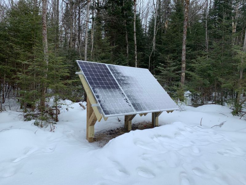

As for snow, my experience has been that snow has never remained on the panels for more than a day once the sun shines.
Interesting point but i have noticed that it seems to be different with my panels - here they are here
What seems to happen due to the amount of snow is that the snow does slide off, but literally falls in front of the panels and then if still snowing, begins to "back fill" onto the panels and creates a "wall" of snow which actually covers the panels
If you looks, you can see what i mean at the front of the panels in this picture as it starts to build up

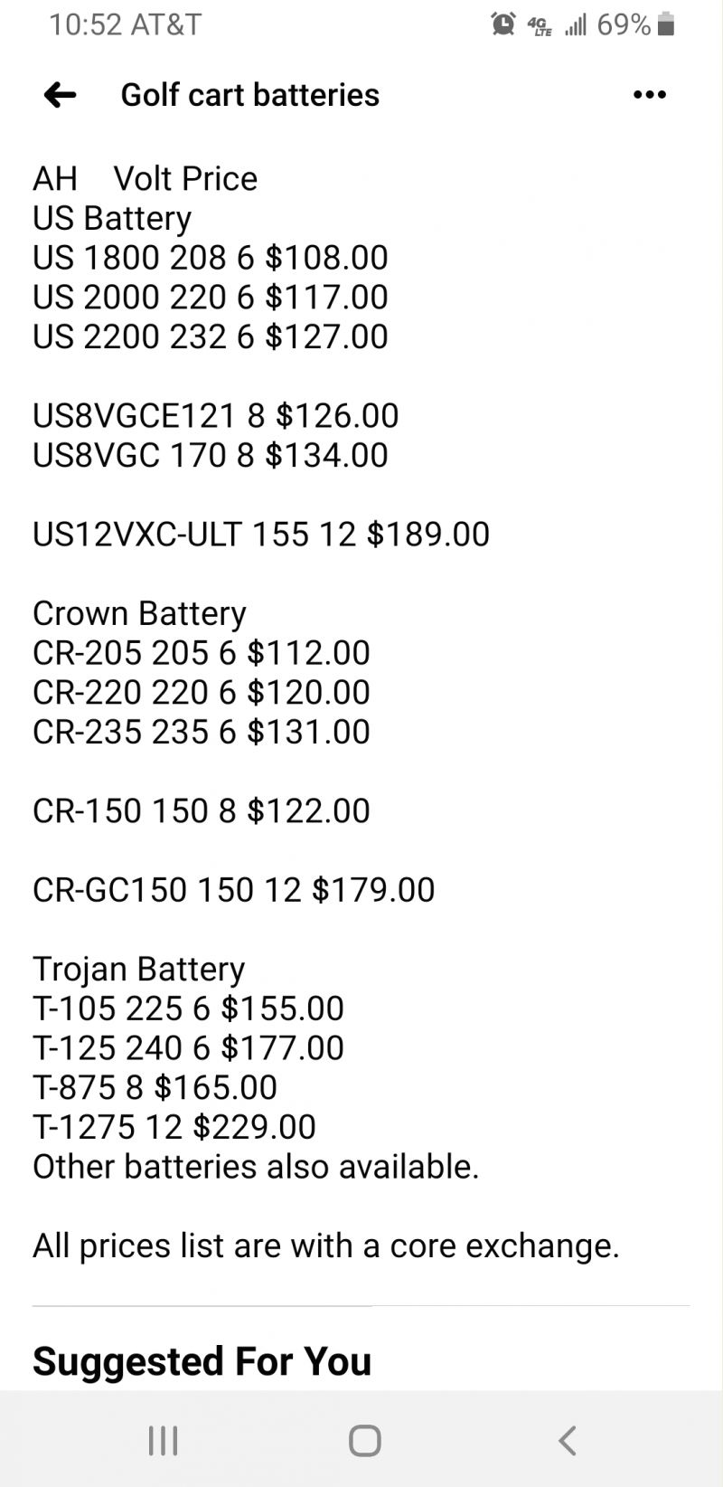

Smart chargers sold today will be no good to bring these back to life. You may need to buy an RV charger most are transformer based and can really push the amps/volts in. My iota brand 30a cost $100 and I can make it push 30a regardless of the batteries needs.
If you do need batteries I found a guy in highland NY that can get them. I'm getting two US battery gc2 220ah at the end of the week. I can get his number if you would like.

Probably going to go with what everyone else up at the camp seems to have (other than Lithium guys), which are the T105's
Going to go for 8 if i can get them
Brettny - can you send me that guys number - Highland NY - is that over Poughkeepsie way or is there another Highland somewhere?
And in terms of core exchange, i assume i simply take along these dead batteries i have for that?

Regarding batteries, I've been pretty happy with Duracell branded gc2 golf cart batts from Sam's club. They are made by East Penn who also makes Deka branded batteries. Less than $100 each.
