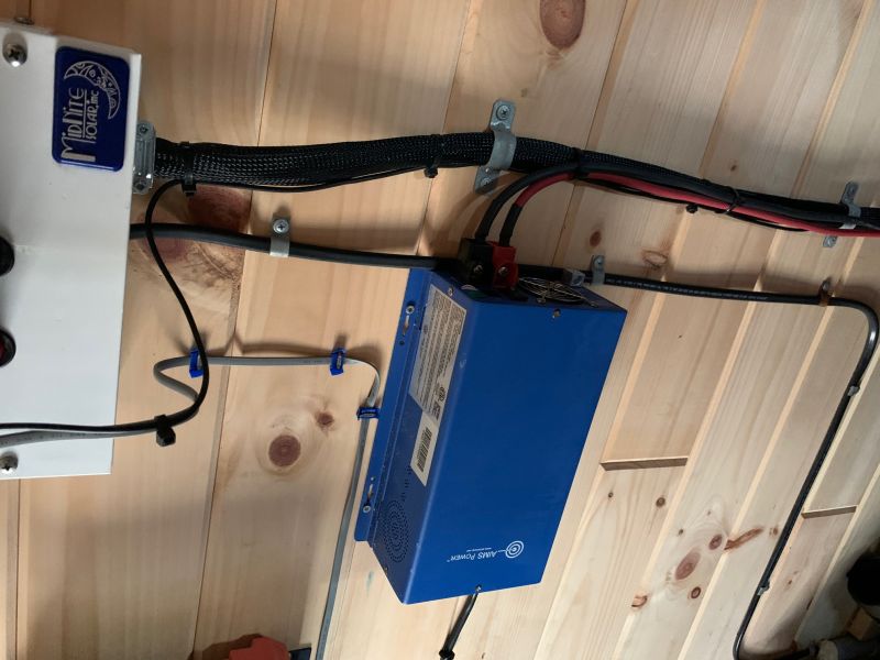

I have a Samlex 1500W inverter but that does NOT have a charger built in
So I also have a stand alone AIMS charger, which is literally plugged into a generator outlet and then wired to the battery bank
So when the generator comes on, it charges the batteries
So when i say unplug, i actually mean "unplug the charger" as it is plugged directly into an outlet
So i would have thought that i could simply unplug the charger from the outlet to stop any parasitic drain when i leave the cabin each time?
AIMS Charger
AIMS Charger
# Posted: 13 Apr 2021 12:03am
Thank you for clarifying what is to be unplugged.
Quoting: zorro
Quoting: zorro
"The main negative I see is that it draws a small but significant parasitic DC current, if left connected to a battery bank with no AC power source - this is worse if you leave its toggle switch on, a full 5.0W (0.2A @ 26V) on a 24V bank, but even with the switch off it pulls a constant 0.11-0.13A depending on DC battery voltage (3.2W at ~24V)"
I presume unplugging this each day should resolve that issue?
Maybe I am confused?
You are proposing unplugging the charger from an outlet to solve the problem. I interpret that to mean unplugging the cord that is plugged into an AC outlet. Right/wrong?
Then the quote you posted is speaking about there being a parasitic DC drain if left connected to batteries and not plugged into the AC mains. Right/wrong?
See why I am confused? The other guy says he found the charger draws current from the batteries when not actually connected to incoming AC. Meanwhile, you believe that unplugging from the AC outlet, which has no power because the generator is not running, will solve the parasitic drain problem.
If that charger draws DC power out of the batteries then you need to disconnect at least one wire that connects battery to charger. That disconnect you liked to would do that.
However, your inverter will still draw DC power from the battery if it is not properly turned off, hence my constant referral to and love of using a disconnect between it and the battery.

# Posted: 13 Apr 2021 02:26pm - Edited by: ICC
That AIMS charger comes from the factory with a cord fitted to plug into 120 VAC house power. There are no DC output cables attached to the charger the way it comes.
The picture of the charger (above someplace) has the charger mounted to a wall and the DC output cables nicely wire-tied in place. That makes me believe the ends that connect to the battery bank are hard wired, fixed with terminal bolts and nuts. Not an easy thing to disconnect without tools. If one elects to disconnect a DC wire at either the battery end or the charger end every time the system is to be left un-used, sooner or later there is a good chance of some sort accidental shorting with who knows what damages occuring. Especially for someone not well versed in electricity I think that is a disaster waiting to happen.
From what one person stated in the Amazon product review, that charger has a relay that is activated when the charger is connected to batteries. The exact purpose is not known for sure and why it is there does not matter to us. That reviewer stated they heard an audible click as soon as batteries were connected. They also supplied current readings so it seems like they had a meter of some kind and knew what they were doing. Let's assume the reviewer possess electrical knowledge. They stated there was a draw on the batteries when charger and batteries were connected together. They also stated this current amount varied with how the switch on the charger was set. BUT this current draw from the batteries existed even when the charger was not plugged into any AC power.
Therefore it will not help at all to unplug the 120 VAC plug from the outlet that the charger is usually plugged into.
I cannot put it any clearer. The system needs a disconnect in at least one of the DC wires that connect charger to batteries.
There should also be a fuse or breaker of an appropriate rating, as close as possible to the batteries + terminal to protect against a short circuit. If there is no fuse or breaker then the cables themselves become the fuse. Heavy cables may cause a fire before the cable burns off. Batteries have a lot of stored energy. It is possible to weld steel with just a couple of batteries wired in series. There are 8 batteries in this system. What a welder!
The people who designed this system should have known enough about the products they were selling to know this could be a problem in an off grid system. As well, IMO, AIMS blew the design. They designed the charger to be hard-wired, to be permanently connected to a battery and should have seen the design flaw.
My criticism is based upon the reviewer on Amazon so I could be wrong, but without having a hands-on experience of my own I believe my critique is valid.
