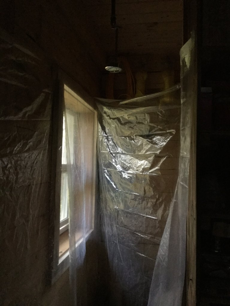

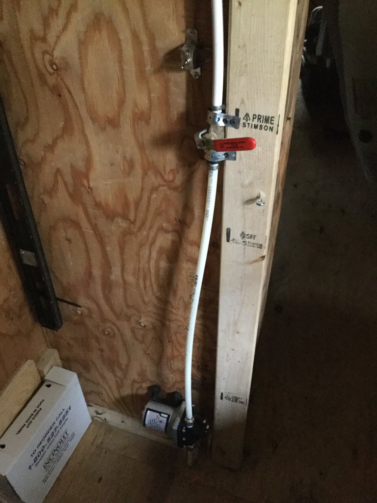

My beautiful wife n me can take a shower with a hot water canning pot. Heated up on the woodstove. I have a 12v pump and put a 1/4 turn shut off valve in line to control water pressure. And a toggle switch in line on the power to the pump.
Basically get wet switch pump off soap down n switch pump back on to rinse.
If just me I can easily take a shower that lasts 5 minutes or so by restricting the water pressure.
Pump, valve, switch
Pump, valve, switch
Our shower
Our shower
