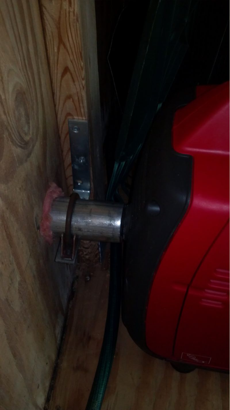

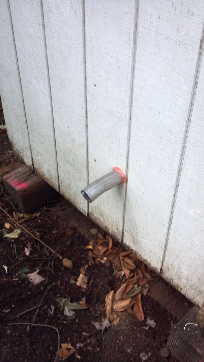

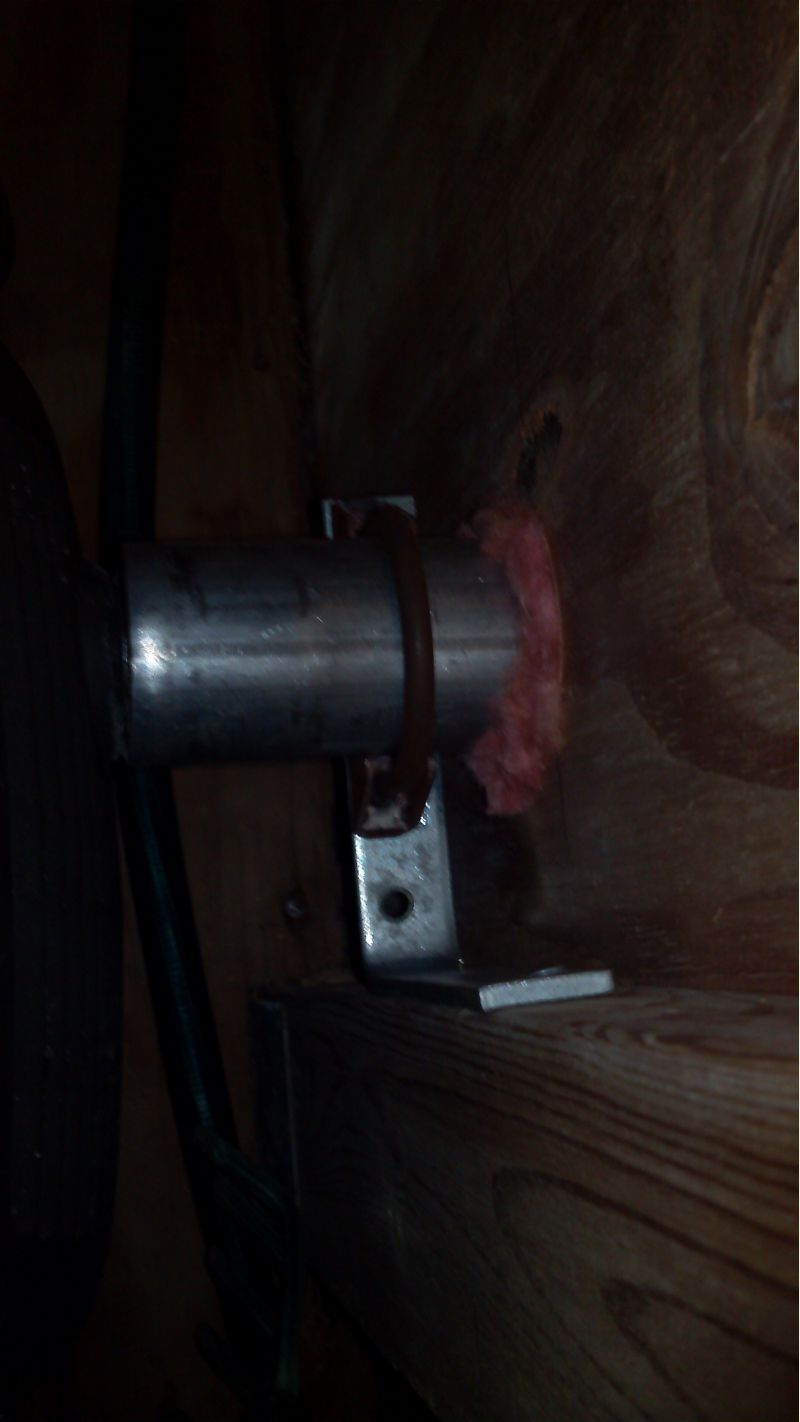

Among them: generator installed in shed! (see pix) Now I have to condition this by saying that I haven't fully tested everything. I didn't have time to install a CO2 detector to see how well the shed is vented. I actually didn't run the generator long enough to check this because I had plenty of solar power during my stay. As fall progresses and sunshine declines I'm sure I'll give it a more thorough test. One thing I did notice was the reverberation sound of the generator coming from the shed and the heat. The small enclosure (8' x 8') enhances the sound. I'll have to get back to you when I do a more thorough test with the shed door closed on noise levels. I have considered insulating around the generator to muffle the noise but with all the heat it puts out I don't think that is adviseable. In fact, I'm considering installing an exhaust fan to keep the shed cooler. this is something I will have to play around with since I also store lake-pumped water in barrels in the shed and the heat will keep them from freezing. It's a trade-off. So I don't have a whole lot to report but hopefully will be back up in the next few weeks (more clouds, less sun) and do a better test run and post those details. clamp assembly interior
|  exhaust at rear of shed
|  another view of clamp
