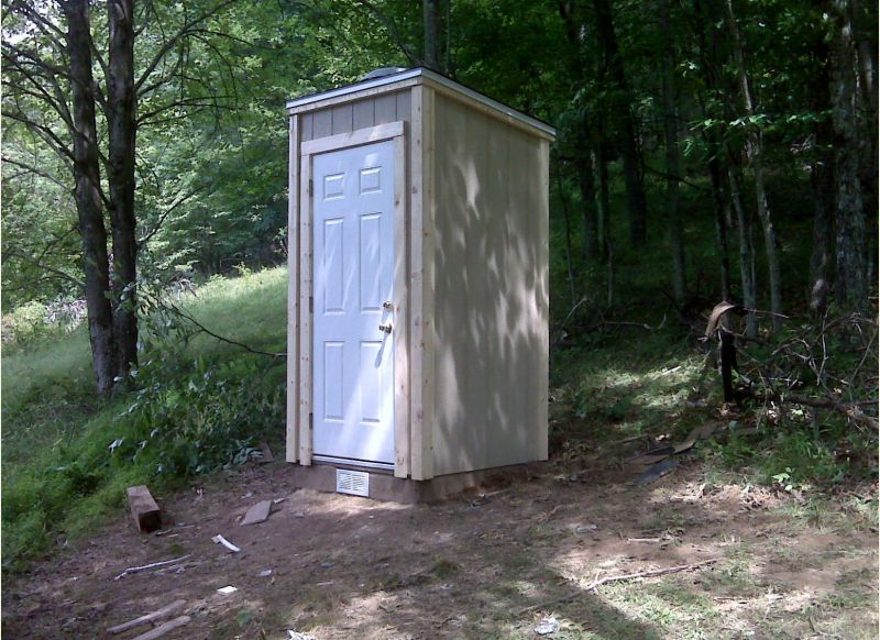

This is what I did for our generator shed....
The large louvered grill down low is for the exhaust. You can just make out the under-eave intake vents up high between the rafters. I have screen in all the openings. You can also see the small hinged access panel down low on the right. This gives access to the key and choke and outlets of our Honda EU3000i. It also eliminates the need to entire the shed to turn it off. Reducing any risk of CO poisoning.
Here is a shot from the inside. The generator sits in the corner.
The only thing I haven't installed yet is the vent fan. I plan to have a simple electric fan ducted to the large outlet. I will simply plug the fan into the generator and leave it on. the only time I need a fan is when the generator is running....and if it is running I am producing 110V. With 3000W available...I have plenty of power available.

I built a small generator shed with vents facing away from my cabin, insulated the walls with acoustical ceiling tile and mounted a roof ventalator fan on top of it. It has worked great and cut the noise level to almost nothing.

takes care of the sound but does anybody mistake your generator for a....... oh nevermind
