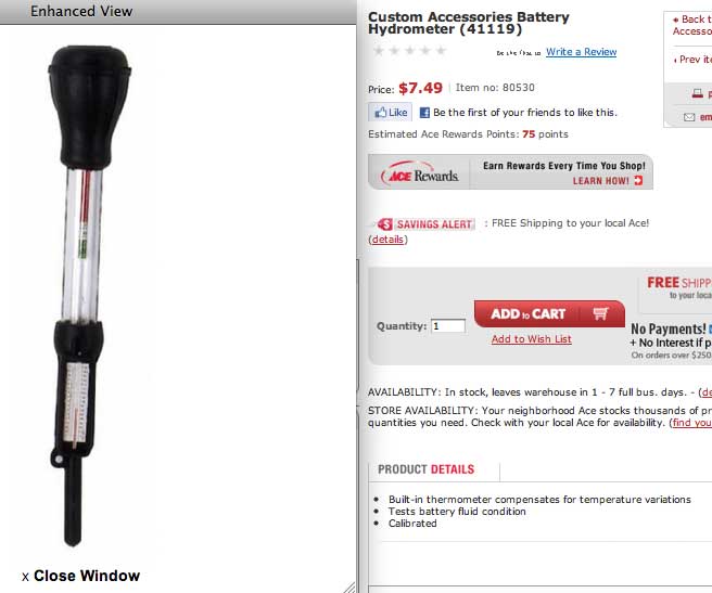

So here's what looks like an inexpensive hydrometer. Can those who know about such things weigh in? Thanks!
http://cgi.ebay.com/ebaymotors/ws/eBayISAPI.dll?ViewItem&item=370511317049&viewitem=& sspagename=STRK%3AMEWAX%3AIT
# Posted: 19 May 2011 10:25am
One with a thermometer would be better as fluid temperature influences the reading
http://www.acehardware.com/product/index.jsp?productId=1292142&CAWELAID=109343097
and Napa Auto sells them
p0rtia
# Posted: 19 May 2011 01:34pm
Thanks, MtnDon, I will go with the one you suggest. I had looked on the napa website but couldn't find it (I have to say I've been to the napa site various times looking for battery related stuff and it always defeats me. I'm sure it's there--just not for mere mortals.
# Posted: 19 May 2011 06:01pm
NAPA items are sometimes hard to locate online when it is not a vehicle specific part, but the store nearest me carries them in the store

Okay. So after the usual difficulties ordering anything on-line from Ace Hardware (or is it only me?), I've received my hydrometer and conducted my tests. I'm gonna start a thread on what I found, in the hopes that it will document my issues for my fellow solar newbies. Just wanted to direct anyone reading my contributions above to "False Voltage and Hydrometer Question." Come on down!
TomChum
# Posted: 13 Jun 2011 12:55am - Edited by: TomChum
Quoting: MtnDon
I think I'll get mine from Napa......
Ace Hardware - Battery Hydrometer with thermometer

Got the hydrometer, which changed my life. No seriously, it did. Enabled me to track the resuscitation of two sulfated batteries. Easy to use and invaluable. Thanks again MtnDon and TomChum!
