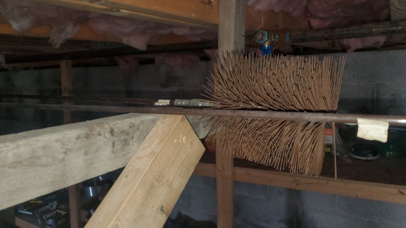

Tim, I had found this brush device in the basement in the cabin and I didn't know what it was for.
Now I suspect this was used to clean up the chimney.
It has a brush head and two fiberglass rods, each 4' in length.
Could you confirm this is for cleaning up the chimney?
TIA!

Yes , it is a chimney brush. I like the ones with the fibreglass wands. Use from roof top
