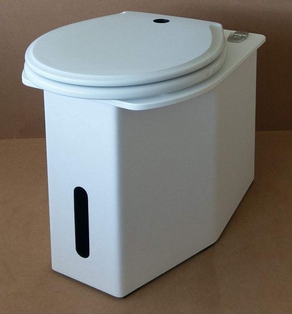

I recommend you take a look at the C-Head unit as well. I have had mine for several years now and really like it. It has urine separation, which is a must, and can be collected internally or diverted to a drain line. it's super easy to clean, uses easily modifiable 5 gallon buckets for storage, and looks more like a real toilet than most anything else on the market.
C-Head Toilet

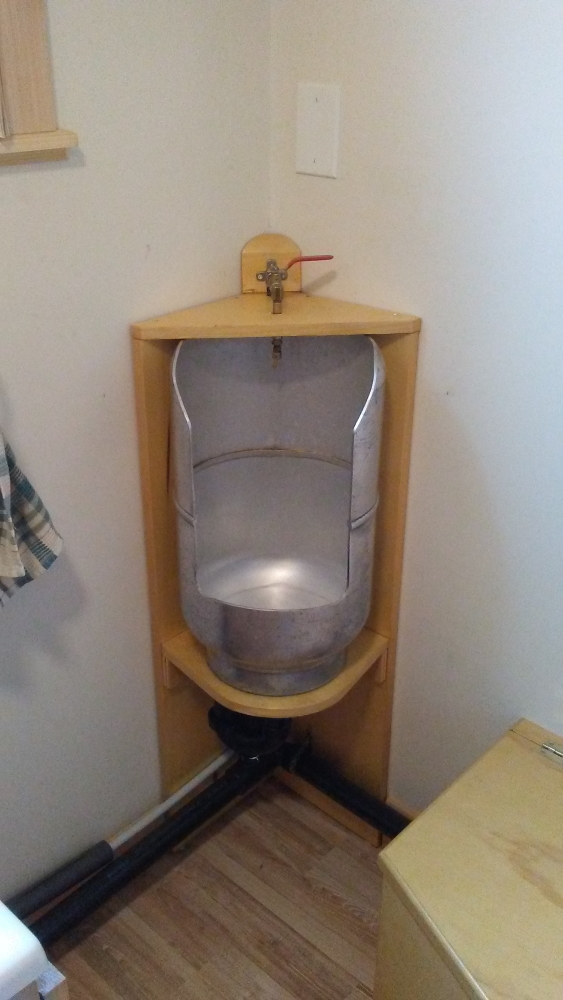

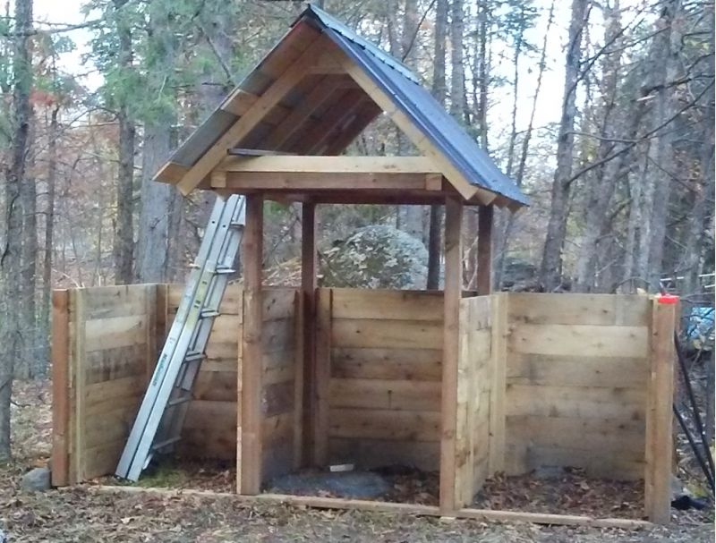

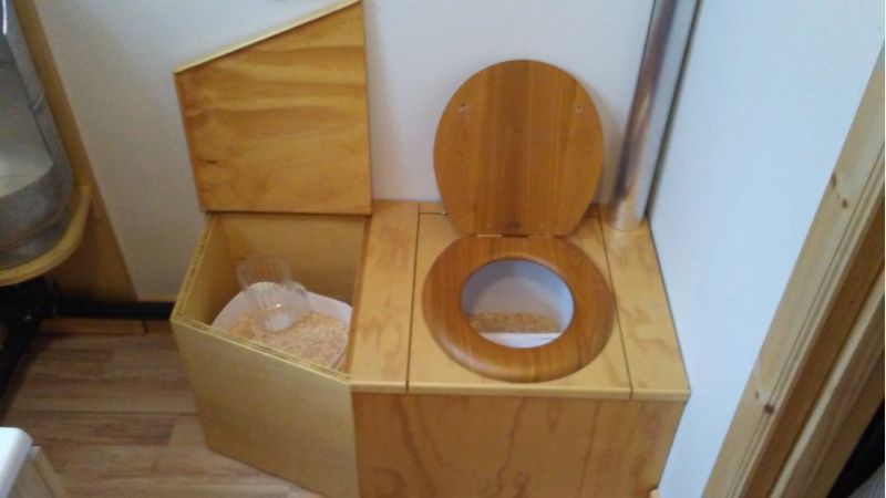

Attachments: Sawdust Toilet (Bucket System) with WeePee Urine diverter (there may be better ones for women). 3/4" PureBond Plywood, Finished with 4 coats of Polyurethane, very easy to cleanup and maintain.
Urinal: Made from a Forklift LPG Tank. Was a bugger to clean the outside, easy enough to cut the very thick aluminium. Exterior has 3 coats of Clear Eurathane.
Composting Structure, using 4x4PT posts and White Cedar Planks. Sawdust Toilet with sawdust bin
