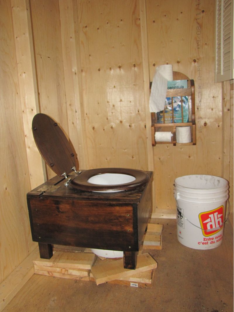

# Posted: 4 Nov 2021 06:19pm
We were using the “ humanure” compost toilet system for years in our outhouse. In winter, we simply brought it in to the cabin and put it where our indoor washroom would one day be. The beauty of this system is it is built around a 5 gallon pail. Put in a 2” base of peat moss and cover your business with two scoops of peat moss. We were really surprised how quickly any smells diminished once the peat moss...a major absorber...came into contact with the waste. We dump the bucket in our poop coral and every two years would recycle the soil into our wildflower gardens...absolutely no smell or hint that it was once human waste...just looks like peat moss.
This system passed my” wife and her friends” test, which is why we used it. With a running toilet now, we still bring the humanure toilet into the cabin washroom in the winter because we shut off our water. Honestly, We just pop open the window when we do #2 and the peat moss does the rest. If you’re really worried...for double duty...we just keep an odour neutralizer spray on the counter beside the little toilet. Works for us. I guess these systems are really popular in parts of the US where power goes off often....folks have them in their homes as a plan b during power outages.
bushbunkie
# Posted: 4 Nov 2021 06:22pm
Here’s a pic...
Humanure toilet box
Humanure toilet box
bushbunkie
# Posted: 4 Nov 2021 06:27pm
...goes from the outhouse in summer into cabin in winter.

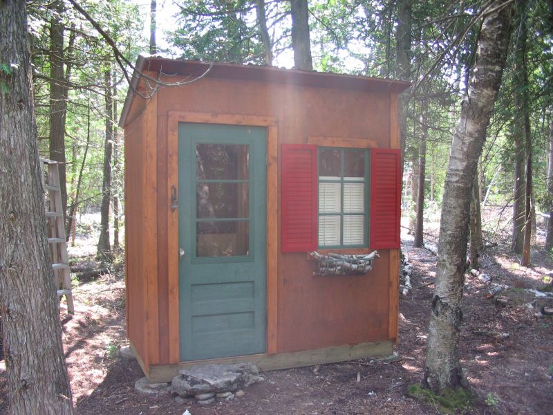

bushbunkie
# Posted: 4 Nov 2021 06:28pm
Purdy little outhouse...
Outhouse

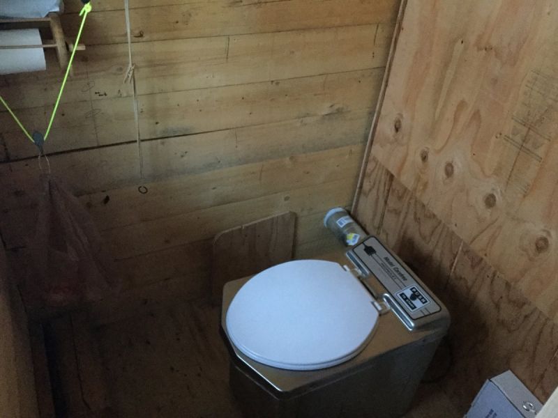

# Posted: 9 Nov 2021 09:42am
I installed an Incinolet toilet. Hooks up with 4" abs black pipe. Really easy. If in your situation I believe would work. I paid 800 bucks for a used one. They are used on boats. Lots of boats up Lake Superior ways. Maybe check up those area for sale papers.
Made from stainless steel so doesn't rust. I've not had any issues with it running. No odors. I've read others write about odors butt even my beautiful wife with a sensitive nose has no issues. There is very little smell.
It does take about 45 minutes to fully burn. And burning 1000s of degrees burns everything.
When I'm there I simply prop the chute door open n use it like the toilet seat on a bucket with several good garbage bags in it.
You buy special paper liners that fit it so pretty much no cleaning that part of the toilet either. They are not too expensive
It does take 30 amps to run. For us , we bought a larger generator but you have service. Should be a pretty easy set up.
Hey worked good for us. I have a nice window in front of the toilet to look out so don't miss pooping outside. Gets kinda cold here too
Incinolet
Incinolet
