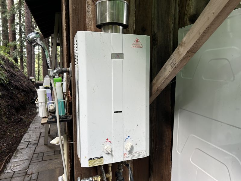

Spam? Anyway like many of you I have the Ecotemp. I also have gravity feed to the cabin, about 30’, but it won’t fire up the Ecotemp unless I run the cabin pump. Too bad cause there’s enough gravity feed at the shower head (in photo) to shower without the pump.

You might already be aware of this but you can adjust the internal valve:
"you may need to perform a water pressure adjustment to allow more water in."
link to the eccotemp support article is
Water pressure Adjustment
It's a bit finicky so only make small changes at a time. As the article states "This will enable the portable tankless water heater to operate at a lower water pressure by restricting flow."

# Posted: 25 Mar 2024 10:16am - Edited by: paulz
Sweet, thank you!

# Posted: 25 Mar 2024 11:51am
Well I got the shower to turn the heater on without the pump! But I had to turn the screw (the right one in the photo I hope) in about a turn. If you go further it starts to drip out around the screw.
So I’ll be keeping a close eye on it for awhile..

# Posted: 25 Mar 2024 02:19pm
I tried to take a shower… Funny thing, the heater only works with the shower head on the ground. Lift it up to head height and the heater stops. Screwed the adjuster in more, no help. So it’s right on the borderline. And that’s with the water tank full.
Then I tried the wash machine, same thing, no go without the pump. The bit of good news is with the shower head in the washer and the washer on, it will run both, so I can fill the washer without the pump on. Need juice to run the washer so might as well run the pump…
Oh well. Other option would be to shower on the ground..
