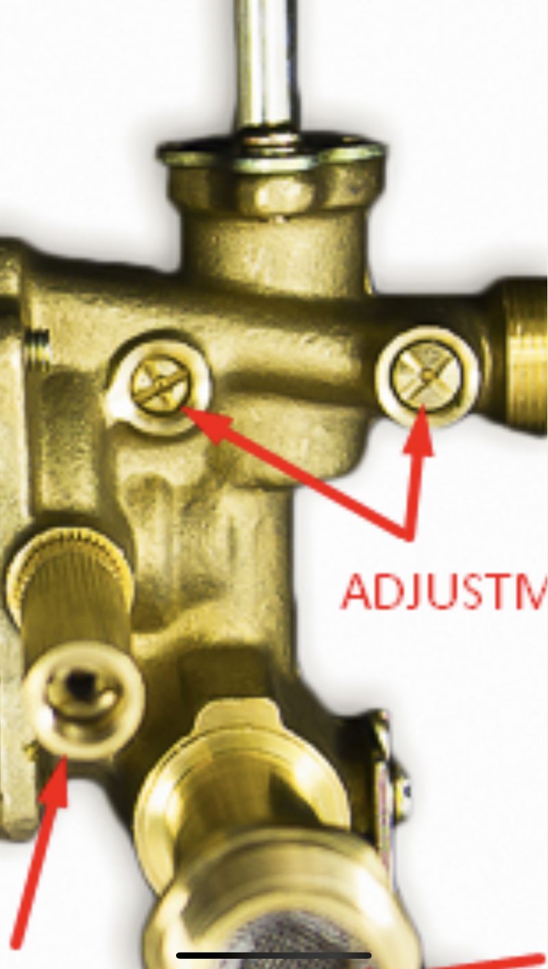

Found a more detailed Ecotemp document stating BOTH of those screws need adjusting to lower operating water pressure from 40psi. Stormy today, will report back.

Storm hasn’t hit yet, we’re all waiting anxiously (well me at least) so I went out and turned the other screw in. Some help, was able to raise the shower head to the L5 height but still quit at head height. Tried it again with the shower head undone, just the little plastic hose. That worked at head height! So I just need to find a water head that won’t restrict, maybe a kitchen sink head.

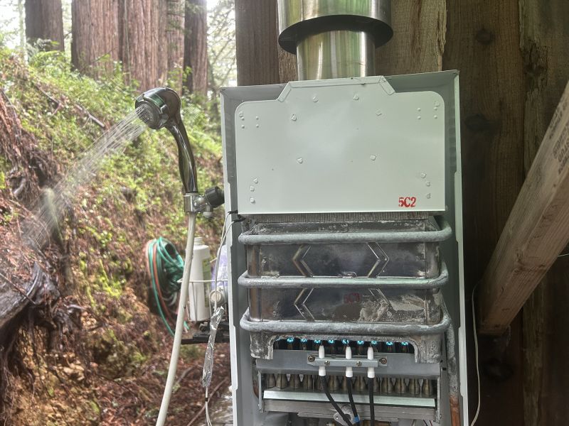

Yep, just took it out. Pretty good spray for no pump. I’m at the ragged edge of those screw settings, but it’s working. Tank is on that hill up left.

Im puzzled how by turning them 'in' can make them just shy of coming out???
# Posted: 27 Mar 2024 07:46pm - Edited by: paulz
Is that something I wrote or is it in the documentation? I have only turned them in. The first one I did yesterday, after about a turn it began to drip past the screw. Why screwing it in makes it drip I don’t know, but it did it again today, so I screwed it back out a touch until it stopped dripping. Still about a turn in from where I started.
The other screw I did today went about bit less than a turn in then stopped, like it bottomed. I just backed it off touch.
That’s where it’s at, again both are in about a turn. Still working, tested both sink and shower again.

Guess I was thinking that the leaking was because the screw(s) were almost 'out' of engagement.
So, they are just like carb mix adj screws. Id turn into bottomed counting the turn and back out to your functional point. Ime its always good to have a reference point.
# Posted: 27 Mar 2024 09:12pm
Yeah, weird that it would leak going in. Unless it’s about ready to run out of thread going in. It doesn’t bottom like the other one.
I really have no idea what those screws do. Hopefully won’t have to find out the hard way.

Beats me. I looked around online, could find no other info. Looks like two related things go on: the igniters that spark the gas and the gas flow itself, both only happen with water flow and they seem to happen independently. Sometimes igniters go but no gas flow to be lit.
There’s a diaphragm in that valve, a micro switch that I guess powers the igniters, a solenoid for the gas powered by something.. both of those adjuster screws have a hole in the center of the slot, looks like maybe a shaft sticks up through inside..

The L5 has the same knobs and as shown in my page 1 pic, both are near low for me also.
