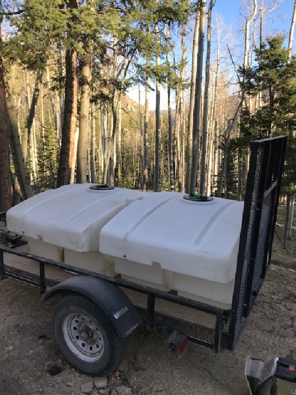

Scored big time on hard water tanks for winter use under the cabin! I was at the local CoOp and saw a couple of rectangular pickup water hauling tanks. I had been looking at these because they are only 28" high. The one I was looking at was 305 gallons and cost $645. It is 58"l 60"w30"h (with lid, 28" lid off.)
The ones at the CoOp were smaller measuring 58"l 38"w 28"h without the lid. But, they had 2 of them. So I inquired about the price gand the section manager told me they had been there for years and weren't in the system, so not for sale. I pleaded my case so he tried to call the big boss... no answer. So he said, " I know grossly under priced but give me $100 each and they're yours." Couldn't get my wallet out fast enough!
As near as I can figure as they are odd shaped tanks, they are 195 gallons each, so I'll have nearly 400 gallons of winter water storage under the cabin. Elated!
Now to figure out the best way to tie them together. My thoughts are 2" pipe with a tee between them to add a 1" drain valve and a tee at the second one that I can reduce to 3/4" to feed my pump. I will top fill with a 1" on the furthest tank and vent/overflow with a 1" on the other tank. Both of those lines running to the outside of the cabin. The fill line slightly angled up to drain back to the tank, the vent/overflow slightly angled down to drain out to the outside. Both will be on top the tanks.... the fill on the apex of the curved top, the vent/overflow a little lower on the curved top.
Does that sound right? I've never tried to connect 2 tanks.

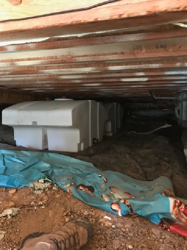

Winter water tank project underway! Tanks all washed out and sanitized. Started 3 days ago digging out and leveling the area where they will sit. As I've said in the past, the ground under the cabin is very hard and rocky, so bought a handheld 18#, 10amp jackhammer from Amazon. It was the ticket! The area needing excavated was 10' x 5' with depths from 4" to 10". I spent nearly 2 hours with the jackhammer hitting every 4" of that area. Then dug for another hour.. What a job... really tore up my arm!
Ended up hiring a couple local guys to help me yesterday to dig the soil out... hauling it one sled load at a time.... level, replace the ground cover and drag the tanks under there. BTW... the tanks are sitting on a sheet of ground contact plywood that was placed on top of the ground cover plastic (old billboard tarp, heavy duty!). Took the three of us 5 hours to excavate and level the pad! Glad that task is completed!
Over the next week or so I'll get it plumbed and the new pump set. Ordered an rv tank monitor and sensors so we can keep track of the water levels without crawling under the cabin.
Stay tuned, more pictures to follow as I get it plumbed and ready for winter! ..... some of the aspens already turning, when did we have summer?

How far is it from the bottom of the floor joists to the ground the tanks are sitting on? I recently thought about doing some similar excavating myself. I was going to use a rotary hammer with a small spade attachment (it's mostly dirt), but decided it was really going to be too much work. You might've breathed life back into my idea. What did you use exactly to sled the dirt out of there?
# Posted: 2 Sep 2022 10:57pm
These pickup water tanks are 28" high. I figured I needed 36" from the flattened pad to the bottom of the floor joist. Once the tanks were in place it was perfect. I can easily get the lids off and look into the tanks.
I used a snow sled that is about 4' long. We put down cardboard to help it slide out on. It worked quite well. It worked best when the other two guys were there and we could take turns filling, digging and pulling the sled.
I did put the bulkheads in before putting the tanks under the cabin... would have been pretty tough to put them in after putting the tanks under the cabin.
I say go for it! Just be prepared for some intense work! Once the tanks are under you will be glad!
