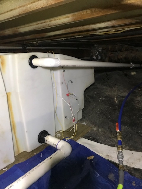

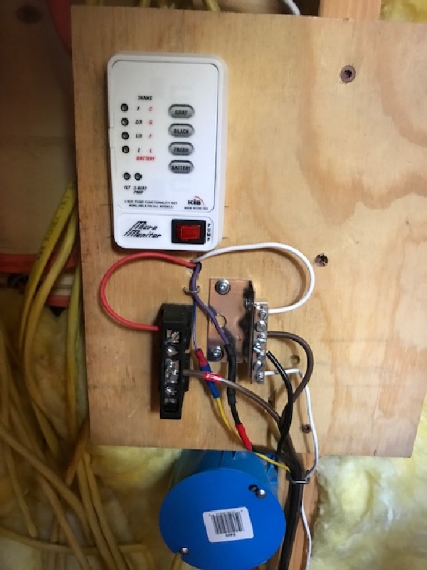

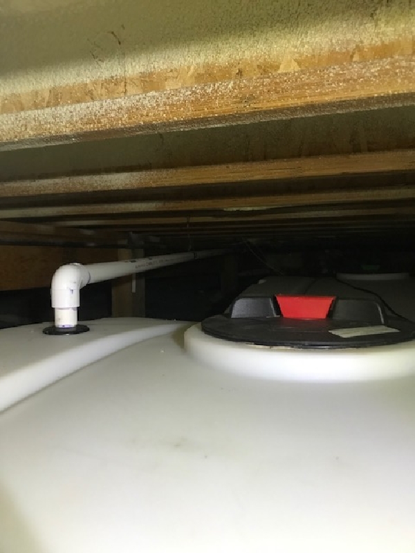

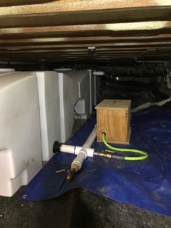

Well the winter water storage project is nearly completed. Only thing left is to insulate the pipes for a little added security and tidy up the wiring.
Used 1" fill sloping up from the tanks to a handy spot near the front porch. A 1 1/2" pipe for overflow sloping down and to the outside where a 90* elbow directs the water away... the elbow has both flyscreen then 1/4" hardware cloth clamped over the opening. The tanks are connected by 2" pipe then a 3/4" valved outlet to the pump and currently a 3/4" valve for draining... that will be sized up to 1 1/2" next year (that should explain the reducers in the picture.)
The RV pump is of course in the box with a small pressure tank. I used drinking water safe Flexzilla hoses for connections from tank to pump/pump to PEX then a Sharkbite tee onto the existing copper. Two valves under the cabin can be opened or closed to switch from outside cistern to the winter tanks. The valves can be reached from outside through a small access door.
The RV tank sensors are perfect for the job. Put the first 125 gallons in then drilled right at the waterline. Second at the 250 mark and the third at 375 which is just below the overflow pipe. The monitor panel is under the stairway where our battery storage is located. A 120vac to 12vdc transformer provides the power for both the pump and level monitor.

Two days ago the water system for the outside cistern froze so I switched over to the under cabin tanks. Sweet to have that in place! Yesterday the outside water thawed out so we switched back. There was a little over 200 gallons in there so we wanted to use it up. My wife did 3 loads of laundry. We'll this morning frozen again. Put a heater in the pump box and finally by noon got it running again. My wife did dishes and we both got showers then went out to winterize and drain the cistern. Pumped RV antifreeze through the pipes over to the cabin then commenced to drain the cistern. Just a pencil sizestream from a 1" pipe. Had a plug right where the pipe goes through the wall into the tank. Taking that plug out I got a finger in there.... ice right at the wall. Put a piece of pipe in where the plug was and filled it with hot water. Started to fill then the water just started flowing in. The down stream valve was off so the water gad to be going back into the tank. Sure enough, turned the drain valve on and a full pipe of water! Only about 150 gallons left so just letting in run out.
So glad we have the under cabin tanks! That was a bunch of work but I believe our winter water issues are over. I see the remote thermometer says it's 44*F under there right now!
