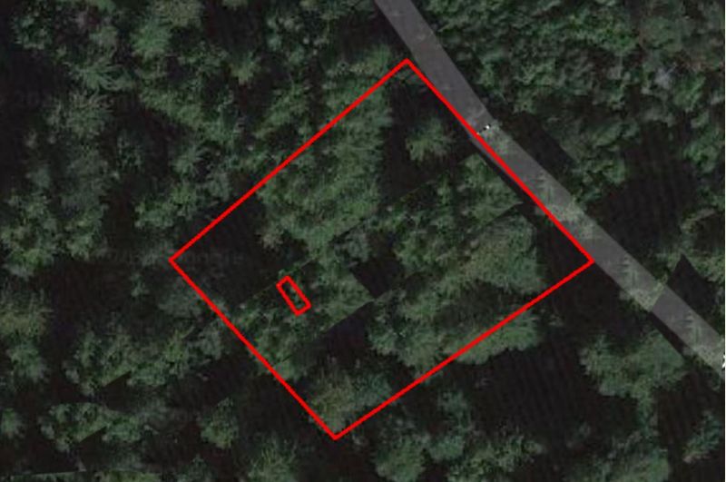

Here's my excuse for not investing heavily into solar.
Never expected to get this far. My fridge, wifi, water pump, lights are all 12vdc. Wiring not a big deal in 300sf. Inverters and AC are a new addition and only for occasional use, toaster, nuker, 42" TV..
So far..
