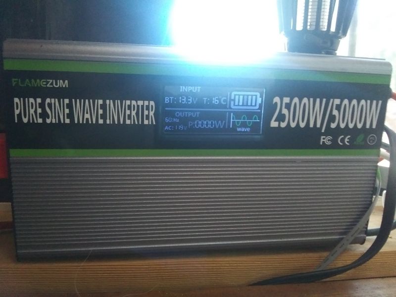

Well my new 2500/5000W CCI has an issue. It will run light loads no problem, up to the 1,000W toaster. But with the microwave, it runs about a minute, around 1,500W (according to the built in display), then just shuts off. None of the warning beeps it's supposed to have, low input voltage, overheated, etc., go off, and both of those values are below limits, again according to the built in display. it will restart immediately.
No biggie, rarely use the nuker. I did buy the extended warranty, could return it but it works fine otherwise. Wonder why it shuts down?

Are your cables really big enough? All the ends really good?
Return asap (so they can re-box it and send to somebody else ?) You may get a better unit this next time, and you did pay for the Ex War.
# Posted: 7 Apr 2022 12:02pm
6awg cables, 3'. It came with small cables that I didn't use. And like I said, it's supposed to have a 'low input voltage' alarm. Also says low voltage power off is like 10v or so, it's showing way above that when it shuts down. And when it shuts down there's no red LED or anything, just looks like I powered it off.
I have another set of cables, maybe I will try doubling them up for a test.
When the incoming voltage is too high or too low they are supposed to shut down. A defective unit could also be a reason.
What inverter is this ?
# Posted: 7 Apr 2022 02:38pm
It's the magnificent Flamezum 2,500, 200 bucks shipped.
I have sat there looking at it when it shuts down, the voltage is above the point where the low voltage alarm is supposed to sound, and way above the low voltage shutdown level.

"No good, 1000w with 2000w max wouldn’t run a 1000w appliance. At 900 watts it beeped relentlessly and finally shut off. Had to return it and upgrade."
# Posted: 8 Apr 2022 11:16am
Thanks ICC. I tried it again this morning. Runs the toaster at 1,000w no problem. Turned on the fan and heater, 1,700w, turned off soon after. But again no beeps or warning.
Not sure it's worth returning. $200 for a 1,000w PSW isn't a bad deal, I can use it in the shop or in the cabin for lighter loads. But I've learned my lesson, next inverter will be a quality brand.
