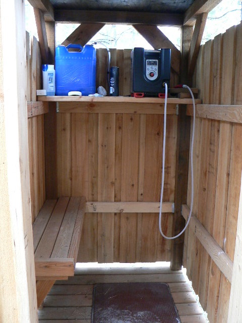

Mr Heater Aqua Cube and a nice little cedar enclosure so there is enough room to change right inside the shower stall.

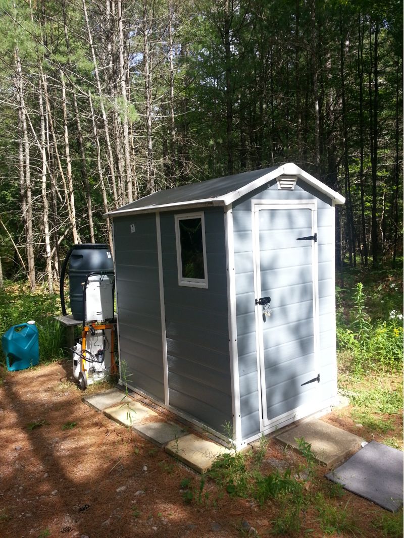

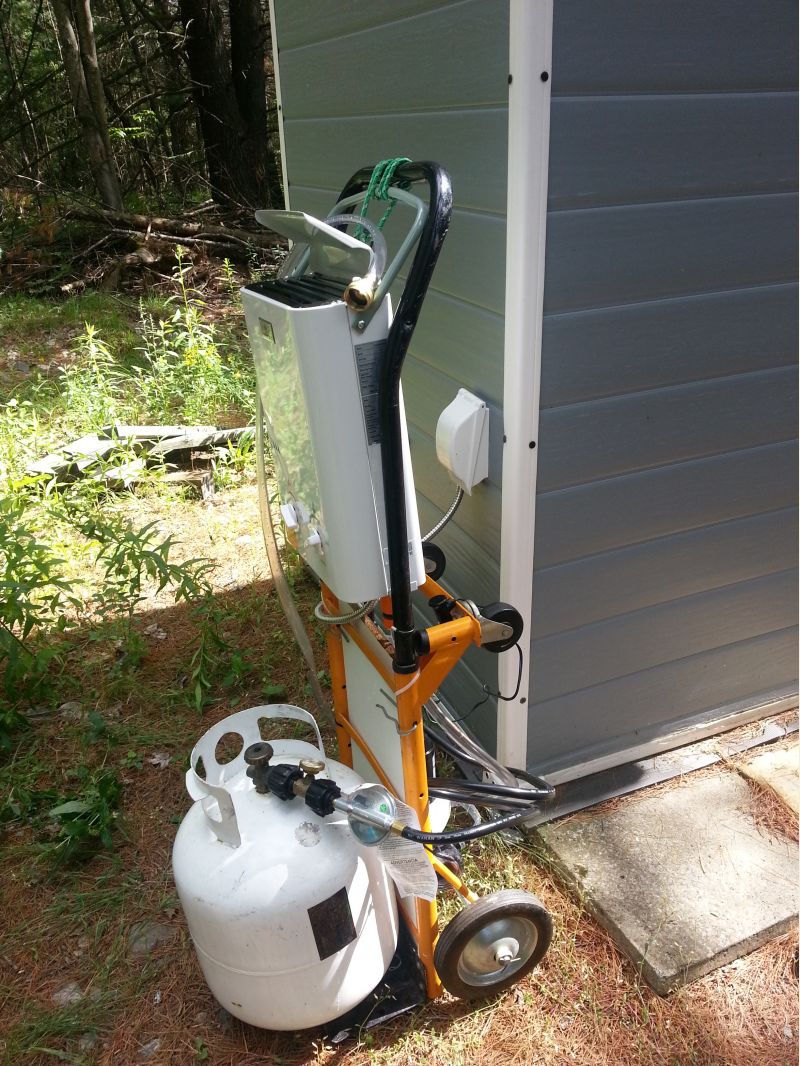

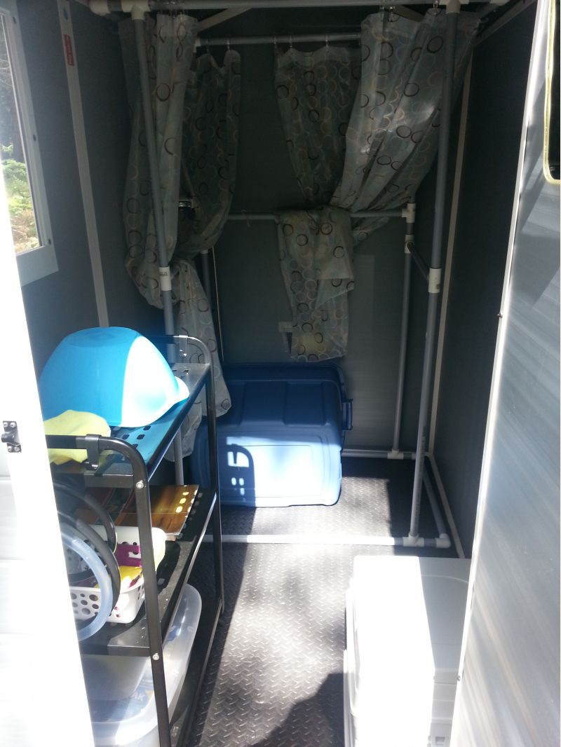

Big fan of the Eccotemp L5. So much so I became a dealer here in Ontario. We rigged one up onto a mobile cart and converted a small shed into a washroom/bathhouse.![20160716_16.18.23..jpg 20160716_16.18.23..jpg](https://www.small-cabin.com/forum/shared_files/uploaded/1142/124389_1.jpg) 20160716_16.18.23..jpg
| ![20160716_16.18.43..jpg 20160716_16.18.43..jpg](https://www.small-cabin.com/forum/shared_files/uploaded/1142/124389_2.jpg) 20160716_16.18.43..jpg
| ![20160716_16.19.43..jpg 20160716_16.19.43..jpg](https://www.small-cabin.com/forum/shared_files/uploaded/1142/124389_3.jpg) 20160716_16.19.43..jpg
