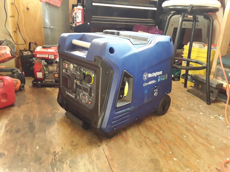

Picked up this iGen4500 dual fuel last week in AZ when we took the campervan back for the winter.
Has a total of 2hours run time on it! The guy got tired of fiddling with it so sold it as a "needs work" machine. He says it won't run on propane... I use gas so no worries and the electric/remote start doesn't work. Three or four pulls on the cord (I'm going to change out the Chinese Torch plug for a Champion which should help starting) and it runs like a champ! We put a heat gun and a hair driver, both on high and it pulled it down but chugged away.
I found a Westinghouse service bulletin about the no electric start issue... took the machine apart and figured out he had already addressed that issue. After a bunch of testing I am convinced the Start Module is bad.
So filled a "tech help needed" claim with Westinghouse yesterday. By this morning a tech had emailed and after a couple of stupid questions ( I'm sure they've seen it all) like, "this is how to connect the battery, is it connected? " He finally came back with, "Sounds like you need a new Start Module." He sent me a link to buy the part... I couldn't find one anywhere I searched on the internet... total $40 with shipping and tax.
Oh did I mention I only gave $250 for the generator! If this part fixes it I'll be all in at $290 for an $1,100 generator! If not I guess I pull start it, still worth the money.
Kind of feel like Paul!

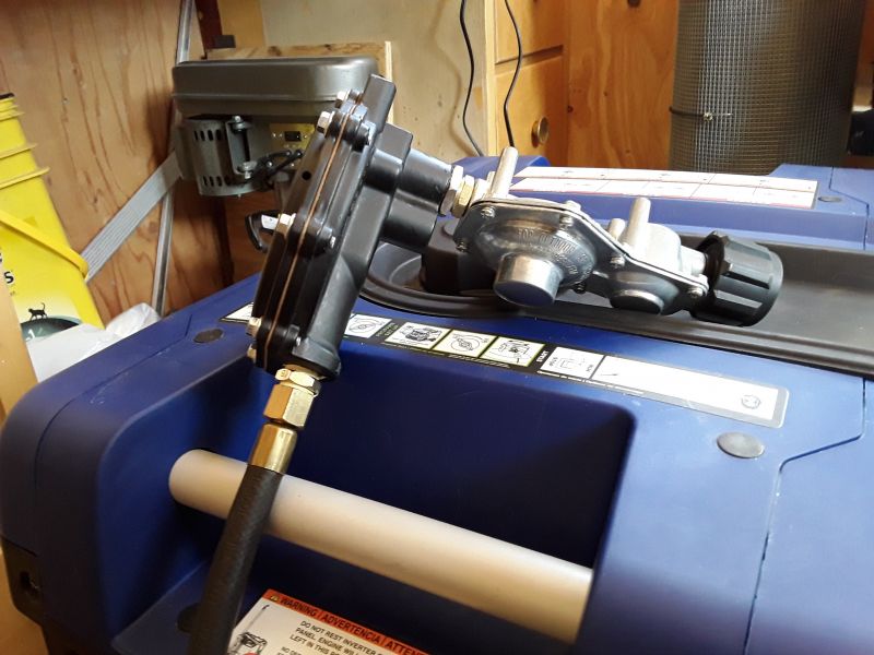

Sweet! The propane issue may just be what he had it hooked to. Just went through a tussle getting mine running because the pressure regulators have to be just right.
What are you going to use it for?
# Posted: 28 Oct 2022 04:18pm
Did the PO even turn the 'switch' from gas to LP?
Another issue can the OPD? safety lockout in the valve activating thinking there was a leak so he got no LP flow.
# Posted: 28 Oct 2022 04:42pm - Edited by: Nobadays
It came with a whole propane set up that I have to assume is made for it. But, my neighbor runs the same generator off his 250 gallon propane tank that feeds the house... it just has a 2 stage regulator at the tank. I think that black piece is designed to shut off fuel flow if it suspects a leak... Maybe what gcrank1 is refering to. I will strip it back to just the regulator and try it.

Running stuff you arent familiar with on a low 20# can be a problem at low temps, the vaporizing doesnt seem to work right.
Ime, having multiple regulators isnt a problem, each takes the pressure it is fed and ensures it doesnt exceed the reg's pressure setting. With a two-stage reg the 1st stage gets it close and the 2nd stage spot on, but is kind of a safety. If all you have is a single stage, like cheap gas grills, and that reg fails it may fail keeping gas from flowing or letting it through too high.
Something I saw online was someone who couldnt get the 20# cyl valve to flow so he hooked up to a 100#cyl with the old style valve; of course it worked.
There is all kinds of info online about how to 'clear and run' the safety valve.
Ive been studying up on the LP conversions as I have a rotten gas tank on an older construction type gen. The 'kits' are regulated just like a gas grill and the line goes to a needle valve to adjust the gas flow to the intake. Commercial setups must have a safety cut-off to stop gas flow if the engine doesnt start (think LP furnace in an RV).
If that adjustable needle valve is closed off the engine wont start on LP.
Dont know if there is a gas flow button on a safety valve like on an RV furnace, you hold those down for X time to get flow.
Should all be in the instructions that may have been misunderstood or ignored.

Still waiting on the new start module from Westinghouse. Since it only had 2hrs run time I decided to drain the oil... it hadn't been changed yet.... fresh oil and do a break-in run, even if starting at 2hrs. I needed to roast coffee and my roaster draws 1,600w but cycles on and off every so many minutes. I usually use a space heater and turn it on and off as I'm breaking in.
The issue.... while I had the generator side panels off a few days ago I installed the high altitude jet. We are at 9,500' so small engines tend to run pretty rich. The HA jet that came with it was for 5-7'000' . Figured I'd still run a bit rich but better than the sea level jet.
As I've been running it today I notice that when there us no load the engine surges, no horribly but very noticeable. Usually surging is associated with an engine running lean, not rich. I did not drain the fuel the PO had in it as he told me it was regular gas with stabilizer in it.
Maybe bad gas? (I know, drain it and try fresh) or is the jet too small? Or is the altitude probably the issue and be glad it runs!
Thanks!
# Posted: 2 Nov 2022 07:20pm
Easy enough to tell, put the choke on a bit, if the surging stops it's lean. Most of mine run a bit of choke until fully warm. If you think it's rich, take the air filter off and see if that helps.
# Posted: 2 Nov 2022 07:39pm
Good tips! I didn't know that! Just wish I didn't have to take the whole side off the generator to get to the choke and air filter! Automatic choke... sometimes new equipment!
I will try these... when my part comes in and I have to dismantle it for that. Thanks!
