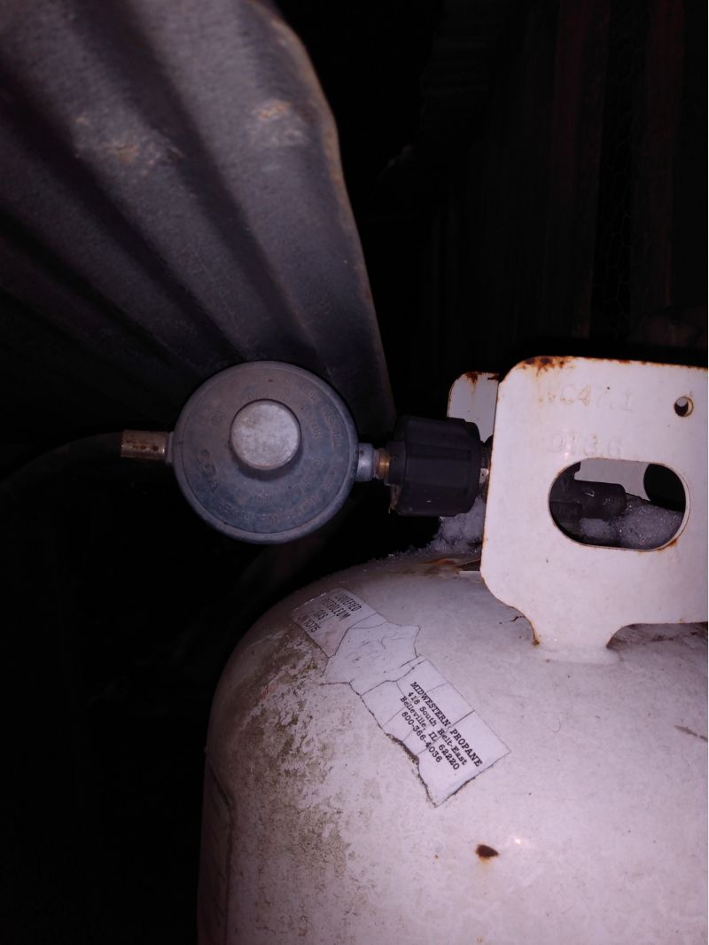

Don't know on LP. I've tried twice to stop a propane leak where the bottle adapter screws into the regulator. No love. Tried pipe dope first, then yellow Teflon tape. Still leaking.
Not too important to me but at some point I'll come up with another regulator and bottle adapter then try it.

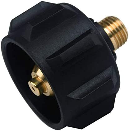

Bottle Adapter? Like for a 1# campstove cylinder?
# Posted: 13 Nov 2022 08:08pm
I don't know the correct name... the part that screws to the 25-30# tank. It's not leaking at the tank end but the other end of that brass that screws into the regulator. See picture
# Posted: 13 Nov 2022 08:56pm
is that a flared fitting where its leaking?
# Posted: 13 Nov 2022 09:18pm - Edited by: gcrank1
Typical regulator is just pipe? threads, the male end of that tank fitting screws into it, dope or tape should have worked unless maybe a crack?
Are you sure it isnt leaking at the tank end and backing the gas out the tale end of the plastic around the brass tube?
I have collected a few of those regulators and hoses off of scrapped out bbq grills at our town dump/'recycle center' I always carry a few wrenches to liberate stuff when the opportunity arises. The common reg's are all the same pressure and black plastic, if you see one that is red plastic it is a 'high-pressure' reg, dont use one of those to replace this one!

# Posted: 13 Nov 2022 10:54pm
Quoting: darz5150
No threaded
# Posted: 13 Nov 2022 11:13pm
Thats what I thought. But had to ask. Yours should be the same as mine I would think. But Ya never know.
Cranks right. Maybe a crack or something.
Pipe dope or tape can correct some crappy threads.
If you have another regulator, maybe give it a try. Or just re dope or tape what you have.

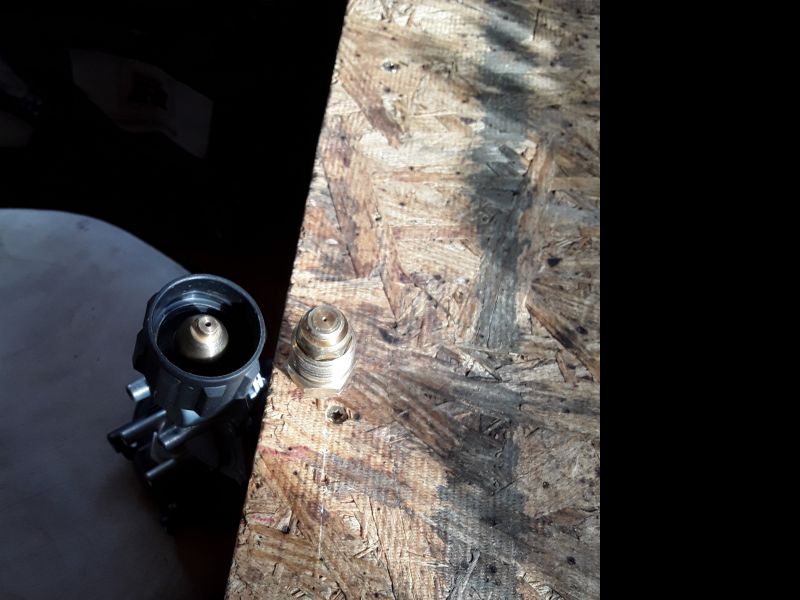

I'm going to search/ask around to see if I can get my hands on another regulator. I have another tank fitting, old style male lefthand thread, that I took off my fridge line because the nut doesn't turn without a wrench making it a bear to start...l might try that one.

Beware the old 'bullnose' POL fittings into the 'new' safety valves, or at least look it up.
Iirc the old bullnose can irreparably damage the valve.
# Posted: 14 Nov 2022 10:32am
This one has been used on a new valve for a couple of years. Just got tired of fighting it.
# Posted: 14 Nov 2022 01:33pm
Im trying to remember just what the issue is.....but I know I decided to only use the bullnose with the old style cylinders I still have, if at all.
Think it has something to do with that little cylindrical center part of the new fitting, it fits neatly into and depresses a valve in the safety valve. The old bullnose can damage that part that depresses?
# Posted: 14 Nov 2022 04:06pm
They are 2 different sizes where the end goes into the tank valve. Hmmm... didn't know that. Like I say it has worked with my tanks and two of the tanks I've used have brand new valves for recertification.
