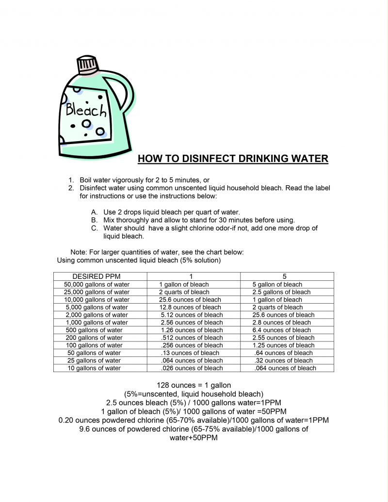

# Posted: 28 Feb 2023 06:59pm
The FDA web site also has a chart for putting bleach in water for potable water.
How ever if you start with a new barrel and shock the complete system (with bleach) then dump it and fill with a proper filter it should be totally fine.

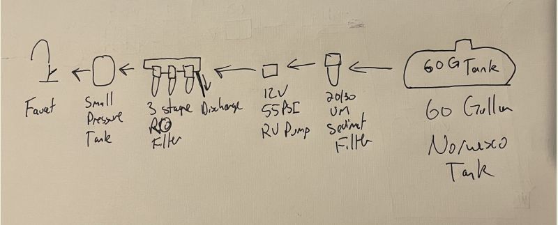

# Posted: 30 Jun 2023 10:09am
Update:
I will be installing water system this weekend

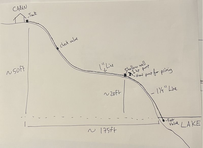

Diagram below of both the pump system and the treatment system. I spent some $$. Hope this will work. Thoughts?
Pump system:
1hp shallow well jet pump. Will be placed about 20’ above lake surface on top of bluff. Water drawn up by 1 1/4” black poly line with foot valve. Will also install hand pump right next to it to draw up water for easier priming. Pump will then push water up another 25-30’ to cabin site through 1” black poly tubing. . Total run involved from pump to cabin is ~150ft. Because of this I have to put a joint in (tubing is 100’) I will joint with a check valve mid run just to keep as much water in the system as possible. This will run into a 60 gallon norwesco water tank.
Treatment system:
Tank feeds 20-30 micron sediment filter. After filter, 12v 55psi rv pump. Then 3stage reverse osmosis filter. This feeds pressure tank which then feeds the faucet.
I think the sediment filter should be before the rv pump… is this correct?
What do you think. Will this work? What do I need to adjust?
# Posted: 30 Jun 2023 10:56am
You didnt want to use something like a $130 submersible amazon well pump? No priming needed and you can even make the system self draining for those chilly nights.
I have a jet pump and they suck to prime..I couldn't imagine trying to prime 20' vertically of 1.25in line.
Grizzlyman
# Posted: 30 Jun 2023 02:27pm - Edited by: Grizzlyman
Submersible pump not really an option due to location.water is 30’ deep near shore- and shoreline is a bluff. Would need to suspend pump somehow in water- doable I’m sure but seems like extra complication- Also max lift is limited on many submersibles.
Understand pump priming issues…
Also 60 gallon tank should hold enough water for 2 months or more- so should only need to pump a handful of times every year.
# Posted: 30 Jun 2023 08:29pm
Jet pumps are a pain to prime. I even have a 3/4in port to fill mine with and ended up re working the system so water pressure is at the same level as my pump inlet.
Sumbmersable well pumps do have a limit on how much head pressure they can pump but even the smallest 120v 1/2hp pump will pump wall beyond your needs

On the RV pump side, consider adding a switch to it, so you can have it off when you're gone, then no chance of flooding your house or running your system dry or burning up your pump. RV pumps are self priming, so if you make it easy to disconnect on the water supply side, it will be easy to run a little RV antifreeze through if you're concerned about freezing. Even if you don't put antifreeze through, it's easy enough to run most of the water out of the line once it's disconnected from the supply.
Grizzlyman
# Posted: 1 Jul 2023 12:06pm
offgrididaho
Thanks. Good idea. I have the whole system on a disconnect at the battery, so when we’re gone we disconnect it… I’ll have to work the RV pump into that too.
# Posted: 3 Jul 2023 12:09pm
Be prepared for a water drain down in your absence?
Seems everything I have with a longish line is like starting from scratch every visit....

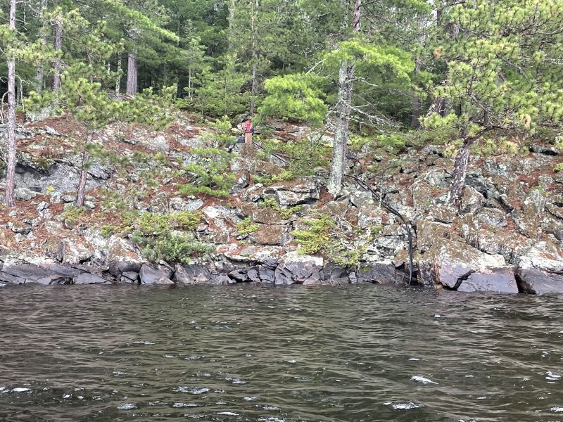

# Posted: 8 Jul 2023 12:50pm - Edited by: Grizzlyman

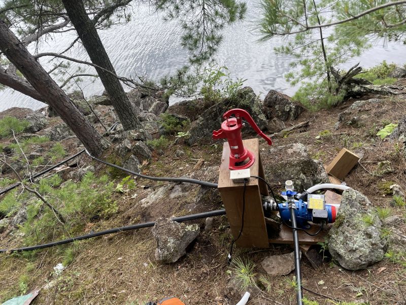

Update. I’ll get pics next weekend. Installed system this week. Filtration system works great. Drank lake water all week. Reverse osmosis produces crystal clear delicious drinking water- and the water out of the lake is so good!
Pump setup worked well- moved the pump site a little from my original plan and was able to find a ledge on the bluff face that can be easily accessed so I have only about 15’ of suction lift.
I installed a pitcher hand pump right next to my jet pump. I ran two water lines into the lake- one for my hand pump and one for my jet pump. I zip tied the 1 1/4” lines together and also zip tied them to to a piece of 8’ steel scrap conduit to keep them straight, keep them sunken, and keep them extended out into the lake instead of curling back toward shore. The lines are then pipe strapped to a few supporting pieces of lumber wedged between rocks on the the way down. It’s very secure.
Priming not an issue-took only a few minutes, and foot valves should hold water in the lines for next time. The pitcher pump works awesome for filling the jet pipe/priming. I fashioned a tube to fit over the pitcher pump so that it can be run directly into the jet pump for priming. No pouring required… and not a tight fit so no pressure issues when priming. Instead of a priming plug I installed a pvc ball valve than can be opened easily to prime.
So for priming I open the ball valve, insert tube connected to pitcher pump, hand pump water to fill pump/pipe and then remove tube and close ball valve.
I unfortunately did run into an issue with the pump and my generator. I mistakenly looked at the 220v amperage instead of the 110 amperage on the pump- dumb mistake to make. At 110v the pump needs more amperage than my generator can produce. It was able to lift the water the 15’ and the pump was able to get the water to about 35’ of the necessary 50’ for my tank until it had to start working harder and drew to much amperage for my generator to handle. Kept tripping… so no dice.
So it’s either a new pump or a new generator.
I will replace the 1hp pump with a 3/4 hp pump and a different brand that draws only about 60% of the amperage of my current pump. It’s a $250 mistake… but it is what it is. I’ll sell the other pump so maybe I can at least make some back.
On the positive side, a much lower draw means I can run a longer extension cord down to the pump site and not have to move the generator as much.
We tested the filtration system by hauling up lake water in 5gallon bottles just to make sure the filtration system worked.
Rv pump worked well enough and quiet enough that’s it’s barely noticeable inside the cabin.
My other “concern” is that the reverse osmosis system does create a lot of waste water. I knew it would, but it’s about 1:3-4 drinkable to waste water… this means I’ll have to fill the tank more often, but should only be once every 2-3 weekends or so… I had originally planned on only pumping a couple of times a year… but not a bad price to pay all things considered. Pumping should be relatively easy and take about 25 minutes to fill tank based on my calcs. Also means the rv pump will run more- but for the quality of water it produces it is ok. We’ll see how it holds up.
I also did put relief valves in place in my system so easy drainage when winter comes. Everything should be easy to drain except the foot valves.. that’ll have to be removed but no big deal as I have to pull the lines out of the water anyways.
I’ll update again when I have the 3/4 pump installed next weekend and can actually put the entire system to use.
Grizzlyman
# Posted: 16 Jul 2023 08:51pm - Edited by: Grizzlyman

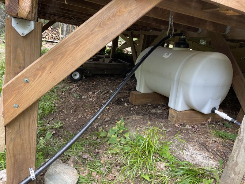

Installed new pump this weekend. 3/4 hp pump works great and actually pumped way faster than I thought. Somewhere around 10 gallons a minute. I filled the 65 gallon tank in ~5 min!
I did move the lines slightly so one is a bit short. I’m going to splice it next time around but no big deal.
Everything works great and am making water. Few pics below of the pump site and water setup.
