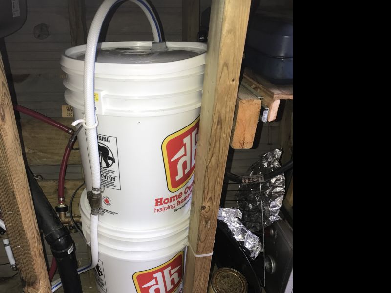

As mentioned, just buy the filters and DIY with buckets (food safe). The more filters the faster the flow (we use four).
We pump from the lake into a rain barrel every few days depending on use and chlorinate in the barrel. An RV pump puts this through the cold line and through the hot water heater (eccotemp L5) for dishes, general washing and shower. I use micro switches on the taps to turn on the pump rather than just pressure sensor.
For the filter, a line runs to the top bucket with a shut off. Turn the cold tap on slightly (enough to start the pump but not actually open the tap) then open the valve to the bucket to fill it. Obviously, there are lots of ways to do this. The filtered water once it collects in the lower bucket is accessed by a foot pump to a separate faucet for drinking (I think is is a Whale marine pump). It all works well for our usage pattern. It does require you to keep track of the level of drinking water as it will take a while to start to refill if the top and bottom is empty but with four filters, it is not too bad. Given the water is chlorinated, the filters are a safety thing plus they clean up the taste and anything that is not impacted by chlorine. This has been our system for 6 or 7 years.

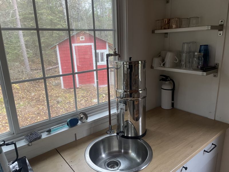

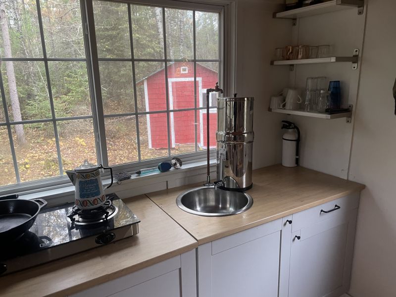

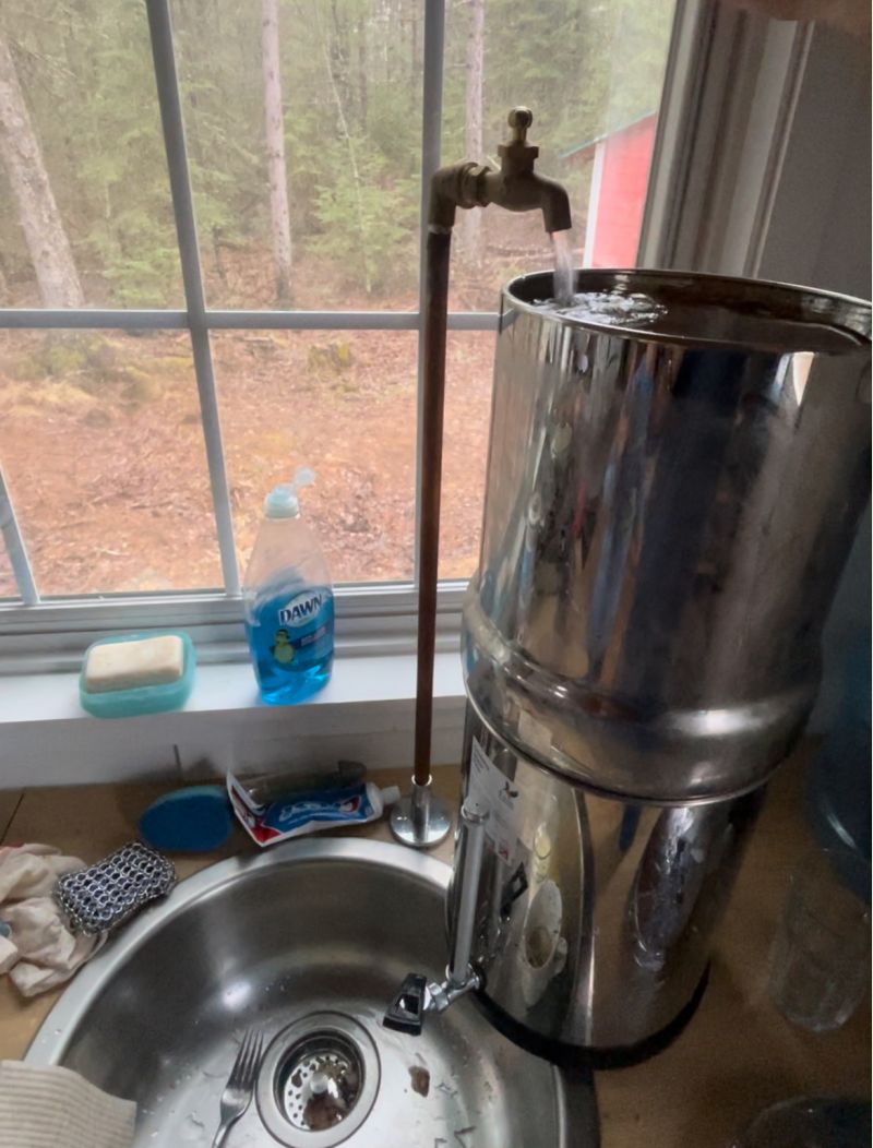

We decided on the “berkey” style filter. I actually went with Doulton over berkey. For price reasons and functionality reasons. I guess at the end of the day the filters are more or less interchangeable but doulton specifically has the ultrasterasyl ceramic filters that will filter out pretty much everything…. And half the price of the berkey. I bought the 3+ gallon system. 4 filters for max flow. Also, not that it matters- but the history of doulton is kind of cool.
We’ve used it last 2 weekends with a lot of success. It worked great for us. I had winterized our system so I just carried up lake water and dumped in.
I did plumb it so that the pump simply just directly refills the top canister via a copper pipe.
I think a spigot on a copper pipe is a cool way to do this… and the spigot can also be used to fill cleaning or other water use. . We’ll see. Happy with the system for now. Here’s what it looks like.

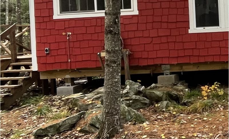

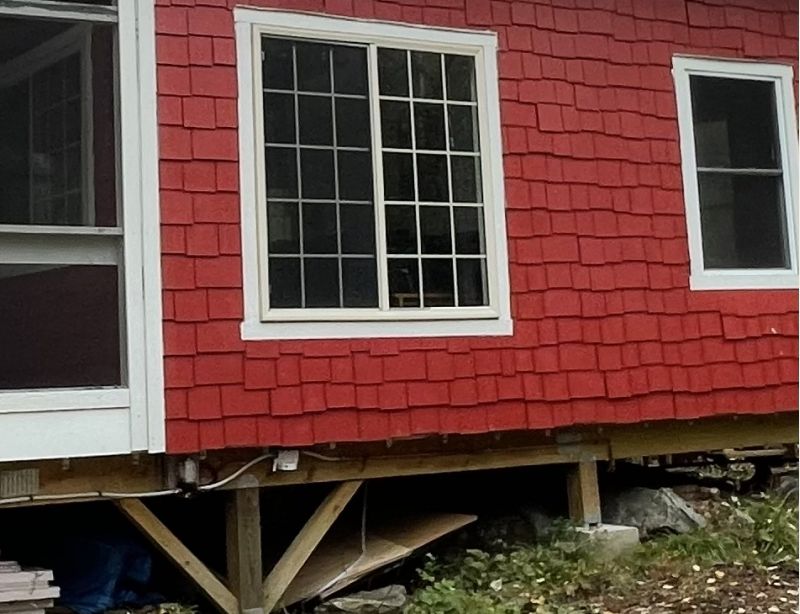

Thought I’d post another update. We opened up the cabin this weekend. It’s cold, but no more freezing in sight. MAYBE it might dip below 32 but not much and not for long so should be fine. We’re out of the woods as they say.
Last fall I had soldered copper exterior lines under the cabin and along the beams as well as replacing all the vinyl tubing with braided tubing where tubing was necessary…but I hadn’t used them since this was all done after freeze in the fall.
So I put the water lines back in the lake, reattached foot valves, reprimed the lines and the jet pump fired right up. Filled up the 60 gallon tank in just a few minutes at the top of the bluff. I reattached everything else with the shur-Flo pump and pre-filter and flipped on the Rv pump.
It Ran for a few seconds as it pumped the water out of the tank and pressurized the lines.. then stopped just like it should.
I went in the cabin and opened up the spigot and the rv pump kicked in and ran and delivered a nice flow to fill the filter reservoir. Closed the spigot and then pump stopped. Awesome. This is the way it was supposed to work. We used about 10 gallons this weekend and without the r/o system and no waste water we still have 50 left. I won’t have to pump from the lake very often at all- maybe once a month.
I won’t be trying my 14 galllon pressure tank back in the line here as there’s no point. The rv pump runs for so little it won’t draw much power. The cycling it was always doing previously was due to the r/o system and the pressure tank. This works much better. And the fact that it wasn’t running at all when spigot was closed means we have no leaks.
I did plumb a hose spigot on the outside of the cabin so I can get exterior water as needed as well.
I’m happy with it and this should be a permanent solution!
Exterior pics are of the system- shur-Flo pump, coarse 15 micron filter, and copper I ran along the beam and underneath the Cabin to the other side. You can also see the exterior spigot. The pics aren’t the best but they’re what I have.
