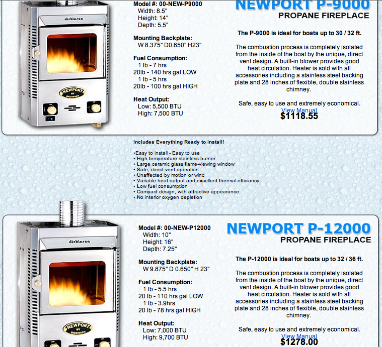

DICKINSON, DICKINSON, DICKINSON!
They make a 9,000 btu and 12,000 btu model. It is an open propane fireplace, fully vented. Not only does it serve as a great heat source, that is vented, but it also acts as a nice little fireplace.

how much propane do those Dickinson stoves use, and are they fuelled by a bottle outside the cabin/house?
edit: all good found it on this page http://www.dickinsonmarine.com/propane.php

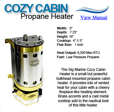

I'm on the lookout for a small vented heater for my showerhouse. I tried the Big Buddy heater, but when it gets steamy the O2 sensor shuts the heater off. So I guess I need one that uses outside air.
Here's a little VENTED heater (SIGMARINE) for about $450. It's small, 6500BTU good for warming a bedroom, or a very small cabin. Looks kinda cool, and you can put a small kettle or warm a coffeecup on the top.
This one looks kinda valuable, and I don't want to entice someone breaking in to steal it. Probably should choose a heater that looks like it's not worth tearing out, or small enough that it can be hidden inside the wall. Sig Marine vented 6500 BTU propane heater

here's pics of small vented heaters, gathered for the forum:

SigMarine, 6500 BTU vented heater , about $450? No power req'd. Dimensions: 8 x 16 x 7.25
And there are the Dickinson Marine vented heaters. http://www.dickinsonmarine.com/propane.php Dickinson Marine vented heaters

James, do you know anything about current delivery times, PlatCat says "8 weeks" on their website. I may have to go for the SigMarine to have one for this winter season. I like the SigMarine too, but not as easy to "hide it" in the 6" wall, as the PlatCat. SigMarine is 6500BTU, uses no electricity, seems to be about the same cost.

As for my project,,,,, I have ordered a Dickinson P-9000, it's expected to arrive today.
