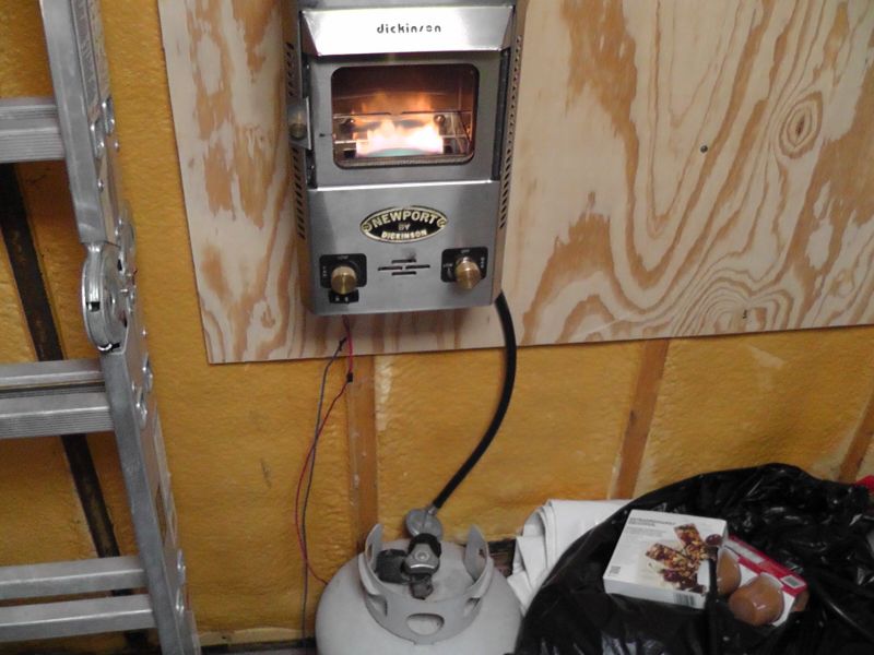

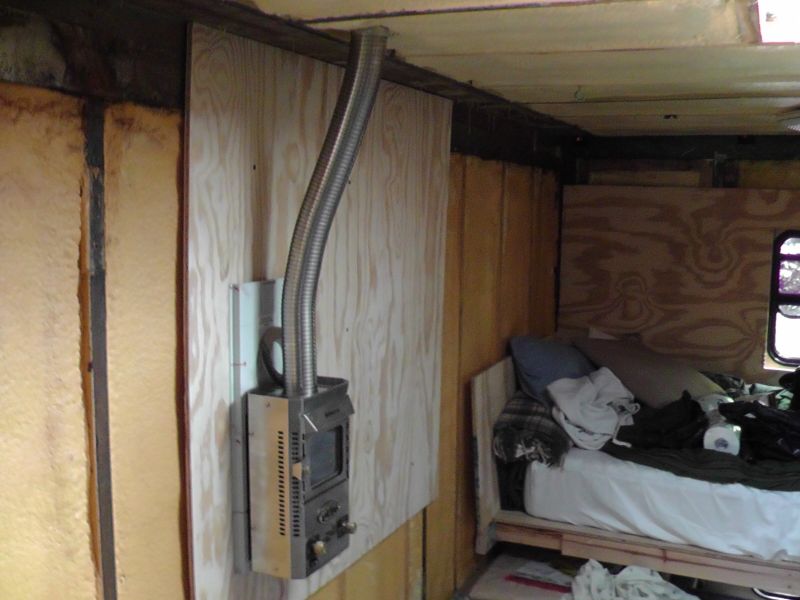

I decided to get the Dickinson marine heater Newport P-9000, because it will be inside my showerhouse. It was in-stock, and I'd miss this season if I waited 8 weeks for the PlatCat, a whole season of non-use.
I want the dry heat of a vented heater. It was spendy, much more than PlatCat, but would it "pay" to use a non-marine heater in the humid environment of a showerhouse? Also, the price includes the flue, which is a quality unit too. I'm trying hard to justify the expenditure, but this time I got what I paid for. Often things just cost more and somebody else "got what you paid for" or basically "got your $$". Not this time. Buying more quality than you need doesn't always make sense either but I am getting a lot of satisfaction for the moment.....we'll see how it goes in the long run. I could lose big if it gets stolen.

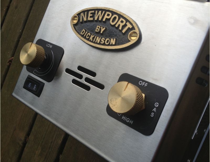

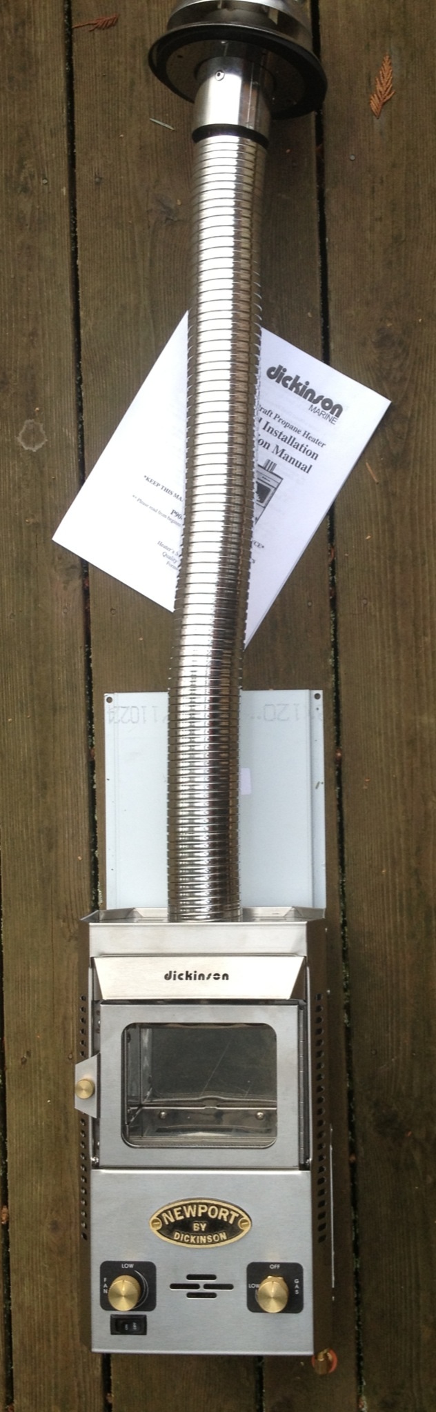

The P-9000 arrived, what a beautiful piece of equipment, very nicely made. The plate on the front is cast brass. The knobs are solid brass. And everything else is thick stainless steel, even the flue is thick, heavy, double stainless, flexible (but may take 3 men and a boy to bend it). It has a 2" flue inside the 3" fresh air inlet. And the 'cap' is heavy stainless, I've not seen anything built like this in years but I don't often see marine products, mostly because of the prices. It's made in Canada. I'm anxious to install it!
It has a fan, so it needs 12vDC. The fan motor is such low power consumption that you have to turn it on all the way and then reduce the speed, otherwise the motor won't start turning. It's the real deal, not dumbed down for the mass market.

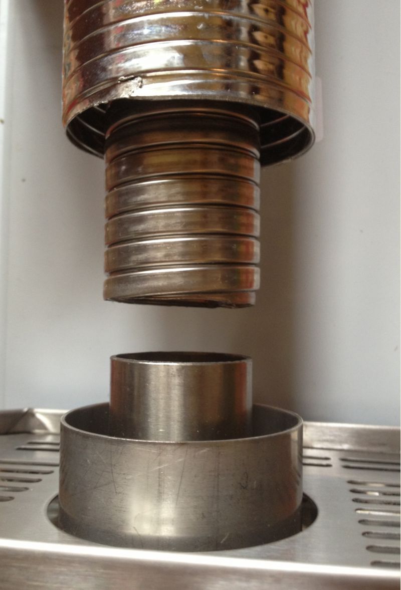

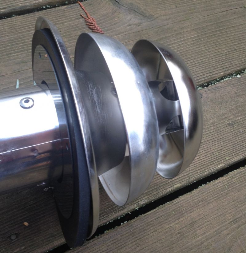

Other notable details: The max flue length is 56", less than 5 feet. You will have to exit the wall, can't get it above the roof. It is lit with an extended BBQ lighter, to ensure that the door is open while lighting. There is no sparker, you need a flame.
Note size compared to 8 1/2 x 11" user manual
The flue is heavy
The flue is heavy
The cap is heavy
The cap is heavy
Solid brass knobs etc
