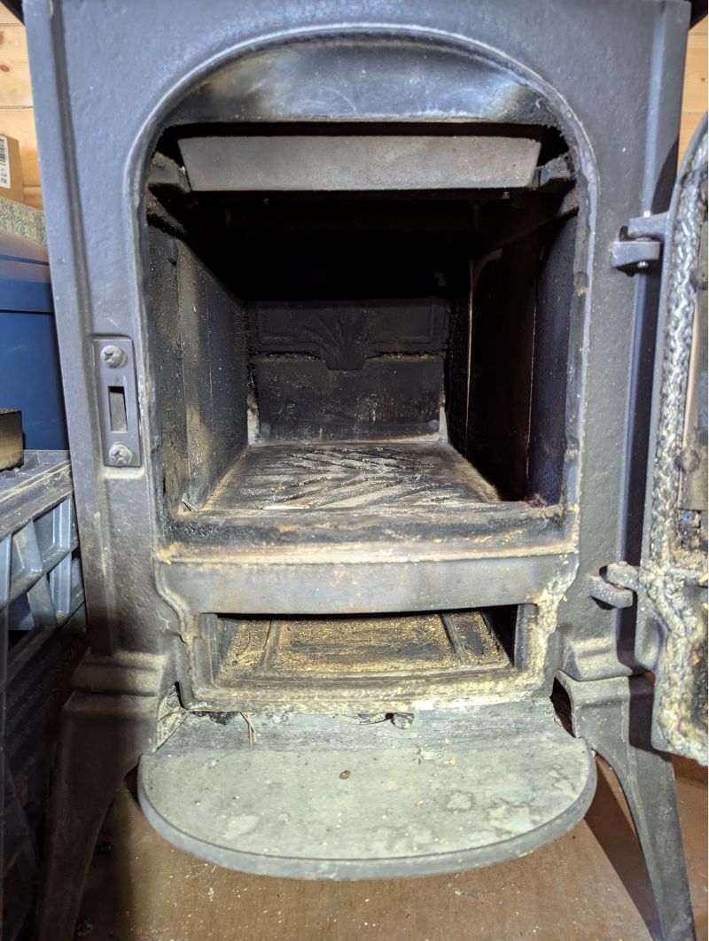

The cleaned, vacuumed stove...

If anyone has questions, or needs clarification, just ask
I had a helper to hold the bucket. I also have an idea for making a pair of small brackets the bucket could be clipped to.
Note: the black telescoping pipe was taken outside and laid on the ground. The brush was then run up and down the pipe while being rapidly spun by the drill motor. Then the chimney was reassembled.
First fire in the morning. Today I used some propane as well as some excess solar electric to operate a portable electric heater. .

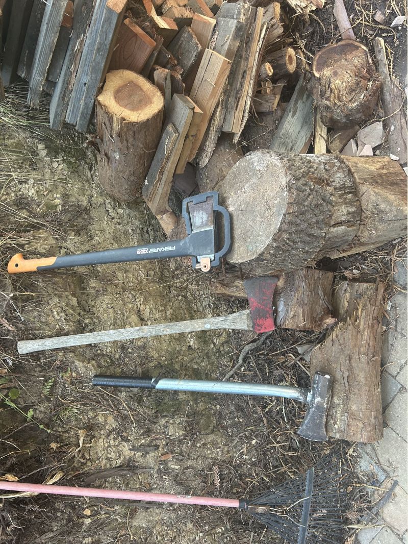

I can't swing an axe and take the impact anymore , that hand rig would work for me since we don't need to split much wood. I think I could figure out other uses for a horizontal press too
You can have this manual one, just stop by and grab it. In fact, you can have the gas one too if you bring a pintle hitch. Actually thought about taping my sawzall blade to that manual splitter lever. A USB powered splitter!
One thing I can still do pretty well, cause it takes little vision, hearing or brains, is swing an axe 360 degrees over the top of my head to split wood. Did hit my big toe the other day, that was painfull.

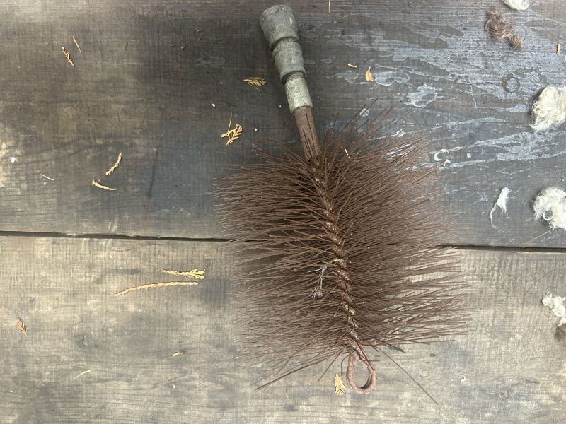

Good idea. I found a wire brush in my junk, rope and buckets I got. Warm or cold?

I vacuum the interior of it out once a year. There are air passages under the grate that allow air flow from the rear fresh air intake {with thermostatic control inlet}flap} to the front of the stove. The air comes out the front end of the grate to feed the fire from below.
Above the fire box there is a second passage which has the exhaust gases sweep through a secondary reburn chamber and back to the chimney exit collar. A strong industrial grade workshop vac can draw out the debris that could otherwise build up and perhaps slow the smoke draft.
If I do that I never have any draft issues and the thermo air inlet works pretty good.

Whew, done. 5 times on the friggin roof for various tools. Weight on the brush didn’t work, too much friction, brush must be for an 8” pipe. Had to do the pvc pipe trick, sure scrubbed it clean. Test fire burning..

For ash removal, yes, same. Ashes collect in the tray. There is a separate "passage" for combustion air from rear inlet to right up front. Ash can collect in there and slow the airflow. Not a big deal as once a year with a vacuum works for me. There is an plate that can be removed to expose the opening for brushing out but a screwdriver is required. A strong vac sucks the ash out fine, though. That passage delivers combustion air at the front so the logs can burn front to back. No burning, or not much at the rear end until the front has burned back.

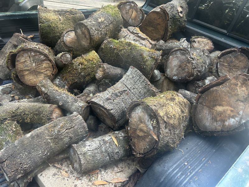

My neighbor is giving me a pile of cut, seasoned oak! Brought the first load up to the cabin yesterday, 2-3 more to follow. Wow, real honest to goodness firewood! Put a chunk in overnight, almost a square foot. Warm all night, surprisingly gone this morning.
Interestingly, he’s almost right across the street, other side of the road that forms the valley. But he has little redwoods, mostly oak. My place is 99% redwood, no oak. Should be a warm winter in the cabin, light redwood fire starter and oak after.
