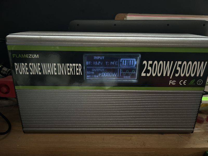

# Posted: 22 Oct 2023 07:00pm - Edited by: paulz
Quoting: Nobadays
you mean inverters..... yes and no. Cheaper ones, to my knowledge generally have no "Eco mode" as Victron calls it. What this does is if it detects no load it goes to standby, then every few seconds it wakes and looks if there is a load if not back to standby. Using far less power at idle.
The other consideration is size of inverter, the larger the more idle power consumed
Here’s mine. Cheapo EBay, some years old but does the job. No Eco switch, just off n on. ‘Flamezum’, what a name for electronics..
# Posted: 22 Oct 2023 07:56pm - Edited by: gcrank1
It could be that it will power the rated 2500W 'continuous' but Id doubt the 5000W 'peak'.
Ive come to think of the continuous rating as the peak on that class of import. Just me....cautious/skeptical.
Ymmv
# Posted: 22 Oct 2023 08:17pm - Edited by: Nobadays
Sweet! Keep an extinguisher handy!
I looked up the specs and it says .9A-2A per hour idle draw.
Edit... 12w - 24w per hour

# Posted: 22 Oct 2023 09:28pm
Quoting: Nobadays
It came with one..
It has a loudish fan that comes on only under a fair load (1000w+). TV won’t do it. It has powered down on clothes dryer start a couple times. I finally taped over the dryer door switch so I could give it an arm spin while starting.

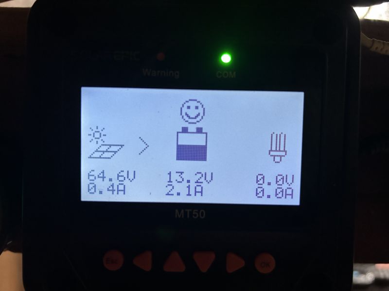

# Posted: 25 Oct 2023 06:25pm
Finally sinking in, this volts/amps relationship..
My solar readout says 64.6 volts and .4 amps, 26 watts for the array output (overcast today). Next to that is the output to the bank, 13.2 volts and 2.1 amps, 27 watts.
I knew the volts x amps = watts formula of course, just never dawned on me that if you had 12/120 fridge with the same motor (wattage), it take a lot more amps for 12v operation.
# Posted: 25 Oct 2023 06:57pm
I think what your MT50 shows is your mppt charge controller taking the excess voltage and using it to create more amperage for charging. That there is just magic!
# Posted: 25 Oct 2023 07:17pm
Yep, Paul, you got it now. Thats why so much of diy elec power is talked about in watts. Then you just divide by the volts of your bat-bank to figure the amps used and round up.

# Posted: 26 Oct 2023 09:58am
Quoting: Nobadays
Not magic..just Ohms law

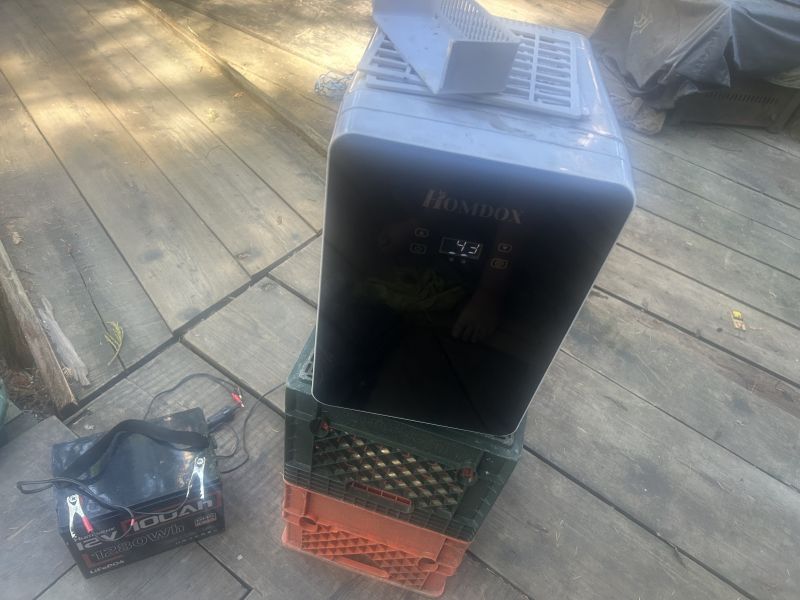

# Posted: 1 Nov 2023 12:36pm
Just read the thread on first frost. None here yet on west coast, saw a 39F briefly the other morning.
Been thinking about moving my 12v mini fridge outside. Usually a 25 degree difference between outside and what I have the wood stove putting out in the cabin. We only go in it about twice a day, and by the side door would be almost as close as now.
Probably cut down on my electric load some, so why not?
# Posted: 1 Nov 2023 12:41pm
Yes, it is the temp differential that the unit has to achieve; hotter it is the harder it works.
# Posted: 3 Nov 2023 10:38am
Thanks. Well I moved the little 12 volter outside two days ago. Ergonomically it’s fine, closer to the bbq in fact. Will it save much power? Hard to say with the varying solar power, use of other electrical things (Clint Eastwood night last night on TV), but it must be, 20-25 degree cooler in temp out there. So I’ll stick with it awhile longer. In the summer temps will be closer to equal. And when I do graduate to a larger LP unit, that will likely go outside too.
Here’s what I’m using. Friend gave it to me long ago.
https://img.saleyee.cn/Resources/GoodsAttachment//2021/202101/202101282127215709_988f 6568-6c38-46c9-8450-a30f21f22635.pdf
# Posted: 3 Nov 2023 12:05pm - Edited by: gcrank1
At our old off-grid cabin I had a small upright fridge with a dead compressor on the north side. Once we started getting pretty consistent temps under 40*f temps in the daytime the night temps were below freezing. I stuck a little thermometer in and when it seemed to stabilize about 36* we started using it as the fridge.
That worked until we got pretty cold and stuff started to ice up over night. Then we could put warm leftovers in for a while which would moderate the temp.
That gave us an easy to manage two shoulder seasons functional fridge without power at all.
