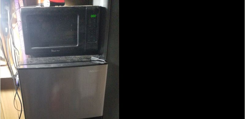

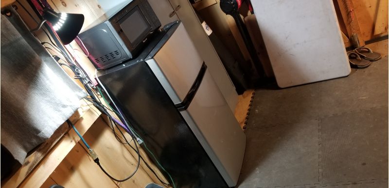

# Posted: 21 Oct 2023 09:44pm
There are actualy 4.3cuft fridges with separate freezers and thay dont cost a arm and leg. This is mine, the freezer holds 20lbs of ground beef but generaly my frozen water bottles from the cooler and icecream. I run it off 700w of shaded pannels (only get about 3hrs of sun a day) and 6 Gc2 batteries with plenty extra to charge phones, tool batteries and even microwave things.
https://www.bestbuy.com/site/insignia-4-3-cu-ft-mini-fridge-with-top-freezer-stainles s-steel/6173901.p?skuId=6173901&extStoreId=1028&ref=212&loc=1&gclid=CjwKCAjw7c2pBhAZE iwA88pOF1ms8ZcmV_CRRERJJBc9-akloLtQrEgwn7hyncf2rqg6n9kWweQyYBoCYIoQAvD_BwE&gclsrc=aw. ds

# Posted: 21 Oct 2023 11:36pm
Quoting: Brettny
Nice unit, about the size I need too, and cheap. Absorption I take it, but not a power hog at 1.5 amps, about what I use now.
# Posted: 21 Oct 2023 11:56pm
I believe it would be a compressor type. Guessing that because absorption types don't do very well above 95 F degrees and the specs say max temp of 110 F.
1.5 amps at 115 volts AC.
Looks nice. Good to have decent size freezer with separate door.
-Izzy
# Posted: 22 Oct 2023 07:22am
It's got a compressor. I picked it up for $20 off marketplace a few years ago.
