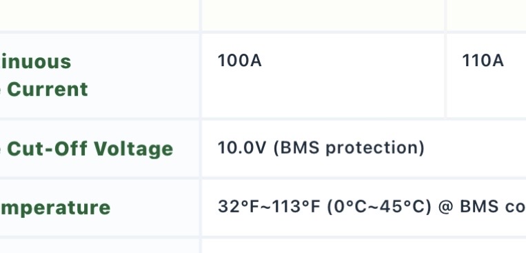

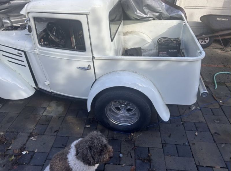

Specs for these Humseinks says 10 volt cutoff for BMS. Ive been playing with them since Christmas when they were $100 on sale and my old bank has kept on chugging. One is in my golf cart, one in my old hot rod.

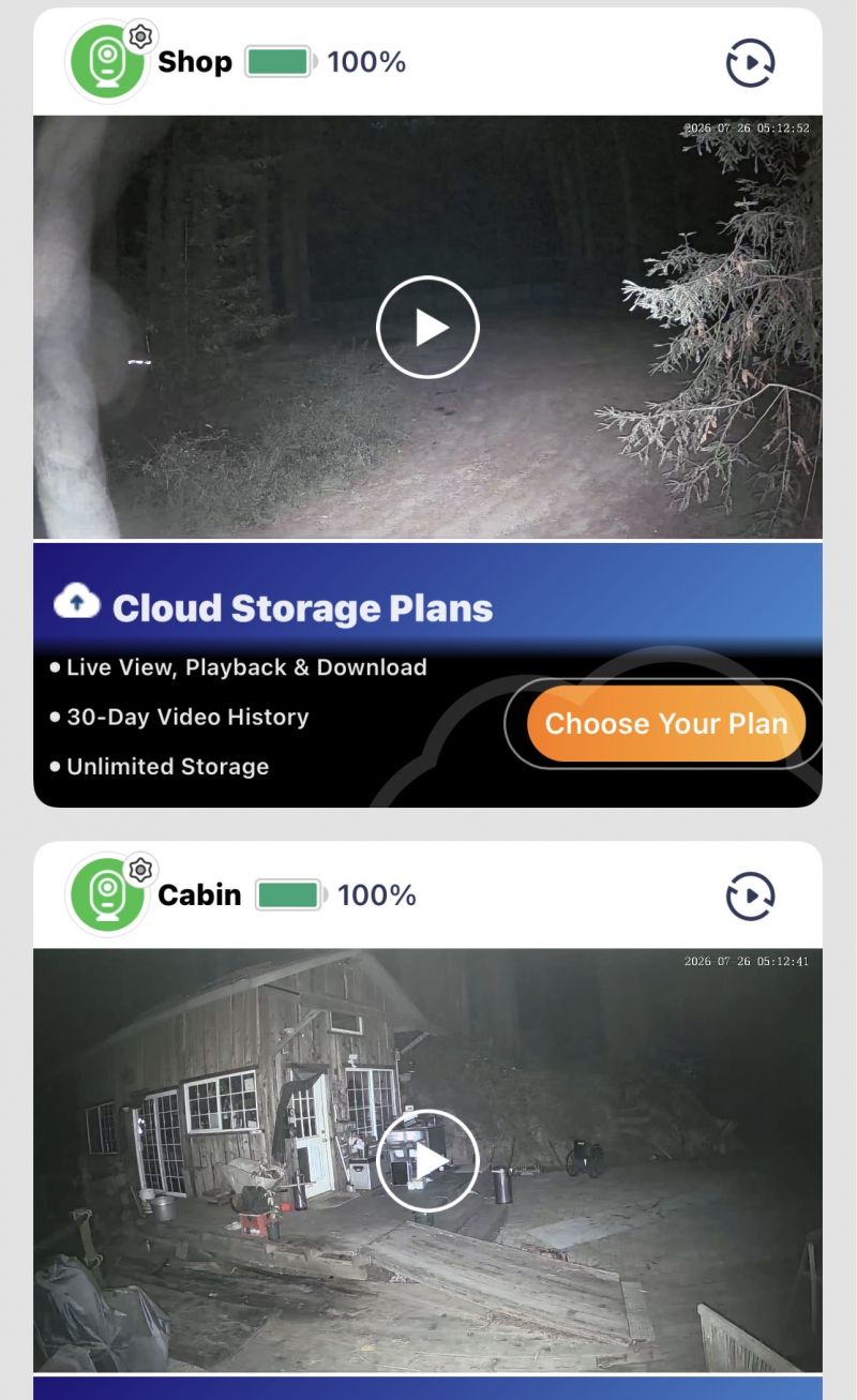

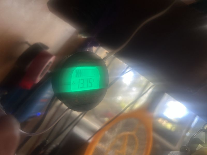

Dont know exactly when it died since I have to log into the cameras. Was Ok Sunday morning. I can easily check the amp draw with a dvm while here.
Battery still jumpered to the bank, sitting at 13.15 right now after a night of cabin draw. Sunny day today will bring it up to mid 13s by this evening.

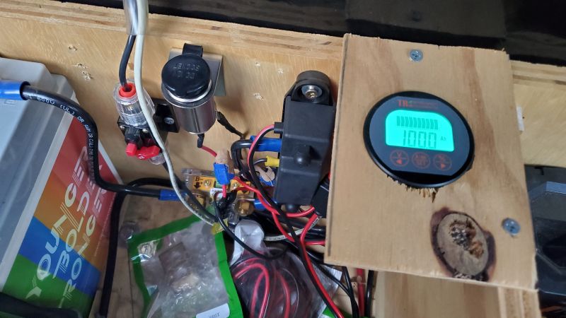

It's excellent to have, I've got it wired up so 100% of energy used flows through and every method of charging also flows through, solar or charger. It can display input or output as a percentage or in amps. Works like a gas Guage for the battery. You do need to calibrate it when you first install so it knows your battery bank capacity. It also indicates on the display if you are charging or discharging and I have tested charging while discharging at the same time, handles that fine.

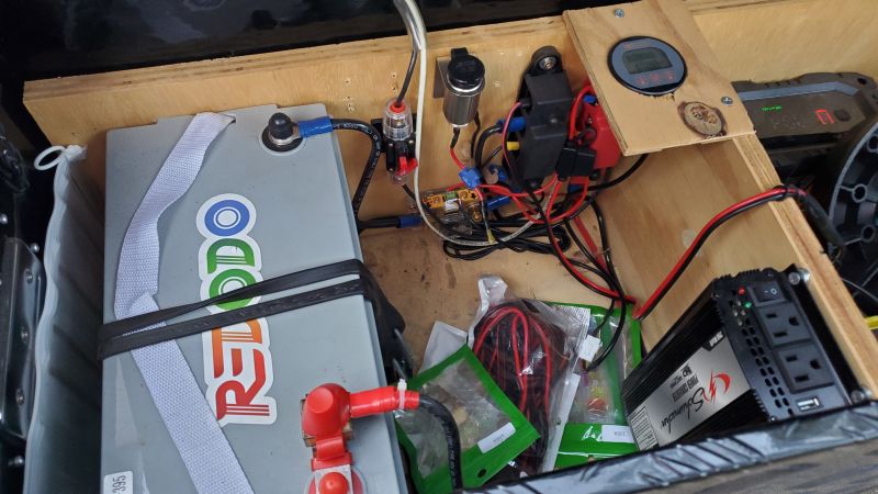

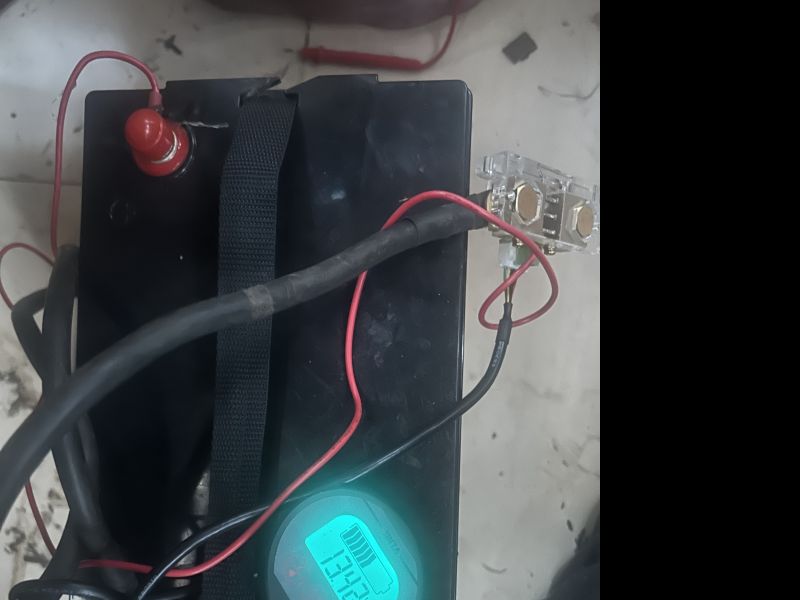

This is what I did with mine, tongue box on a tiny camper I built serves as the battery box. I know it's messy but there is order in there it wires to the negative.

Just grabbed a new dedicated charger for my battery. I had a portable charger strapped in the box but the display went out. This one should work well. Pretty sure they have it in 20 and 40 Amp variety. Fully automatic, about $50.

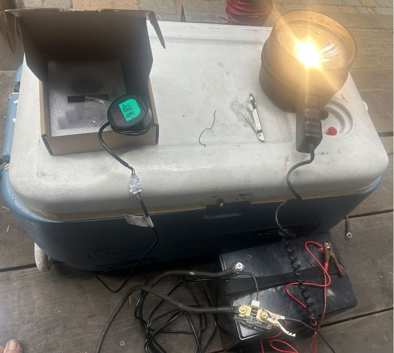

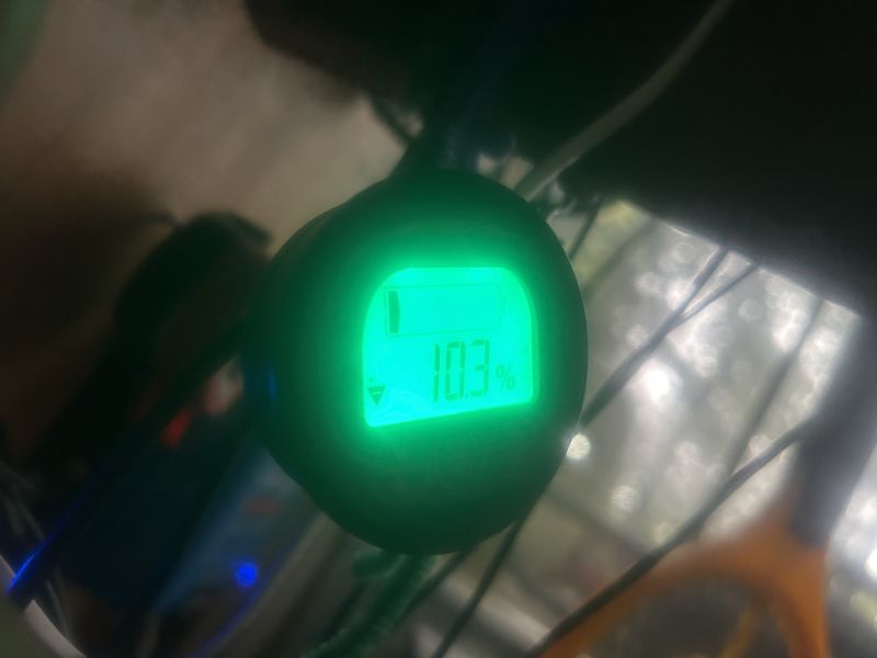

Ok shunt installed for testing. 6 amps for spot light, thats all I know so far just clipping it on. The back page of the instructions describes all the reading options. Have to cook dinner, all for today..
Edit: Reading instructions I have to set State pf Charge to 100%, meaning I need a full battery to do so. So I will charge one at 14.2v, see where that holds and set to 100%, I’m thinking. Do I have to do that every time I disconnect or switch batteries?

Hmmm. I've only used it for a single battery and only had to calibrate it once but if you move it between batteries then the state of charge, actual capacity, etc will be different so the Guage won't know the state of that battery and it won't be accurate. The values it has were calculated from use and charging of the other battery.

If they were the same capacity battery but you would still need to tell it the battery was charged because it was taken off of a depleted battery. It doesn't measure voltage to determine point of charge, you tell it the battery's capacity, say 100ah full. It measure amps out so 50ah out and it tells you the battery is 50% charged. Swap it to a full battery and it'll still read 50% charged. It never read 50ah going back in to the battery. Perfect for monitoring a bank. LiFePO4 batteries have a very flat voltage curve when discharging, an initial drop and then nearly flat to about 80% discharge so by the time you read a significant drop they are nearly depleted.

Took the battery back to the grid last weekend and charged it up to 14.2, which is why the display now shows half. Its been holding at 13.4 all week. Heading back to the house this weekend, ill hook it up to the wifi before leaving.

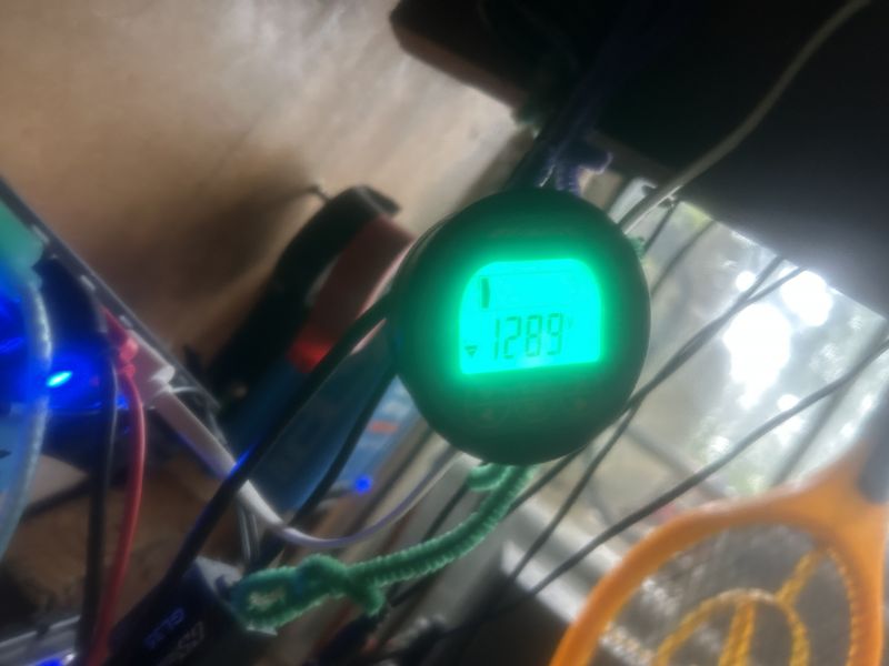

I found another of those shunt meters in my pile, dont remember how long ago I got it or if I actually knew what it was but I do remember removing it at some time. One end of the plastic is burned, got too much juice or shorted, but I put it back on my cabin bank and its working.
So we watched two games last night on the big TV and this morning bank was at 12.89! Yipes but the old Valence LFPs still going. Now, at 11am getting some solar but end of summer sun getting lower. Back up in the 13s but still only 10%.
