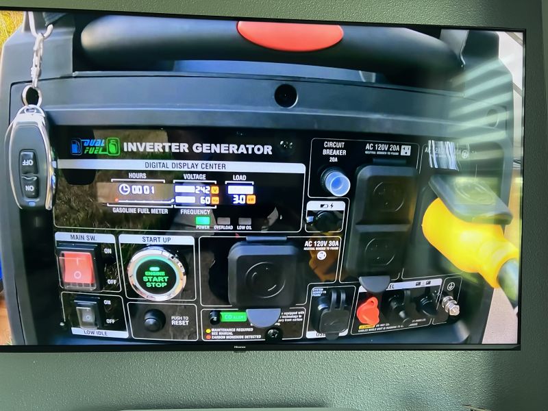

The actual 30A outlet says 120/240V
However, I just found a video review from "Gavins Garage" on Youtube
Here is a picture of the generator running - seems to show 242V when using the 120/240 outlet?
The guy was running his full AC in his RV
But it is the usual - seems "too good to be true" scenario - inverter, 120/240V, dual fuel, quiet, remote start, all for $800................worst case is to pay $109 for a total of 4 years warranty from Amazon

The unit you linked to is absolutely 240V, with a standard 240V receptacle. Its says 120/240 because that is how we supply power here in North America. It will be 240V across the hots, or 120V from one hot to one neutral. If your pump has that plug, just plug it in and it will work. Its worth a try for the price.
