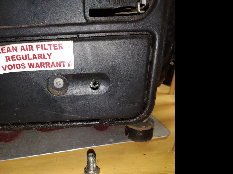

Here's a hack I've been using for years, for hard starting Genny's and motors.
I drill a one size smaller than 3/8 hole in the air cleaner box, as close to the air intake as possible. Then thread a short 3/8 bolt in the hole. This makes it easy to remove the bolt and squirt starter fluid in without taking the whole air cleaner assembly off. Now here's a kicker. It also works shooting propane from a torch in it.
Bolt/plug
Bolt/plug
Easy access squirt hole
# Posted: 1 Dec 2023 12:40pm - Edited by: gcrank1
I think you could use the same hole for a small hose nipple to make it run on LP (with the gasoline valve turned off). Once running and warmed up on LP it should start and run on gasoline pretty quick.
Cap the nipple off with a vacuum line cap from the auto parts store.
It would still serve as a starting fluid port too if needed.

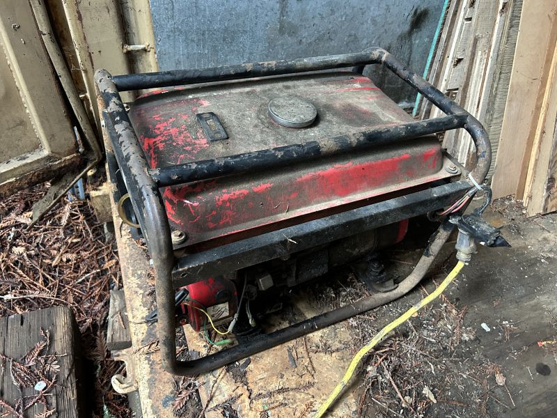

My regular genny wasn’t charging my bank the other evening. Went in the shed, here’s my original genny, over 20 years old, built my entire property with it, cabin, shop, car port… It’s beat to death, front panel long gone, air filter..
Fired up first pull! Charged my bank at 80 amps. Luckily circuit breaker had just tripped on new genny..

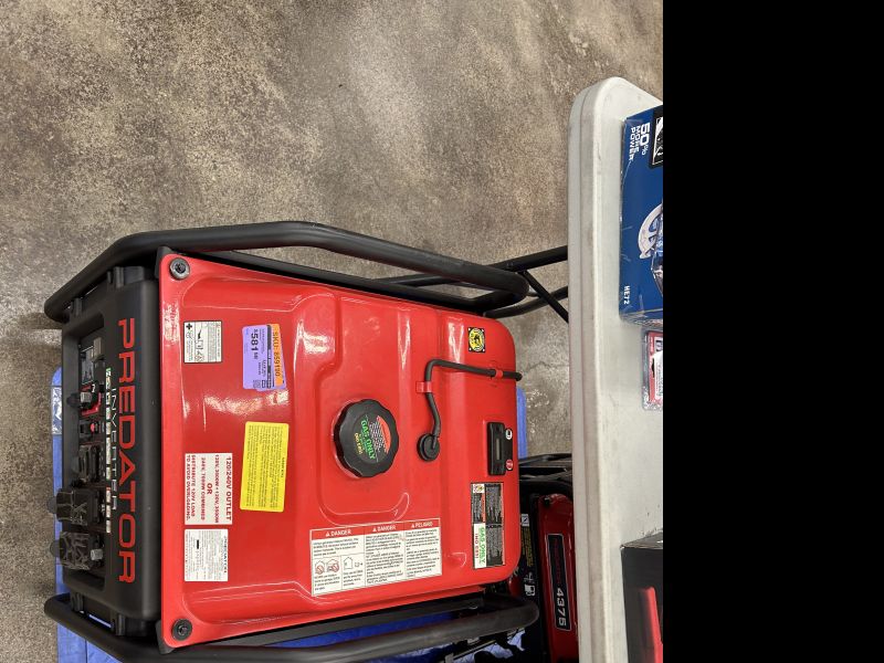

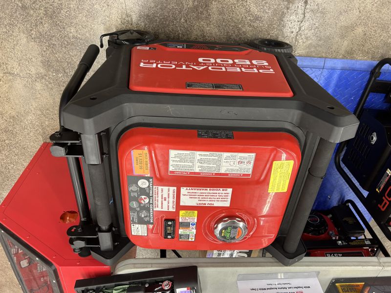

Couple open box deals at Harbor Freight today. The big one down from $2,300, other from 909. Last thing I need. I went for that LP refiller gizmo, out of stock!

I’ve been using my old genny pictured above, gotta be 20 years old. A friend says use an “inverter generator” for electronic stuff. Yeah the new ones say “inverter generator”..
What makes an inverter genny? Is my old thing a non?
