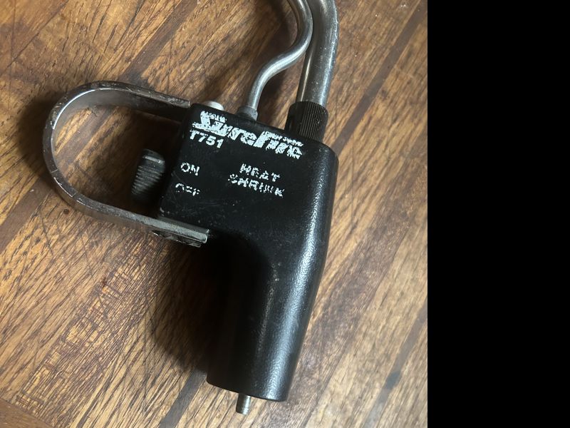

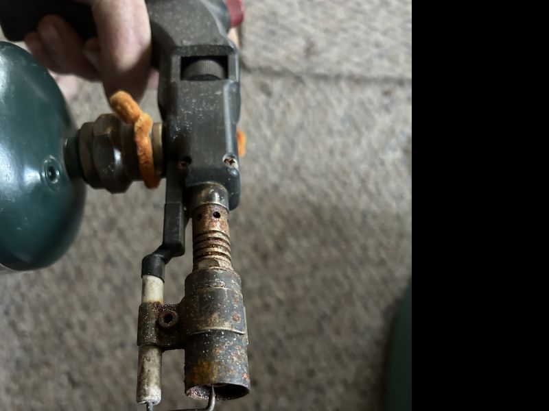

Like most of you I expect, I use a propane torch to start the fire. Sometimes, like this one, the piezo spark doesn't light it, even though I see a spark, and it works fine if lit with match. Is there a preferred gap, location, what's the trick?

# Posted: 16 Jan 2024 08:25pm
Spider nest?
what's the trick?
How about taking it apart and cleaning it?
# Posted: 17 Jan 2024 11:50am
I know it looks like hell, but it lights right up with another flame, and the piezo put as good a spark as others.

I have one just like yours, The only way it lights is turning on the gas at a very slow rate. It lights with a flame the size of a candle. too much gas pressure it just blows out.

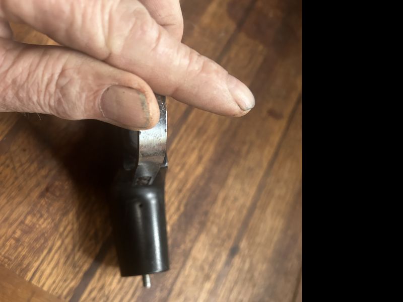

Right, that’s how mine lights when it does. I did improve it some by bending the tip up so the spark hits the top of the rim instead of the bottom.

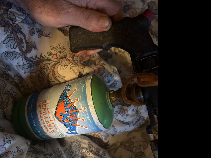

Then I just found this “refillable” cylinder in my junk. First one I’ve seen. Can I refill from a 5gal tank? How? It does have a screw on top of some sort.
Yes. They have all kinds of fill kits on Amazon.
That cylinder has a bleeder screw near the top I believe.
When you fill them, you have to turn your #20 tank upside down.
I've been filling the regular ones for years. They also have brass caps for them. I would suggest getting those too.

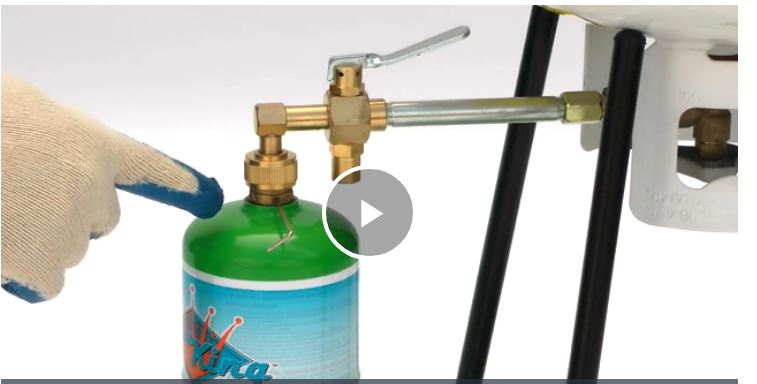

rom Harbor Freight
This one? So you can refill the standard non refill bottles too? I have 75 of those..
# Posted: 23 Jan 2024 09:40am
Yes
# Posted: 23 Jan 2024 09:56am
The bottle with the manual relief valve is the best one to use, the others have sunken valve that is hard to grab with a needle nose pliers. Wear Gloves!
If youve watched the guy refill 20# with the relief valve he waits until it spits to turn it off, then the refill hose. Same deal but smaller.
If you use the std toss bottles you wont get a full fill but will get enough to be useable for a good bit.
Btw, use a mostly full 20#er for best results.

Thanks. Still waiting for the adapter. But the HF one holds the bottle perpendicular instead of upright, like this. Guess I can tilt them some. I have one of these refillables, I'll try that first. On the Colemans, does that valve just push down like a tire valve or must it be unscrewed?

Just read some reviews on HF. Some say the 20# tanks don't work upside down? The OPD valve?
# Posted: 31 Jan 2024 02:42pm
They must. That's all I have. But like crank said. It works best with a mostly full tank. I think last time I did refills, I easily filled 8 small bottles.
Also, the way I fill them. I bleed everything out if the bottle with a wooden doll rod till it's empty. I weigh the bottle, then start filling. I leave it for a few minutes. Then take it off. Stand it upright, and then do a couple quick purges. Then repeat. Usually I do this a couple times till the bottle weighs out. It is possible to overfill, so if I do, I just purge it till it's between 15 and 16 ozs.

Played around with the bad piezo torch yesterday, not so much that I need it, more that I can’t figure it out. Gets a good spark but still won’t light the torch. I have a second identical torch that lights every time.
What I have tried:
1. Switching bottles with the good torch.
2. Adjusting spark gap and placement.
3. Sanding spark contacts.
4. Lighting torch with the other, lights right up and burns fine.
5. Adjusting propane knob, from nothin to wide open.
6. Holding fingers over holes in torch head.
Stumped..
