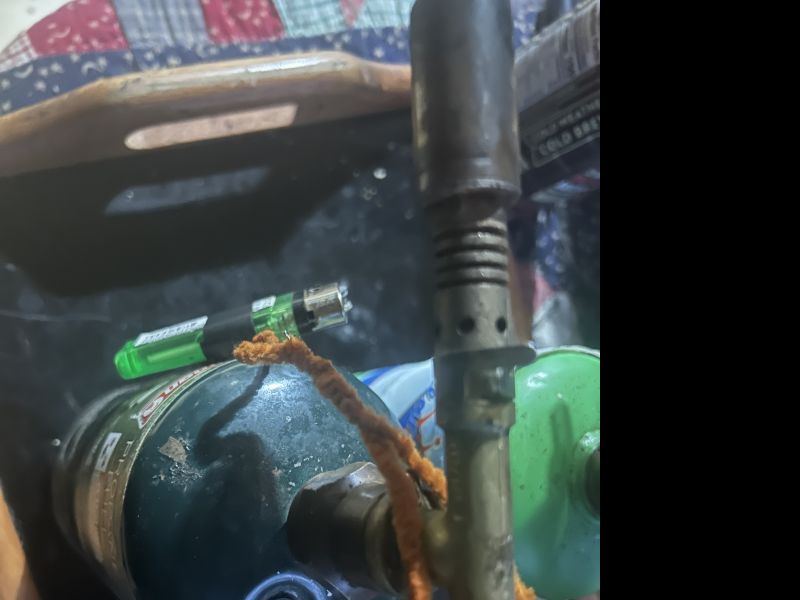

Got that right. Last night the dog woke up barking, heard something outside. After I gave him a kick, went to check the fire. I could smell LP, and when I lit the torch and held it at the fire, it started burning from the bleed hole I had earlier messed with! Well that’s the end of that bottle, and messing with the others.
On another note I spent yesterday morning playing with that piezo one last time, just because something that simple had me stumped. I have an identical unit for the city stove, same dang spark, same gap and location, starts every time at any trigger valve opening. So I took it apart, redid all the connections, switched bottles etc., still nothing. Finally gave up and installed a lighting mechanism that works every time.

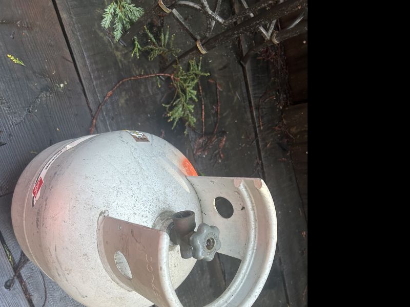

A friend who frequents the recycle yard gave me this LP tank, full! Went to hook up my genny, oops, no external threads. First one I’ve come across, old? Would it have an OPD valve?
# Posted: 22 Feb 2024 02:33pm
I wouldn't think so. But not positive.
That's one you take to the exchange place when it's empty, and get a new one.?
Or try to use it to refill the 1 #. If it works better, then I would keep the tank and have it refilled at your regular place. Either way, it's a win.
travellerw
# Posted: 22 Feb 2024 02:34pm

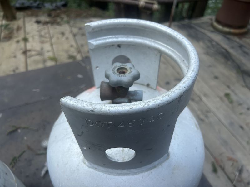

Typically, no external threads, no OPD. There are exceptions though in the early days. Usually, if it is an OPD valve it has that embossed on the valve control (the turny part that opens the propane).
# Posted: 22 Feb 2024 03:52pm

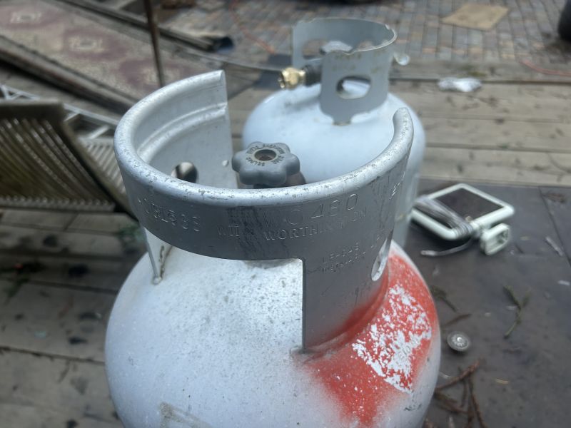

Those are the old style that Will Not give you trouble getting something running!

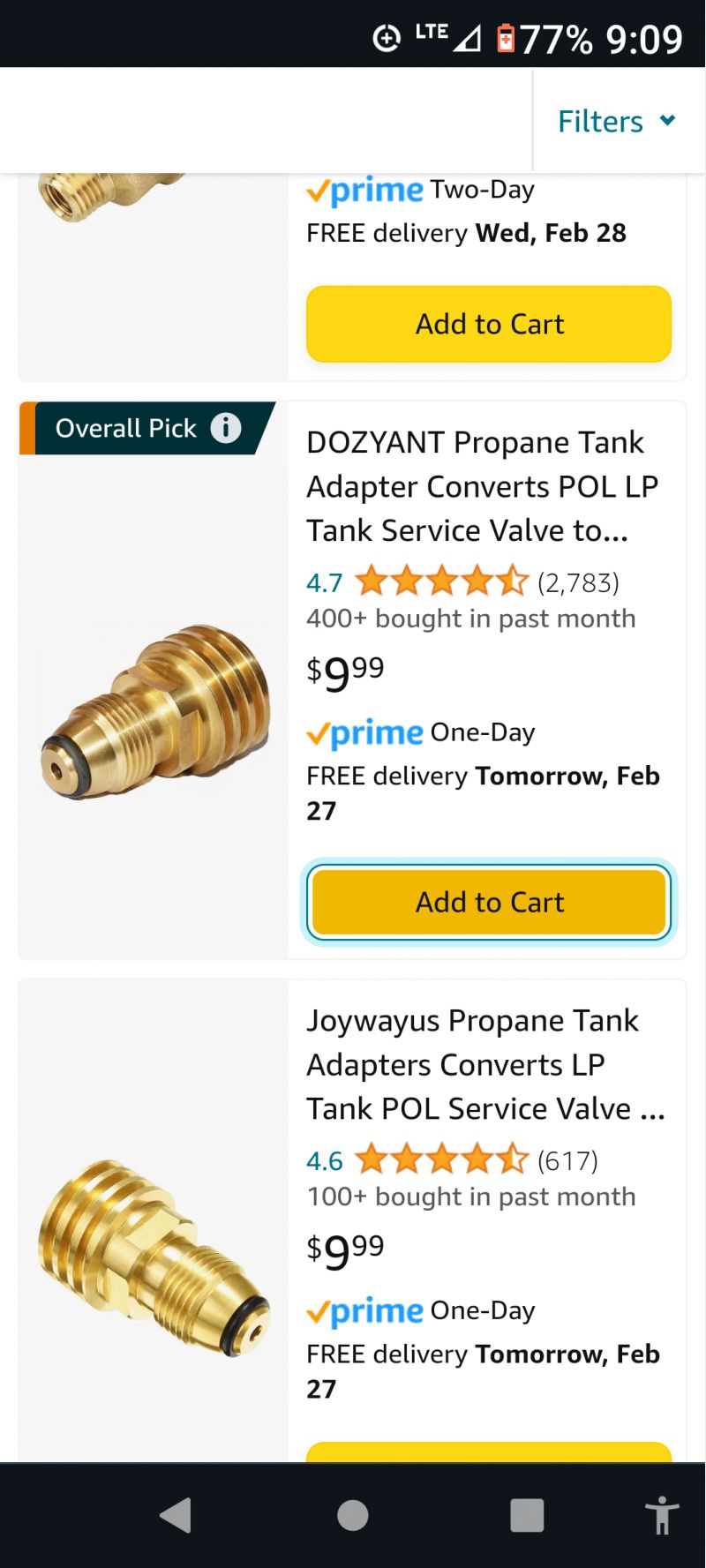

They do make adapters that screw in to make your big external thread fittings work. I am glad to have a couple of 30#ers and an adapter around.
Refillers aren't supposed to fill those without replacing the valve (but it has been done)

Don’t see anything about OPD. Can I unscrew the top?
# Posted: 26 Feb 2024 07:50pm
LP places have the right tools to change valves, might be worth the ask about how much and if that includes the recertification for refill.

If you just want external threads, you can buy an adaptor, for less than a new valve.

I have tanks with both type valves. It has been really handy to have the adapter for the old valve to be able to attach stuff with the big thread easy knob.
