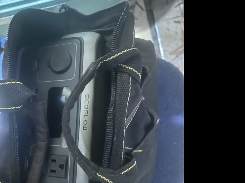

I found a hd 'tool bag' at the local resale shop that the EF fits nicely in c/w all the cords and booklet, an easy grab & go.

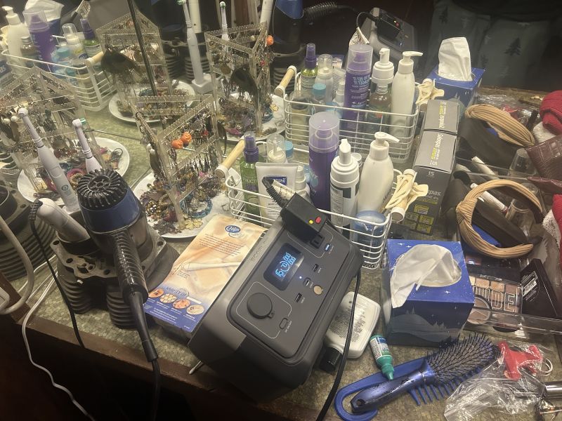

Back at the grid. Got the R2 unpacked. It will run her blow dryer, even the curling iron, on low. High kills it. So at least if I’m dead in the water, her hair will look proper.
Hardest part of the test was finding two square inches on her crap table. Makes my work bench look clean. BTW, notice her dryer/iron holder. Curtesy one of my old Triumphs.
# Posted: 22 Dec 2024 01:17pm
Nice (holder...)
Don't lose the rubber cap over the cig-plug!

Good idea you had about a zip bag to hold it in.
# Posted: 26 Dec 2024 02:42pm
As cheap as the bags are Im surprised the box doesn't come with one....
Paul, I have notes in the review about how to hook up an 'expansion battery' (that you have already), just takes an inexpensive cable from Amazon.
