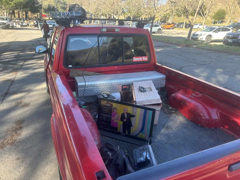

Ha, actually used it yesterday in earnest sort of. So I’m still playing around trying to get over the air TV at the cabin, which so far nothing due to either all the trees or the hills surrounding the valley I’m in. Yesterday I packed the test TV and antenna in the truck and drove a couple of miles to a nearby parking lot devoid of forest and nearby valley hills. The TV and antenna are both 110 AC but luckily I had the R2 along. Got 13 channels!
Tried it again back at the cabin, nothing. Still don’t know if it’s the trees or hills but at least the R2 worked perfectly!
So I can just plug the R2 in the cig lighter, truck off, to recharge?

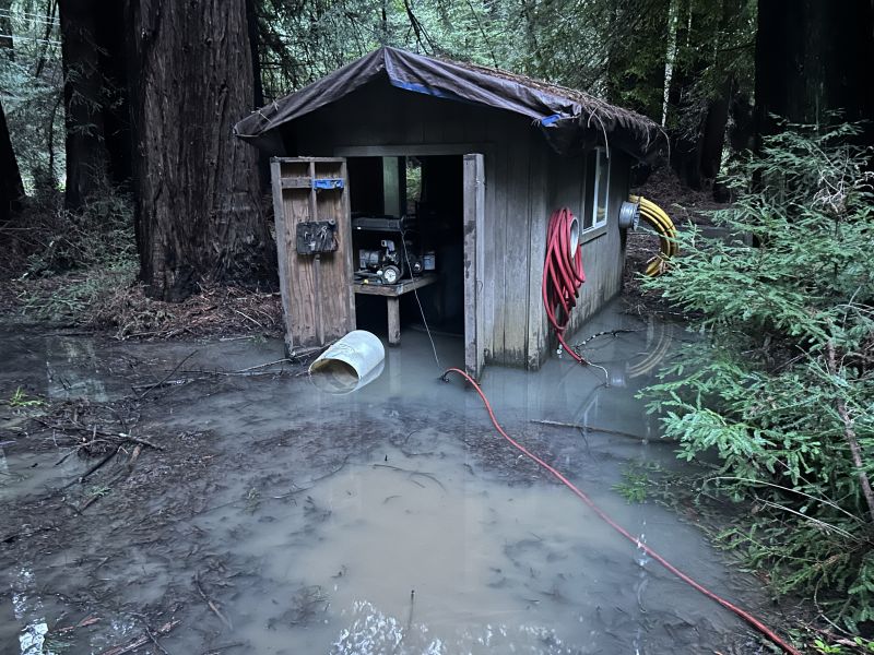

Darn. My well shack, which sits at the bottom of the hill, flooded. So late yesterday I figured to pump it out with the AC sump pump, perfect job for the R2. Stuck the pump in the low spot, plugged it in, nothing. Display read 0%, even though it’s just been sitting in the bag behind the truck seat. Maybe left it on, but it should have turned off with no use.
Silver lining: The well pump generator is right there on the bench. I didn’t plan to use it as it’s 220 volt and the last thing I need is to screw that up and have no cabin water. Alas, glancing at it revealed it also has 110 plugs, so what the heck, started it up. I ran it for about 45 minutes. Left the 220 well pump going too since cabin tank was about half down.
Don’t know if the R2 would even power the sump pump, and if so for how long. That will be one of todays experiments, assuming it charges back up.

Imo that would be a very short run for the R2's capacity.
I suspect you didn't turn the main power button off on R2, or quickly did and didn't verify shut down on the screen. I did that one time and it will drain the unit in its internal 'standby mode'
Maybe ya gotta do it once so's ya knows?
Good thing is it will charge up quick; you could have plugged it into the gen and be topped back up while the pump ran.

You must be correct, need to turn it off longer, not just hit the button. Charged right back up today. Didn’t try it on the sump pump, since the other genny is right there, and again like you say even if it did power it, wouldn’t be for long.

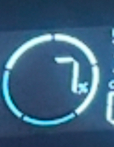

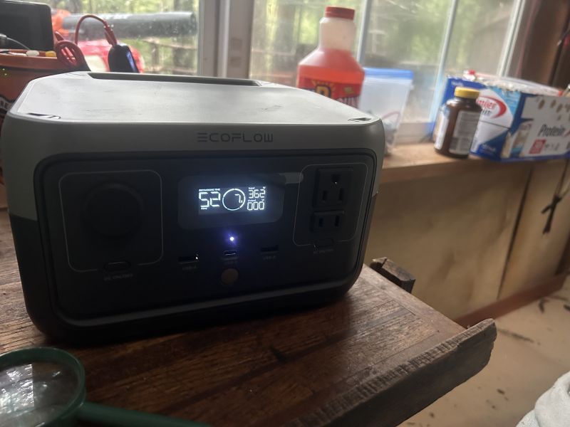

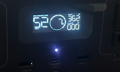

Found this photo I took when first plugged into the cabin inverter. I guess the ‘recharge time’ is the minutes it will take to finish, not how long it’s been. And the 7% is the amount it’s charged, even though the circle around that is about half lit. 362 w going in, that I get. Was the same when plugged into the truck lighter.
I have plans to try it again today on a TV, more to follow..

The circle is quick look charge level rather than a bar.
Yes, the min is time to go, it is close, not exact.
The 7% is charge level.
So lots of info right there for your pref of monitoring.
The 362w going in is what you will get off 120vac and that is why it recharges so fast on ac. When you cig-plug it that connection drops the amps load so you dont blow fuses/melt wires; so it charges lots lower and slower (iirc the cig-plug amps is in the manual).
Ok thanks. So the green 40% part of the circle represents the 7% of current level of charge, even though the 7 is in yellow?

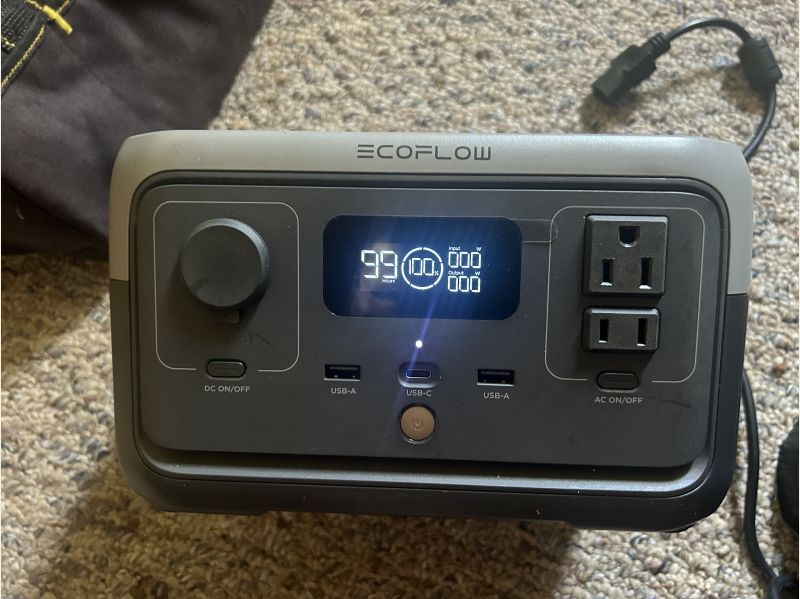

Haven’t dug up the book yet but I did plug it into the grid. Went up to 100 lights all white. I’ve read that leaving LFPs at 100% is not great, is this how you leave yours for long times?
# Posted: 21 Feb 2025 04:38pm
Yep, I think the bms maybe gives some headroom???
!00% and dont leave it on the charger, good to go whenever you need
