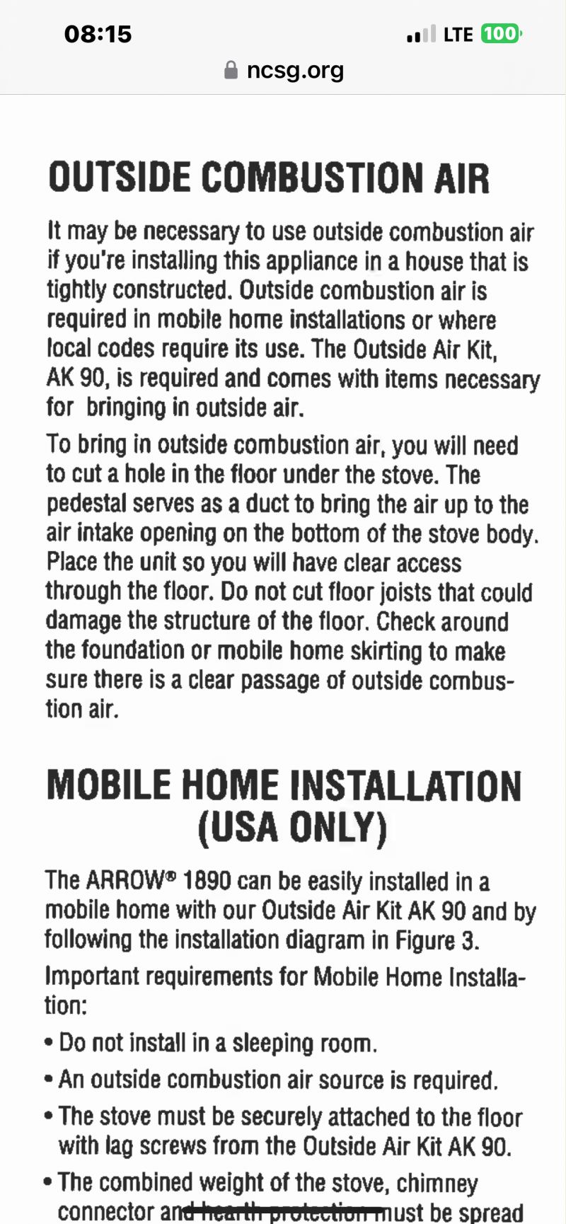

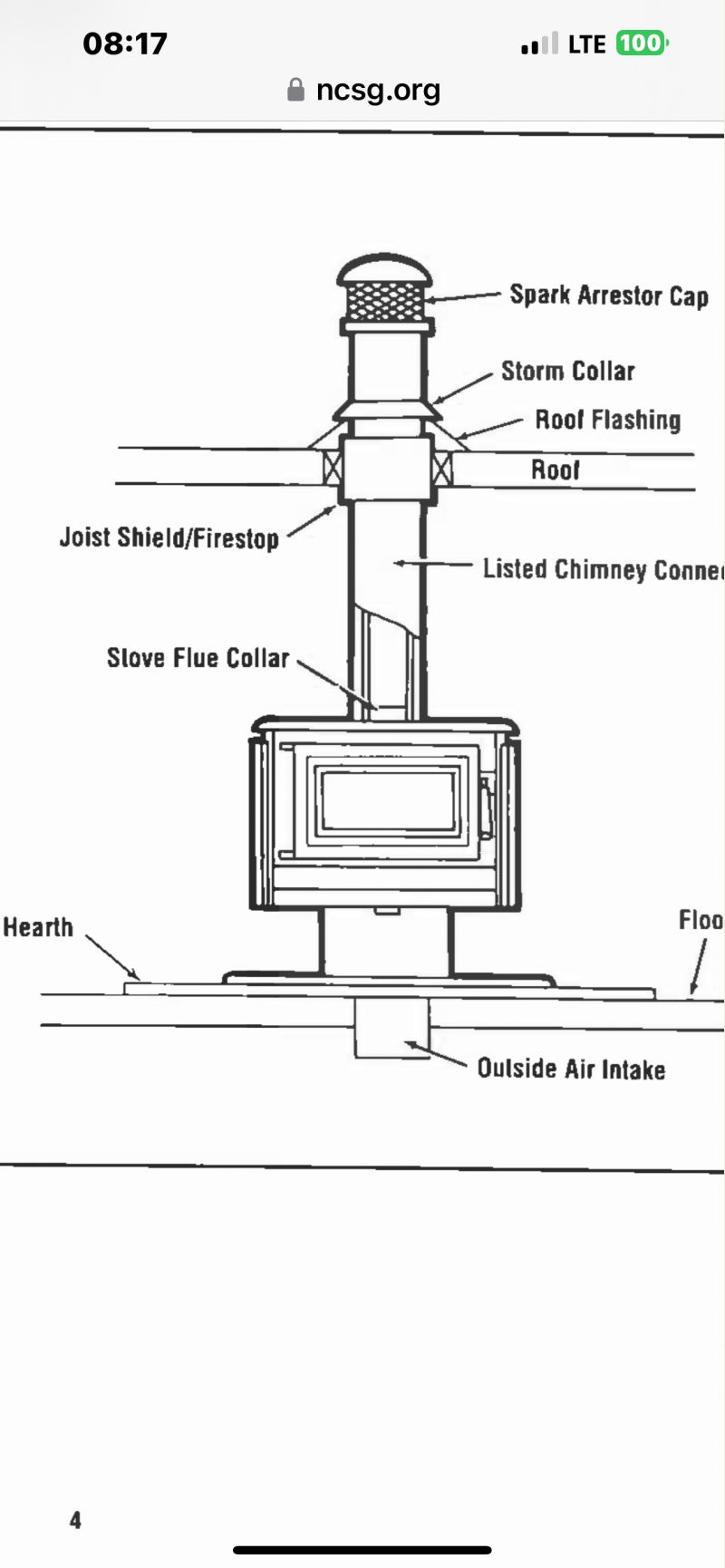

# Posted: 27 Oct 2024 03:37pm
Great, another thing to deal with.. years of using my old stove no problems, maybe I have enough outside air leaking in.
There is no hose fitting on my old Arrow. Looks like though, a hole can be cut in the floor and outside air comes in through the pedestal. The kit they mention, AK90, I think is this. There is already a fan in the stove, blows inside air around the chamber between the walls.
So to do it or just leave it be like it has been..

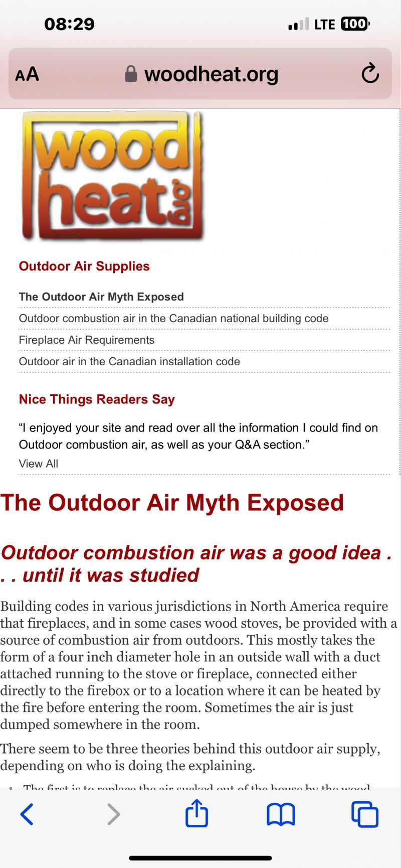

Did a quick search on “fireplace outside air” and this popped up first thing. No background with these people, haven’t read the entire article. I know you guys better..
https://www.woodheat.org/the-outdoor-air-myth-exposed.html
# Posted: 29 Oct 2024 04:02pm
Interesting
If I read it right the biggest cause of oxygen depletion is 'up the stack' with a stove that needs a stack, not from the 02 needed for combustion.
# Posted: 29 Oct 2024 06:04pm - Edited by: paulz
I tried to read that whole article but too many air pressure, temperature and height difference explanations for my weak brain.

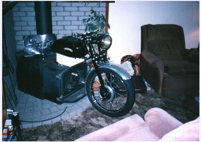

Here’s a photo of the first house I ever owned, 800 roaming square feet. It had no fireplace, I put in this old stove (ignore the Vincent I was building, still have that). It’s only a mile away from my current tract home, and the insert is in the original brick fireplace here.
# Posted: 29 Oct 2024 07:08pm
OHHH, A VINCENT

6th paragraph up from bottom gave me that thought, Brett.
"Wood burners consume combustion air in response to the chimney draft produced by the heat of their own flue gases."

Thanks Izzy. I’ll start mapping out how to drill a hole in my floor for pedestal access as posted in the image above.

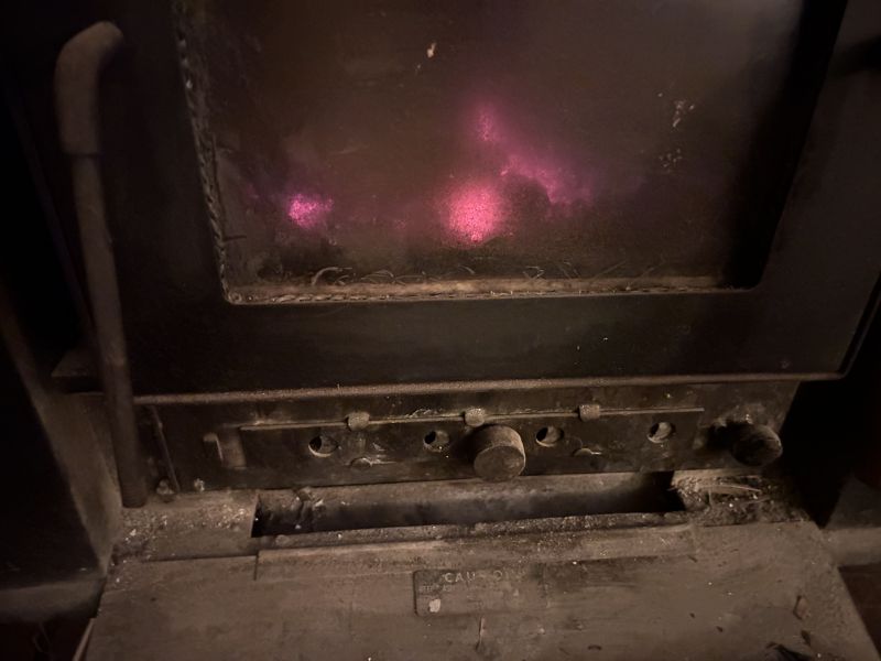

Thanks Brett. Yes there is a sliding air intake cover. Here is the one on my other old Arrow stove (I read they were made in Oregon, why many seem to be floating around here) in my house master bedroom, where I happen to be at the moment (slid open for photo). Didn’t occur to me, since I just keep both slid shut, just have the door cracked open until the fire gets going, then shut the door and the wood smolders all night. guess I could figure out a way to run a tube off that plate outside..or just go through the pedestal.
# Posted: 30 Oct 2024 01:55pm
Are you sure the draft channel(s) from the knobs aren't filled with ash?
Ime, the best draft would be from beneath the fire rather than through the door.
# Posted: 30 Oct 2024 02:15pm - Edited by: paulz
I’ll look. There is a hinged door behind that plate, you can see the knob at right in the photo. and when swung open the box that holds the ash that drops through the holes in the fire box slides out to empty. Not sure what goes on besides that, too hot to check right now.
One other thing, semi related, the other side of the house has the original brick in wall fireplace. Sits on the concrete slab floor. No way to add fresh air to that, right (never use it anyway). Also has gas stove and heater, never seen feeds to them. What if you lived in a basement, fresh air has to enter from below the fire box?
