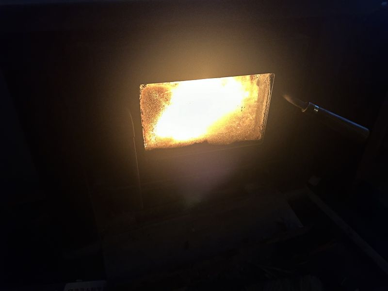

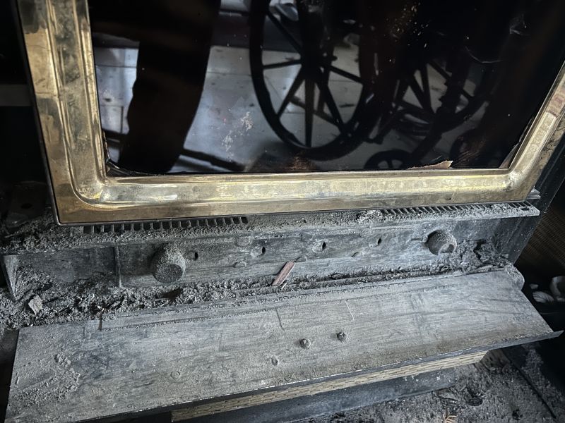

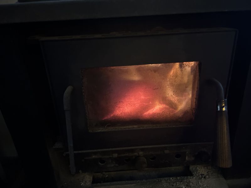

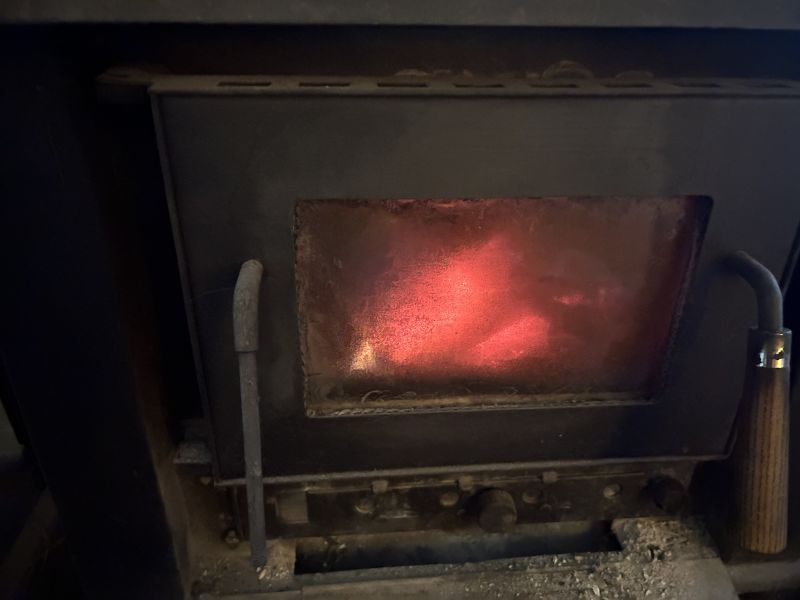

May be my case too. Just took some pics (still at house, wife as a dermatology appointment, sheesh). One with door cracked open to second catch, second with door shut and sliding plate opening holes (just visible at bottom), third door and slot holes shut. I still need to investigate further after cool off.

Had a good look at mine (at the house still) while cold this morning, as G said air goes from under the pedestal, up front to the sliding valve, through that to the ash box, around that through the holes in the firebox bottom. Ash piles just make it all worse.

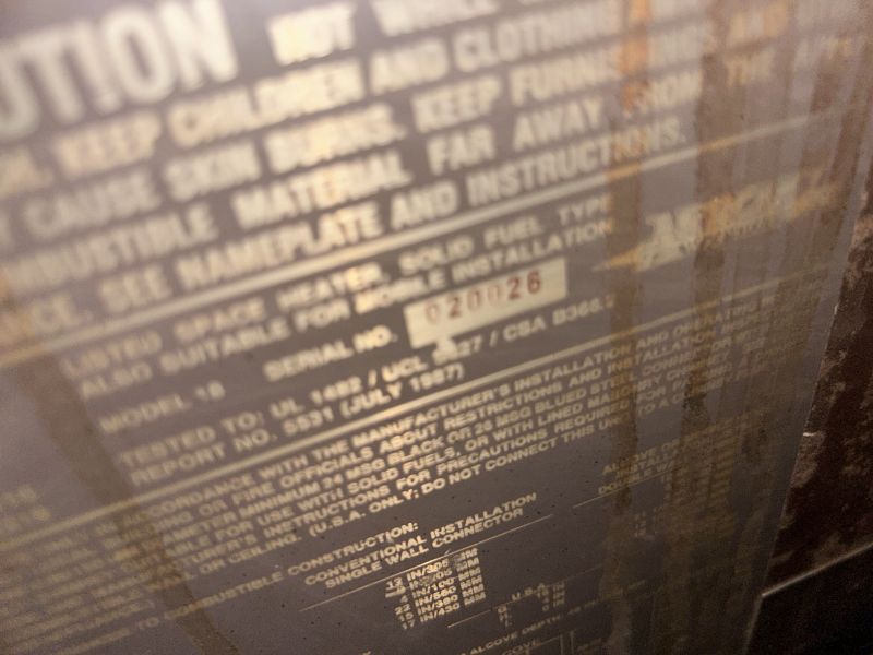

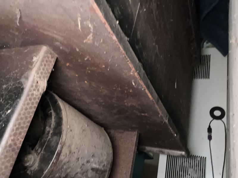

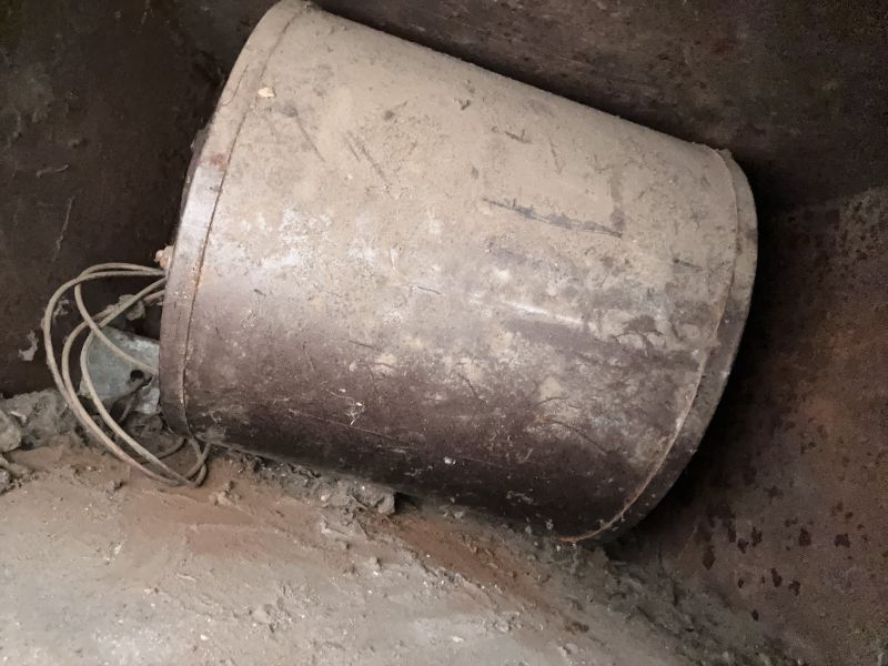

Having a good look at my cabin wood stove today. Snuggled in between the pedestal and wall to see the back side. Surprise surprise, there is a motorized blower in there. And a rotary switch on the outside but no plug in wire I see. Furthermore, there is no hole in the bottom of the pedestal to feed outside air as in the illustration I posted earlier. It appears to take air from the back side of the 3 wall pedestal. Doesn’t look like there is a plate that goes over that back side, and if so I never got it. Also found the Arrow model number, 18. Don’t see that online, only the model 1800, so maybe it’s a very early one with no outside air function built in. I guess I could make a back plate with a duct..
Anyway all night big log fire last night, as usual, so no big rush.

Izzy, the first pic above is from the back of the pedestal. Air must come in there, you can see the perforated corner where a plate would go if it had one.
The blower sends it to the air valve under the front cover (which is also far from sealed. After it goes through the sliding holes it enters the ash box section, where it can enter the firebox through the bottom holes. That’s how it looks to me. Also, those slots in the top of that cover supposedly keep the glass clear.

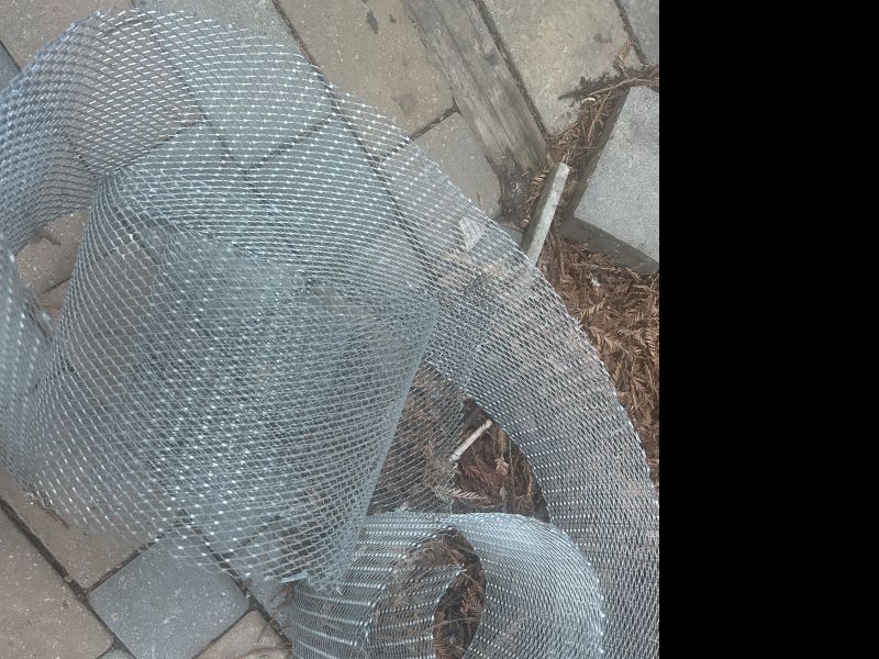

The factory cap c/w spark arrestor had, iirc, about 1/4-3/8"? When
Found a chunk of this in my shed. It’s about 1/4”. Yesterday I wobbled on to the roof and wired it around the chimney cap sides. Doesn’t seem to hamper draft, usual overnight log.
