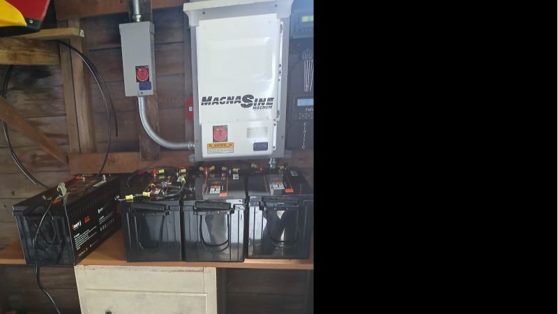

I had previously charged all 4 to 100 percent prior to bringing them to camp and hooking them to the combo inverter charger.
Everything was fine, all lights on panels for charging, inverter pumped 110 to camp....llights worked....yippeee....LiFe was good
Before I left I turn off inverter and main breaker in camp. Wasn't able to get back up for three weeks and when I went up yesterday no ac, no lights on inverter or Charge panel. No sign of puffy or damage.
Ok, I hooked up a Chevy volt battery and everything lit up fine.
Checked the BMS and all 4 said standby,
Ok....BMS went to sleep?
I didn't have a multimeter but BMS has 27 volts.
I've read you can jump them to wake them up.
Can I just bring my lithium charger and give all 4 a jolt?? Assuming I have to disconnect from CC

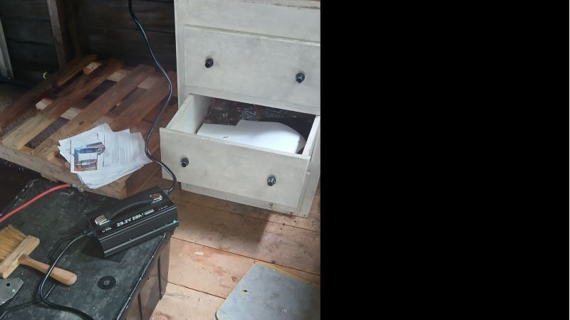

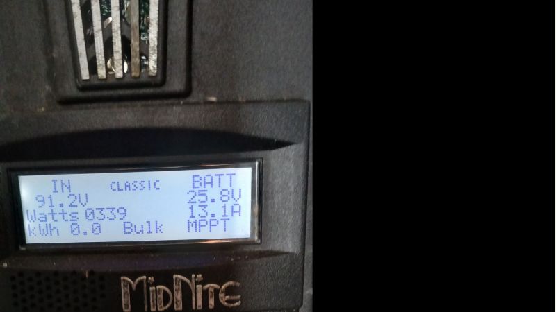

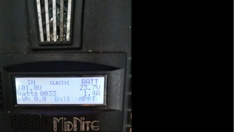

rachelsdad
# Posted: 30 May 2025 12:23pm
Thanks all. I brought my lithium charger and it registered 1% charge after a few minutes.
I hooked it up to the CC and everything went on. Same w.
2nd battery, now jumpingbthird...run charger for 2 minutes...

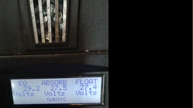

Then I thought....I never changed charge settings!!!!
Absorb was 24!!! I've set to 28.8.
Should I take all batteries back home and charge to 100% and then reinstall or can I let CC do it?
rachelsdad
# Posted: 30 May 2025 12:27pm
All 4 are at 25.2 after a couple minutes on chsrger
rachelsdad
# Posted: 30 May 2025 12:41pm
3 batteries Cc and inverter working
rachelsdad
# Posted: 30 May 2025 12:48pm - Edited by: rachelsdad
4th getting jumped

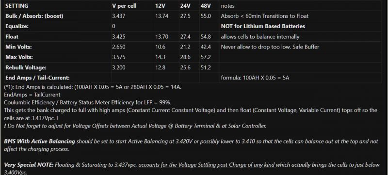

# Posted: 30 May 2025 01:02pm - Edited by: Steve_S
28.8V is 3.600VPC and TOO HIGH ! Charging at that rate, regardless of cell quality used will result in having some cells reach High Volt Disconnect thereby hampering the charge and leaving an unbalanced state (see harm).
I see you have a Midnite Controller: Please refer to this post that covers them, the quirks & settings.
https://diysolarforum.com/threads/steve_s-tech-my-final-config-for-midnite-classic-sc c-jkbms-w-large-bank-works-amazingly-well-includes-charge-profile-bms-config.42549/
See Attachment for proper settings for SCC and Inverter CHARGER or other advanced external charger.
LFP charge-settings 12-24-48V

Should I set EQq To 0

# Posted: 30 May 2025 01:31pm
The setting are obviously the same as I use with my Classic 200 & 150 and very closely match for the Victron & other SCC's I've deployed... damned terms vary a bit by maker though...
NEVER EVER Equalize Lithium Batts !
It is very important to use the EndAmps to determine transition from Absorb to Float. These values are discussed with the linked post @ DIYS above. BTW, a WizBangJr is the best way to use that as it is quite accurate.
As a side note, I am typically in float by 11:00-12:00 on a typical sunny day. All packs in the bank (6x280AH / 51kWh) are usually within 0.005mv difference within 30 minutes after entering float right across the bank.

# Posted: 30 May 2025 01:32pm
Eq will not drop below 27.5....
