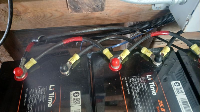

Once they have all been fully charged up and allowed to settle and balance between themselves (takes a couple of time of being in Float for a couple of hours) they will naturally balance & stay that way. PROVIDED the wiring and connections are proper & correct, such as wire length and AWG etc.
The most common issue with banks using multiple packs in parallel is that people are not precise with the cable lengths (very important) or using identical wire. Even 1/0 Coarse Wire is NOT at all the same as 1/0 Fine Strand wire and will cause different resistance & voltage drops which is really bad JuJu.
I used to use Royal Excelene Ultra Fine Wire Welding cable with a little over 1000 strands of pure copper (1/0) but switched to Kalas FlexWhip that has over 1200 Segmented Strands and a lot less resistance & voltage drop. Every line is within 5mm difference and all Lugs used are Nickel Plated Heavies (more $ than tinned) which will never corrode.

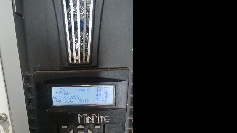

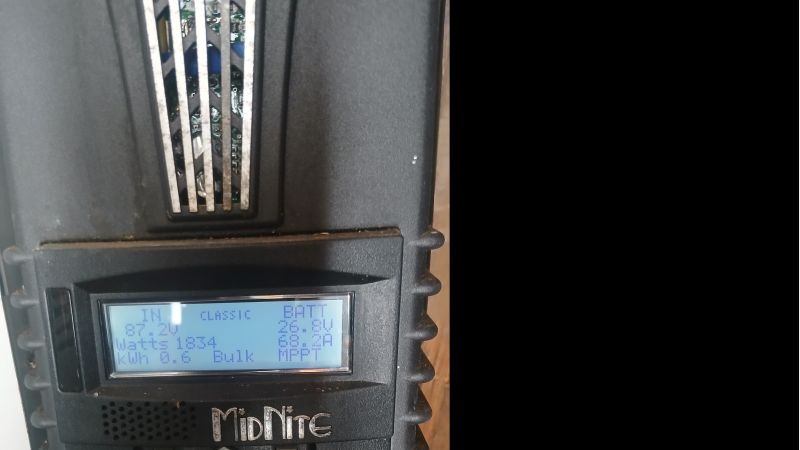

# Posted: 30 May 2025 02:56pm
Yessir...good wiring...hope you approve, no bus, but all equal length
All readings within past hour...finally some sun!

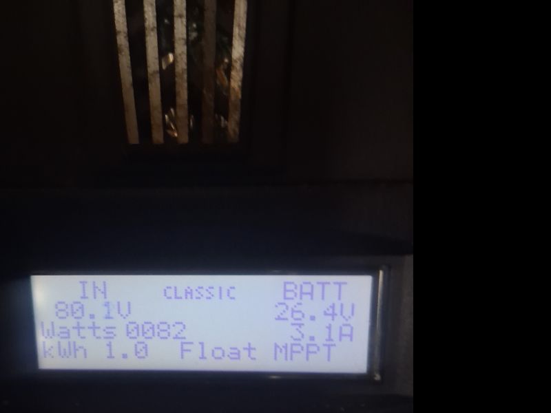

rachelsdad
# Posted: 28 Jun 2025 09:31am
Here are the readings on a cool cloudy morning

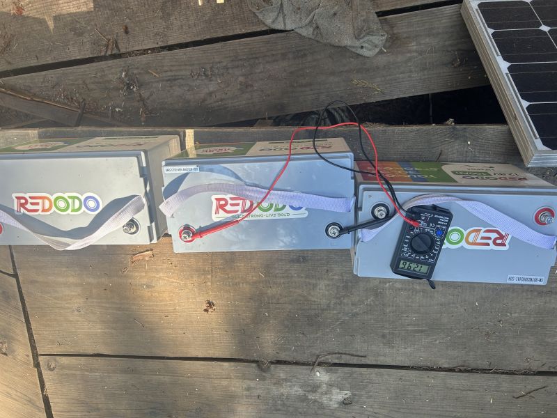

# Posted: 12 Jul 2025 07:19pm
I’m tired of leaving these ReDodo LFPs, named after me, under the cabin bed, which is where I have to dig for my reading glasses. They’ve been unused since my decade old LFPs refuse to give up. They’re going in the shed. They measure 12.95-13.00 volts. Good storage temp or should I give em a jolt?
