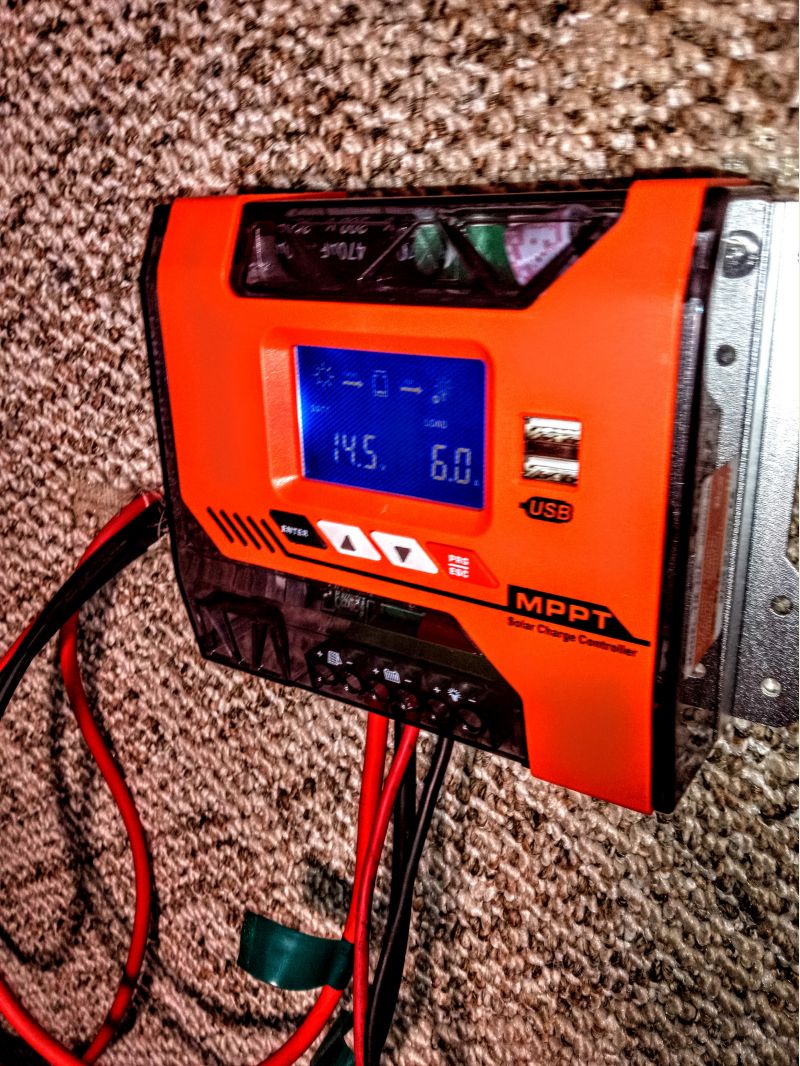

So, I plugged them into my new 8 awg wire onto my new Shengen MTTP (undersized 20 amp) charge controller and was blown away how well they performed, easily pulling 19.7 amps at 20.4 volts where all the time prior regardless the controller never higher than 13 amps at best! These numbers were also limited due to the 20 amp controller and the battery now being full charged to 14.5 volts while the controller throttled down as it should.
The controller (provided it lasts) may be one of those odd gems, with it's smoked see through case, readouts you can read from odd angles and accuracy with zip heat output...panels still kicking after 14 years!

Pleasant Surprise indeed and I'm willing to bet, you had serious doubts about those old "crusty" panels eh. Do you have a link for that MPPT Solar Controller ? I'm curious about it.

Keep in mind these are sold under many different names but the real manufacturer is Shengen.
https://www.amazon.com/dp/B0DZ29WBVR?ref=ppx_yo2ov_dt_b_fed_asin_title&th=1

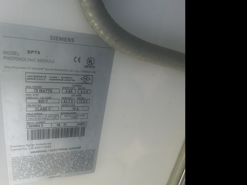

Went down and blew them off then played around. Whole array comes out in two pairs. Both measured equally 34 volts. Label says 17v so they must be paired up. Nicely put together with copper stranded. Only took one cover off. My VOM didn’t have dc amp fitting so couldn’t check that.
So, be better to run more in series? What about those Schengen SCCs, good?

Typical older panels, that's some beefy wiring, are they wired in Series or Parallel, (looks like Series on the tag) From your tags looks like a 40 amp SCC would do fine.

Parallel is MUCH better for shade. Based on your location they are probably configured pretty decent. I wouldn't change them.
I mean we can get into semantics. 34V is pretty low and a quality MPPT wants more voltage... bla bla bla..
But you have been using them so far and things are good. Sure you might get more with some tweaking, but will the juice be worth the squeeze for your use? Probably not!

Yes these must be 2 parallel,3 pairs in series, two sets, 12 panels total. This morning, in total shade, as they always are for about 23 hours a day, one measured .3 amps, the other .2xx. If I happen to be down there and catch in the sun I will measure.
But again all it has to do is keep my trail cam going and a couple shop LEDs when I go for a tool. One 12v car battery.

Just got my 40 amp replacement SCC for the problem child 60 amp SCC (which was putting out half of the 40 amp) and all is well in the world, output is back up where it should be, for $60.00 all in I couldn't ask for more and if it doesn't perform send it back!
If you are getting 34 volts coming out of the panel array, and IF you are using a PWM charge controller like the ones HF supplies in their kits, and IF the battery bank is 12 volts, then your system is wasting over half the available energy.
That is the fault of the way a PWM charge controller works. All PWM charge controllers clip off the incoming voltage that is higher than what is required to charge the battery and disposes of that energy as heat.
Simply put, an MPPT charge controller contains magic parts and software that can convert the excess voltage and turn it into amperes to add to the charge of the battery.
If those batteries are being sufficiently charged the way the system is, I guess you can say it works, so it does not need changing. However, if you would like to charge more batteries, use more energy for something, then some changes might be beneficial. But that is a project needing more complete information before tossing money at it, IMO.
