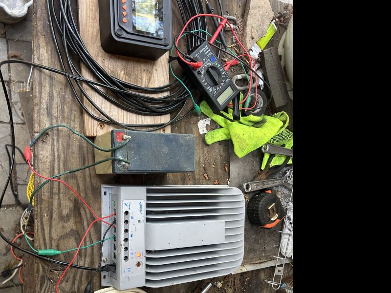

Phew what a morning. Taking all the advice, i hiked down and unhooked that old Siemens array from the HF controller. Then found another Epever Tracer Mppt down there, same as the one in the cabin. Then remembered i had an unused wire cable running up to the cabin. So i jumpered the array to it and hopped in the 2wd cart i just got going again to head back up. First corner up the hill one of the rear tire chains i put on years ago rolled off the inside and locked up the brake drum, wouldn't move. Walked up the hill got in the 4wd cart with jack and lug wrench, drove down and pulled the wheel off. Drove back up, still 34v from the array. Found an old dead battery with 9v in it, hooked up the SCC for a test. Says .4 amps, array in a bit of sun.

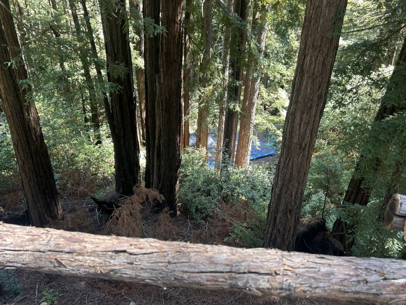

Here from the cabin deck you can see the array down there. Also the HF panels, which i will connect to the HF controller. Guess i will connect the second Tracer scc to the cabin bank as a helper.

Later yesterday that little battery fully charged so i moved the Tracer output to the cabin bank. Probably little help but two things:

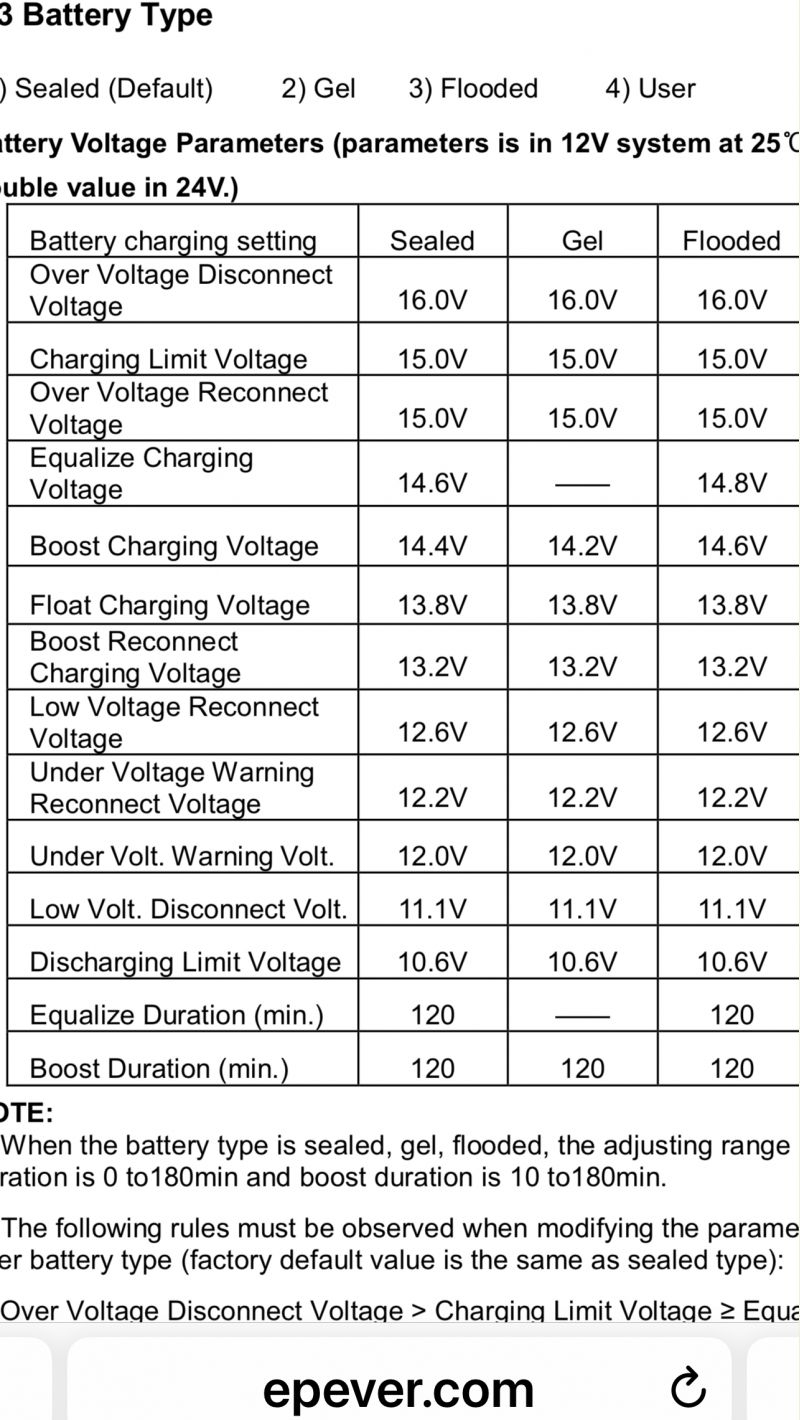

# Posted: 3 Sep 2025 03:07pm
From Tracer book
# Posted: 5 Sep 2025 01:19pm - Edited by: paulz
Take a look online for the Gel battery charge profile
Yes the gel setting does knock off the equilization. But the boost is only 14.2, a bit low for lfp.
Ive been getting about .8 to 1.2 amps daytime out of the seimens. Never good sun for long. But even in early or late day shade it shows .4. So I guess thats the mppt. Every bit helps.
# Posted: 5 Sep 2025 07:15pm
For regular cycle charging Id be fine with 14.2v
# Posted: 6 Sep 2025 11:18am - Edited by: paulz
Good point. In fact on the main cabin scc, set on ‘user’ setting, i think i have the boost set down to just under 14. Never gets to that, even when gone for several days with power off and solar going it will only be in upper 13s on return. So the ‘gel’ setting would be fine.

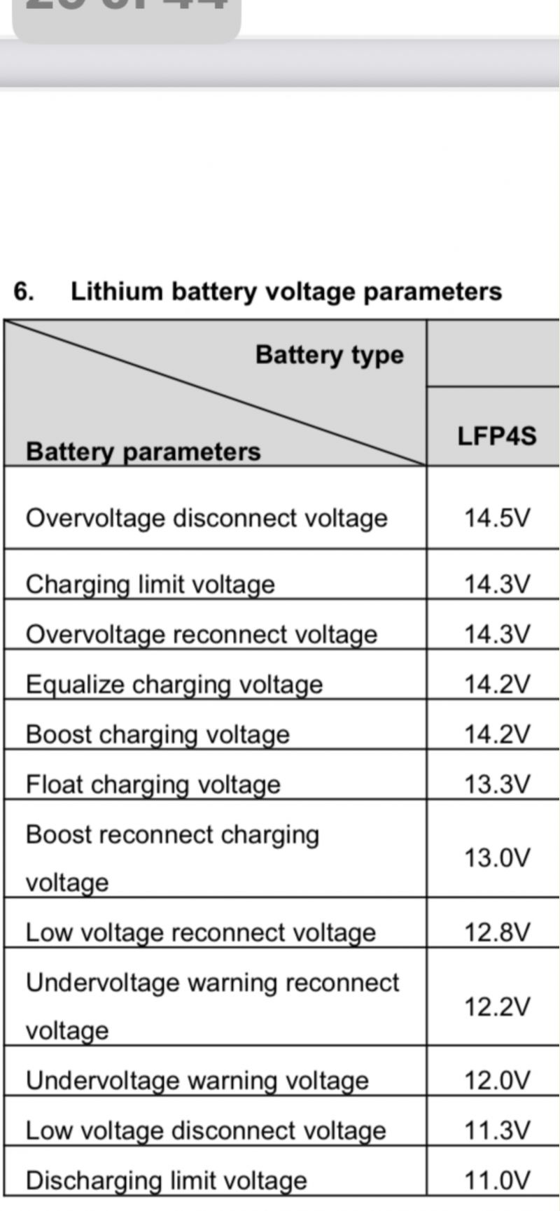

# Posted: 6 Sep 2025 11:06pm - Edited by: paulz
Thanks guys. With a bit more investigating, only the epever AN series G3 has lfp settings. Here they are, havent studied..
https://www.epever.com/product/tracer-an-g3-series-mppt-charge-controller/
