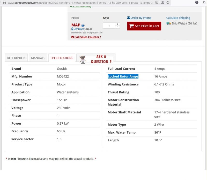

My pump is;
Goulds 10HS05422C 4" Submersible Water Well Pump, 10 GPM, 1/2 HP, 230 V, 2 Wire
I am not going to be at the cabin now for several months, so cant confirm the Surge rating of the pump
Pump specs are shown
Can you confirm from this info if the 6000XP would be able to cope or do i need the Surge rating?

According to Pumpproducts the LRA on that motor is 16A.
LRA is the maximum amount of current the pump will draw when the rotor is "stalled" (from a dead stop). So 16A at 230V is 3680W.
zorro
# Posted: 3 Nov 2025 11:09pm
Thanks for the info
So 3680w may be an issue
The inverter is 6000w but that is split across 2 x MPPT’s
However, it does have a max surge of 11000w for 5 seconds………..which may be enough?
So maybe I need to speak to the inverter company to see what they say as I am not too clear on that point
Thanks again - appreciated

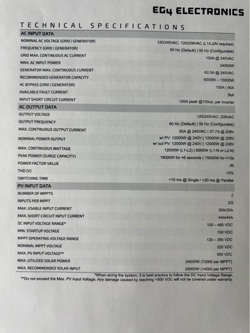

Another question
This system upgrade needs to be able to run my well, or my wife may kill me!!
So............would the EG4 12000XP be a better option?
Clearly that has a massive amount of power and may be overkill for the cabin........but if it runs the well, i would definitely look at that as an option
Specs attached
SCSJeff
# Posted: 4 Nov 2025 11:52am
My .02...
Start with the 6000XP. If it has trouble (ie: dimming lights or just overloads), you can always add a 2nd in parallel.
Note: Battery capacity/amps should be large enough to handle the surge too... If the voltage dips too much on the batteries, it can cause the Inverter to go into low voltage shutdown. (which can be confusing at first and cause you to think it is an overload on the inverter)
travellerw
# Posted: 4 Nov 2025 12:14pm
Quoting: zorro
Another question
So LRA is that maximum amount of current the pump can draw IF the rotor is completely stalled (think seized). Due to the design (number of windings, magnets, ect) it simply cannot draw more. It also can only draw LRA current for a short period until it over heats and burns the windings.
However, inrush can be over LRA (for miliseconds), but only in certain situations. Situations that are unlikely to happen with a deep well pump, even with a high head pressure.
So, IMHO you will be fine with the 6000XP. However if you want to know for sure, I would reach out to EG4. They have a technical support number and I have been told they answer it. They can give you an answer for %100.
On another note, that pump has a built in capacitor, but it not soft start. You could install a soft start! People on the solar forum have reported positive results with this product on compressors (with much bigger motors than your deep well pump).
