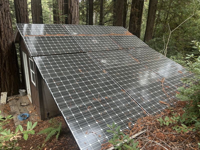

Easy enough that I could figure it out!Here’s my main array, I have about twice this much scattered around. Maybe half will get sun for a few hours a day. And here’s the specs. I have them 3 in series but could change with much effort if it would help substantially. What do you think Trav?

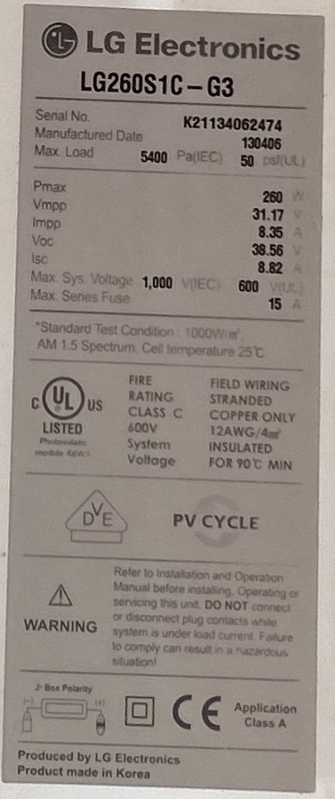

Ok, so 5 strings in series of 3 panels?
That would mean a max voltage (open circuit) of 116.58V
With a max amps of 44.1A
A 150/45 would be the right choice. Although a bit of a waste as I'm pretty sure your array will never come close to those numbers.
If I was trying to squeeze every watt, then I would reconfigure the panels. For that array, with all those shadows 100% parallel would be the most optimized. However, I don't think it would be worth it as you would need new wire to carry the extra amps.
If I had some extra time and money I would reconfigure to 2 panels in series with 7 strings. Make sure 2 broken panels are together, then remove one broken panel completely. I would use 2 controllers. One 100/50 and one 100/30. Even with one less panel I'm pretty sure this config would perform better than the current config.
However, you know your current config works fine. The simplest and cheapest solution would be 150/45. Make sure you get the SmartSolar version as it has built in Bluetooth.

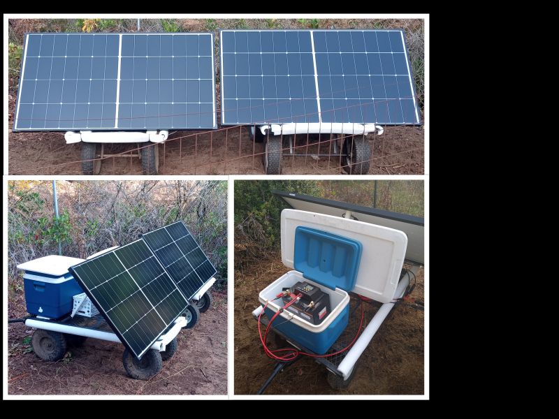

My main aray is 2000 watts and fixed position, so I grab what I can when the sky is right but on decent days there are places where you can get a couple hours of exposure which also changes with the season so, I figured why not go where the exposure is so I hinged a 300 watt panel onto a garden wagon, with old cooler for weatherproof battery and charge controller storage with option to charge in parallel and presto, can charge two batteries individually or one in parallel and if a storm is coming just lay the panels flat, so far so good!
Portable Panels
Portable Panels

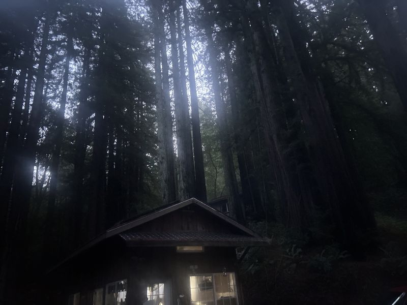

Here you can see the guest shack just behind the cabin roof, where the array is on the other sides. The sun rises to the back side and travels above the hillside around the other side. Between the trees and hillside it’s a battle. It’s a bit better down the hill at the flat by my shop but not much. Forest everywhere.

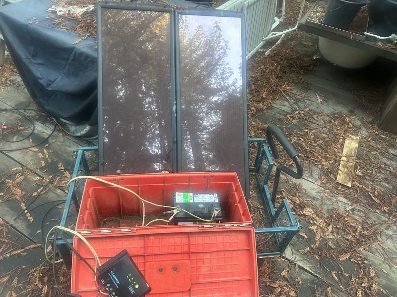

Ha, great minds! I have a garden wagon with a couple old panels I wheel around to charge the old vehicle batts.
# Posted: 10 Nov 2025 01:20pm
Do you get the panels out of the box so the lower cells aren't being blocked? If not you are not getting the production you could.
# Posted: 10 Nov 2025 05:04pm
Box comes out to unblock. Not a big deal, just a battery trickle charger.

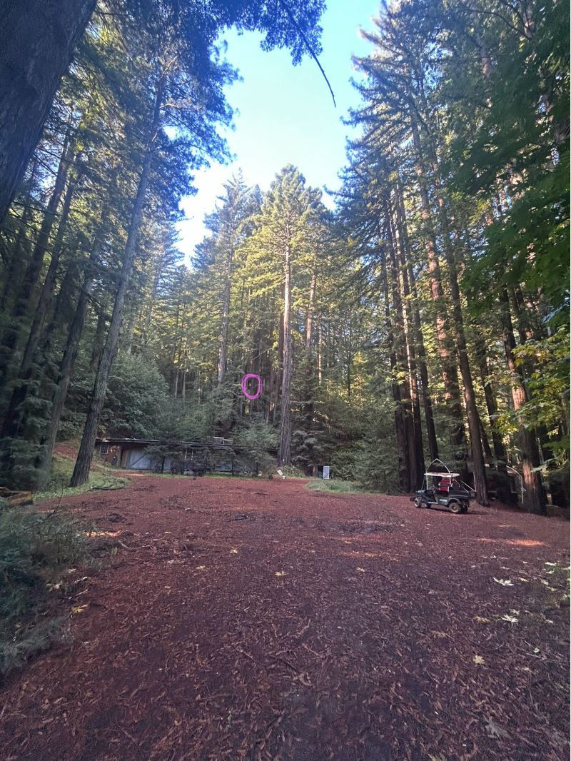

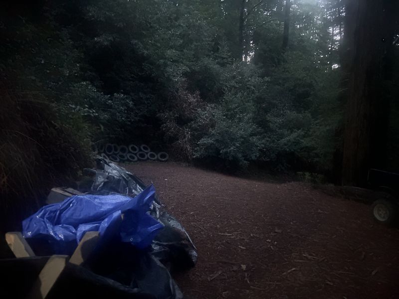

Took this photo this morning at my gate. There was a house that came down in 1966. The foundation is my shop now. The place was solid trees, they cleared the area in front out for the house. Works for me! The cabin is just above in the red circle. It’s the back of my property line or I would have gone higher. Good build spot down below on the flat except for all the noisy traffic going by.
# Posted: 10 Nov 2025 06:14pm
Quite a site Paul! It is truly amazing that you get the solar production you do.
By the normal site analysis for solar Im sure yours would be considered a poor candidate yet you made it work
# Posted: 10 Nov 2025 07:22pm
Thanks. To do over again: across the road on the other side of the valley are the power poles, and the property on my side bordering me already has a power pole with line running across. All I would need I guess is a drop box on a post on my property.
But at the time I bought it, like many of us, I just figured I’d park a trailer out here, which I did for first year or two. Later the solar came about with a cheap HF kit, and on that went. Couple benefits: no power bill like back at the grid house every month, and then when the neighbors complain that the power is out, I light up the cabin like a Christmas tree.

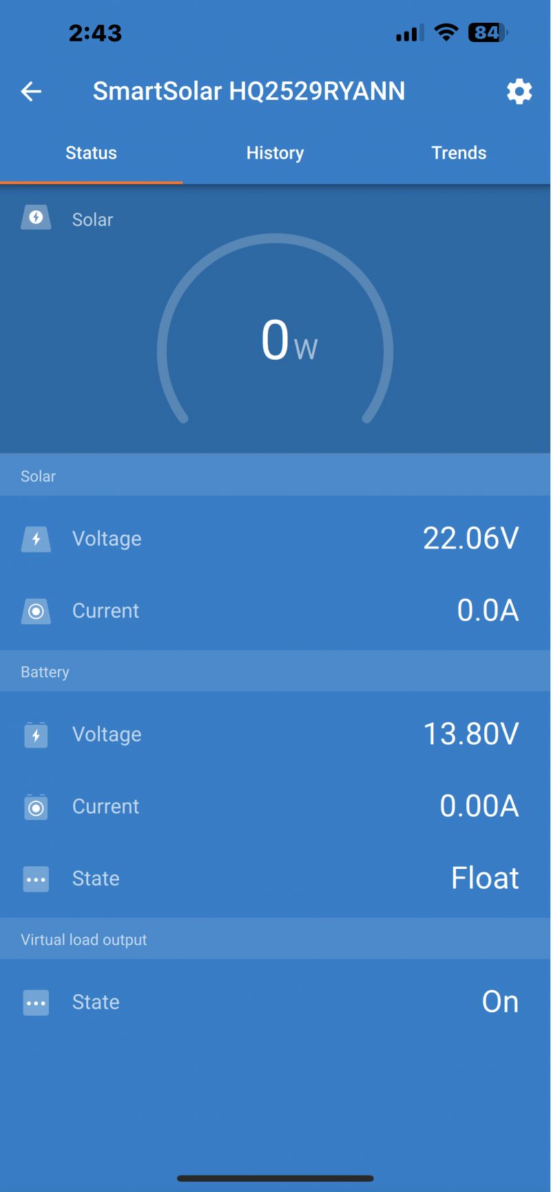

Got my new Victron SCC hooked up to my old array down at the shop and some spare LFPs. No amps in yet…

# Posted: 20 Nov 2025 08:27pm - Edited by: travellerw
Solar controller is in "Float" mode. It thinks the batteries are stuffed. Since you aren't drawing anything, its not putting anything in or showing any amps!
Check your settings and make sure they are right for LFP batteries!
# Posted: 21 Nov 2025 07:18am
Quoting: travellerw
I finally scrolled down and found the Lfp in battery settings. Is that the only setting I need to do?
travellerw
# Posted: 21 Nov 2025 10:13pm - Edited by: travellerw
If you click the gear in the upper right hand corner, you will see the settings (as well as the ability to update). Standard LFP settings should be good to get you started.
Look for the setting that says "Battery Preset", change it to "selext Preset" then select "Smart Lithium"
With LFP, if they are full and you are not pulling anything, the controller won't show anything going in since LFP is so efficient and has such a low self drain! Pull the battery down a bunch and see how the panels perform.
travellerw
# Posted: 21 Nov 2025 10:22pm - Edited by: travellerw
P.S. if you don't want to phaf with the app, you could always just turn the switch on the controller. Look for the little white rotary switch on the controller and turn it to 7 for LiFePO4.
However, if you already changed the setting in the app, it will ignore that (since you changed the setting from "rotary switch" to "Selec preset").
