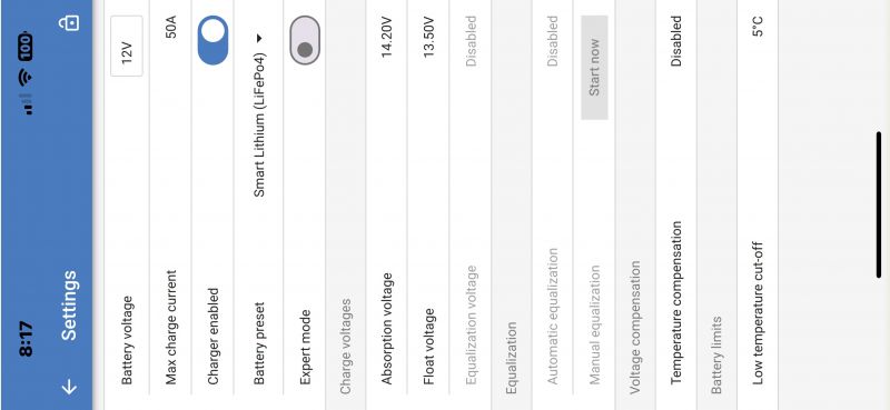

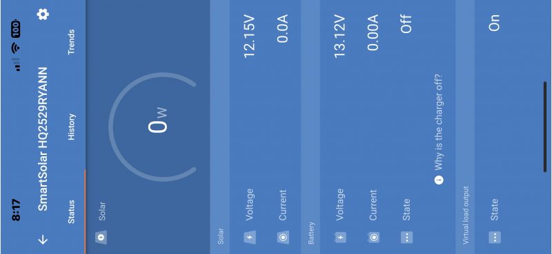

Thanks Trav. I have the battery preset at Lfp. I see the rotary switch, no need to bother I guess.
For some reason it shows 13.1v, even though direct vom reading only 12.5 this morning. Why? Going to be a sunny day, see what happens..

Strange, try taking the voltage right off the battery positive and negative on the charge controller. If they don't match, think I'd be trying another volt meter as one something is off. If 2 volt meters agree, then I'd be looking at replacing the charge controller. Id try this in the dark to be sure your getting accurate readings from the battery only.
Mine always match or at least are very close.

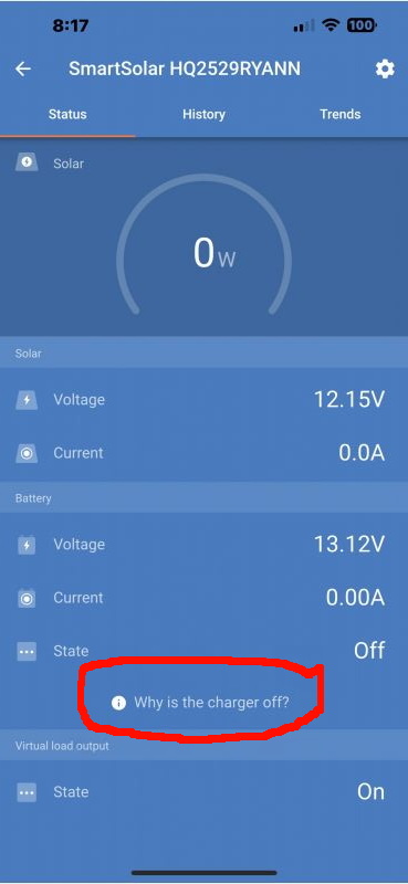

What response do you get when you click on the "i" "why is the charger off?" question?
# Posted: 23 Nov 2025 03:40pm - Edited by: paulz
I’m back at the grid for a couple days but I did look at that. Said check cabling etc. I just assumed it said off because the solar voltage was lower than battery voltage. This was early before sun hit panels. Be back Tuesday.

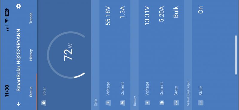

Starting to feel good with the new Victron SCC. 5 amps coming in on this cloudy morning with no sunlight hitting the array through the trees. One oddity is my panels measure about 90 volts open circuit with a volt meter but only show 50 something on the SCC. Is that the SCC usage knocking them down?

Not the SCC knocking down the voltage. Voc is the voltage that may be produced for an instant when the sun ops up over a ridge and direct sun first hits the panels. It won't last for more than a second. But it may last long enough to be higher than the maximum permissable voltage for the SCC. That is why, in the NEC, the Voc is multiplied by 1.25 to determine possible max voltage in sizing the panels to the SCC. On a very cold morning it might be possible for the first solar voltage of the day to instantaneously exceed the hardware limits of the SCC. The NEC has more detailed factors that vary with altitude as well as temperature, and just how cold it gets. In a warmer climate it is possible to use a lower value safety multiplier.
That reading means 55.18 volts was reaching the Victron SCC from the solar at that moment. That may rise as more sun hits the panels or fall as sun decreases. Plus 1.3 amps was being received from the panels at that moment. The graphed image indicates the power being received from the solar amounts to 72 watts.
Then we see that 5.20 amps are going into the battery at 13.13 volts in a bulk charge state.

Ok got it now. What I measure with the panels disconnected is open circuit voltage. Voltage shown on the app is voltage under charging, in my case about 30% lower. To test, I measured voltage with all hooked up, then removed just battery from the SCC, eliminating charging. Voltage went back up to 80 or so, same as open circuit.

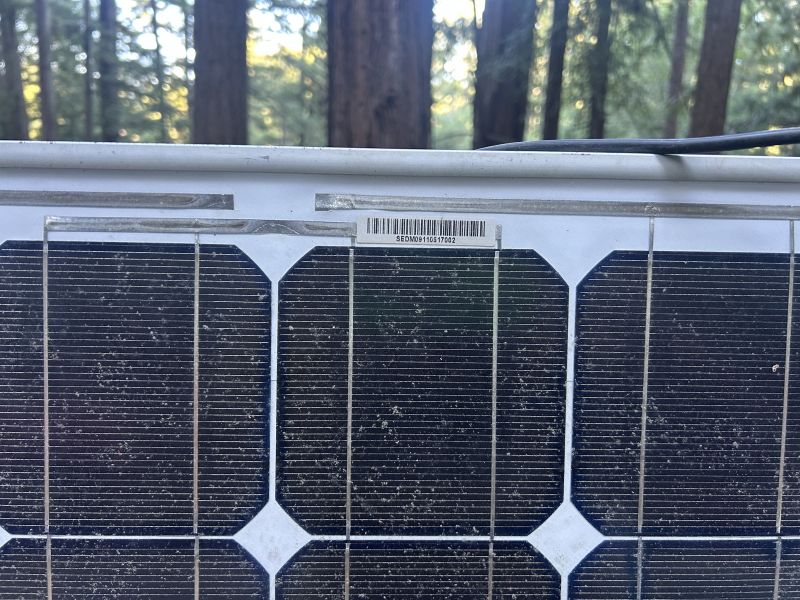

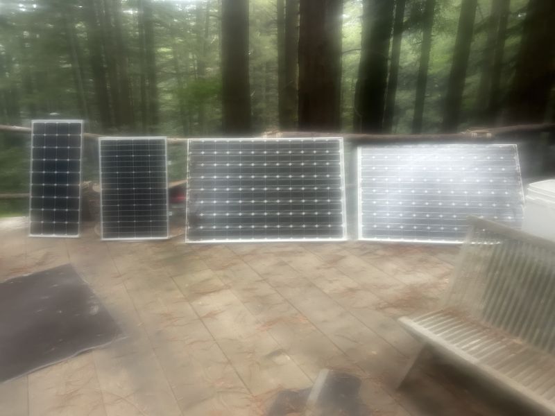

Yesterday I drug these old misc panels up here and hooked to the old Epever to see if they get anything. Nothing so far, but sun supposed to come out today. The two large pair have no labels, just this bar code.

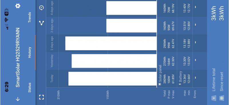

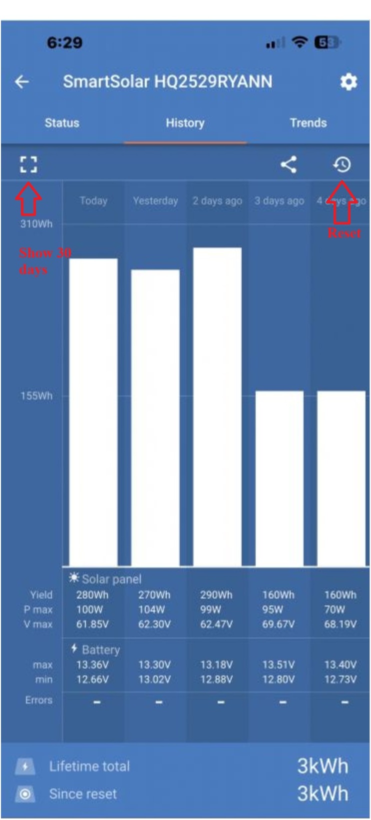

Back to the cabin after 3 days away. Graph shows the 3 days we were gone, solar going of course but power off. Two days prior using bank power. Don’t know that kWh mean..
1 kWh = 1000Wh.
That is the total power you have generated since you plugged the controller in (Lifetime power). That number will continue to climb and cannot be reset.
The other number (since reset) can be reset using the app. Some people like to reset it periodically (1m, 3m, 6m, 1y). This can help you trend your power over time.
By default the app only shows 4 days of history. See the image I attached to see 30 days.

Ok I get that, thanks. On the two bars next to each other, yield is much higher on one at 290 than the other 160 even though watts and volts are about same. Is that because power was on in the cabin on the lower day?
It should be the other way around! On the days that you didn't have power on in the cabin, the batteries would fill much quicker putting the charger in float mode. Once in float, it pretty much stops capturing energy from the panels (just enough to keep floating the batts)
The days you had power on in the cabin and were actively using it, then you would generate more (if enough sun is available).
Remember, power that you are using during generating hours is coming from the controller/panels. e.g. if you have 9 amps going into the batteries, then turn on a device that draws 4 amps. You would then have only 5 amps going into the batteries. However, if your batteries are full and you turn on a device that draws 5 amps, the controller will flow that current from the panels leaving the batteries full still (again if sun is available). That energy is still counted by the controller as it went somewhere.
I hope that makes sense.
Now the question is.. Why it produced more while you were away. That seems strange to me!

Perhaps that day had more sun to push power into the batteries? In Paul's location the sun is iffy and more iffy in winter

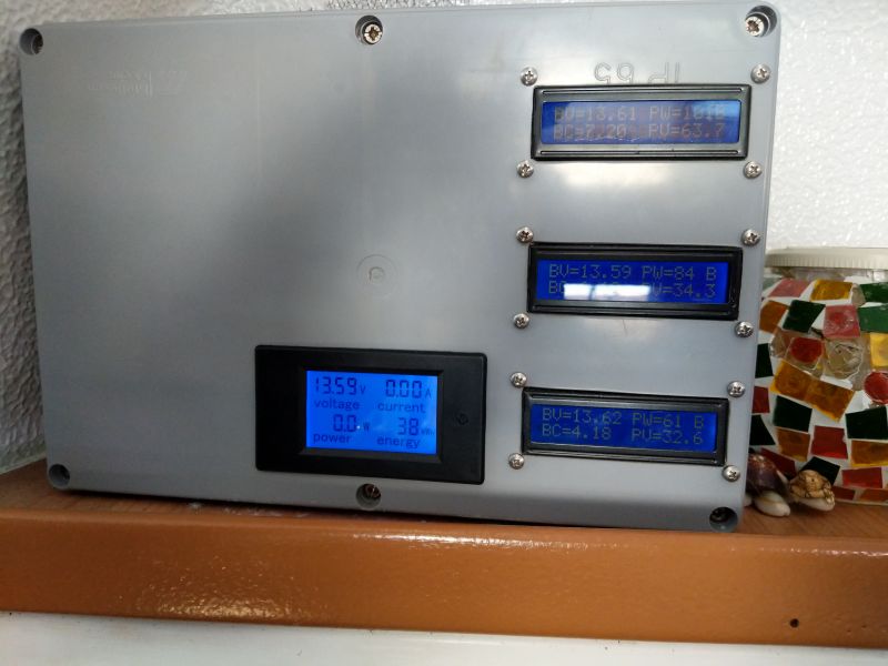

The VE.Direct port is super useful and fully open source. The community has built all kinds of things around it. I even have a project for an arduino display. It uses an arduino and a cheap 2 line LCD. I used them on the boat so I could see what our solar was doing at a glance.
If you are interested in tackling that project I could upload the code. You would just need to do the soldering.

As to the displays, they are about $25 to build these days (maybe a little less). I uploaded a picture showing what they look like.

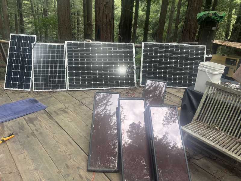

Holy cow, 8 amps charge in January in no sun. My other side project, besides trying to get the TV antenna to work through the trees, has been jumpering in all my old spare solar panels. The main arrays above the cabin, 4 of which branches went through, are putting out the bulk, about 5. Then the old array down on the shop roof did almost 2. The misc junk on the cabin deck got the 8 total. Generator may even get a rest break. Come on spring!
