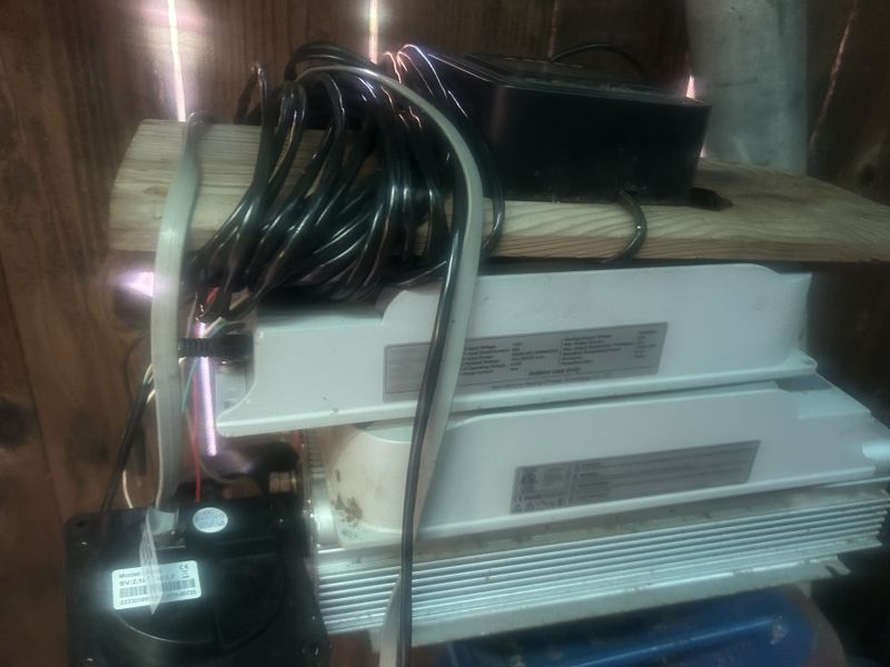

You’re not supposed to mix different panels they say, as voltages vary. My main panels behind the cabin are at about 90 volts (3 in series) so I put the 12 shop panels in series giving me about 70. The 4 hf panels in series are about 60 and the others about the same. Panel voltage on the Victron is below 50 so it seems to work. Later this year when the sun hits the main panels it may goof up.

The Victon's are pretty resilient... BUT they can be damaged by overvoltage (like any controller). If its just a little over, they will throw and error and disconnected. However, a big voltage spike will damage them!
Be careful as you don't want to purchase another one!

Thanks guys, good interesting stuff. What I will do is move all these misc panels over to my old Epever Tracer which is still on the wall, no problem frying that. The sun is just barely clearing the hill and trees at this point.
