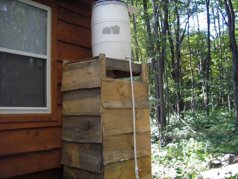

Here is the system I've been using until now. a simple 50 gal barrel that collects water from the metal roof via aluminum gutters. A piece of no-seeum tent material filters out the big stuff. The barrel sits atop the makeshift outdoor shower This was OK for limited use and we would disinfect the water with 20 ml of bleach for no-drinking use.

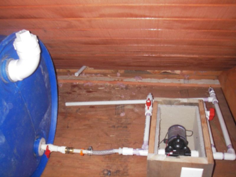

My current system (under construction) uses the barrel shown above as a roof washer, by moving the outlet closer to the top. This outlet goes to a 400 gal cistern buried 3 feet underground. This will be the reservoir from which the water is drawn to fill the barrel in the cabin loft shown below. Because of the extreme winter temps, I am going fill the loft barrel when empty with the cistern, rather than draw directly from the cistern and risk having frozen pipes. The loft barrel will be insulated with a water heater blanket and a solar powered heater to keep from freezing when the cabin is not in use. The pic below shows most of the plumbing in place, with a complicated valve set-up in order to use the on-demand pump to fill the barrel from the outside as well as provide water pressure to the cabin.

Hi Vince P,
So the pump and barrel on the picture are located in the cabin loft, and that pump is going to pump water from the underground cistern into that barrel, correct?
Shouldn't you place your pump underground, near the canister? I.e. pumps a good at pumping water up, no 'sucking' it from below...

Quoting: CabinBuilder Shouldn't you place your pump underground, near the canister? No, because the main purpose of the pump is to provide water pressure from the loft barrel to the kitchen sink (previously gravity fed from the outside barrel) and the new "indoor bathroom" I just built, which includes sink, shower and a self designed-flushing-composting-toilet. I am only pumping the water from the cistern to the barrel when the barrel becomes empty. I've acquired a couple of submerible pumps that I may use for that purpose if the loft pump has trouble. The only thing I have left to do on this project is the cistern. I can get the vessel itself for free, but getting it underground is the tricky part and I may need to hire a backhoe to get me that deep through the very solid ground in this area.
