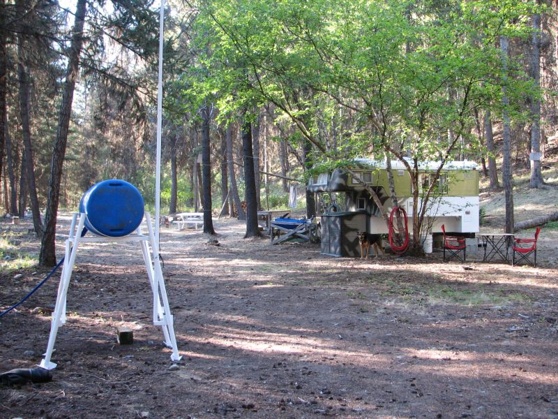

We put in a small water tower at our camp. We pump water up from the river below and store it in the barrel. We don't drink this water but do use it to wash dishes. We put a little bleach in the barrel to disinfect the water. An early photo of the water tower at our camp

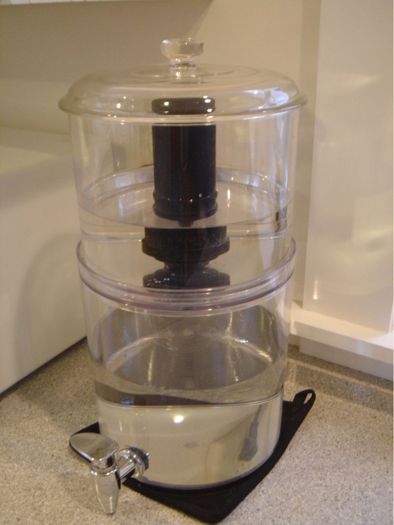

I did make also a small Berkey that Is shown in another thread here somewhere. Its to recycled filters cut down and mounted in a similar way as the bucket system shown, only I used an available water grade clear vinyl cooler found at walmart. The compete instructions are in another thread here.

Here is a photo of my counter type smaller recycled Berkey I made for my moms house. Small home made Berkey using recycled filters.

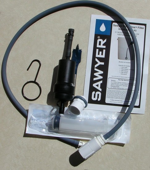

I posted this on our thread but it likely should go here:
RnR mentioned in a post on their thread the Sawyer filtration method as a possible interesting (less costly) alternative to the Katadyn water filter that they use to filter their stream water. Since we have "water, water everywhere but not a drop that we would want to wash in let alone drink" and the idea of boiling water for washing and drinking sounded too much like work (We are inherently lazy!) and too much stove fuel usage we thought we would try the Sawyer system (http://sawyerpointonefilters.com/).
First issue was trying to get one in Canada! The company only sells directly in the US even though you can go through the entire purchase form until you find this out. So next stop was eBay as I could not find a Cdn retailer. We went with the basic SP1803 - Sawyer® PointOne™ Filter w/Bucket Adapter Kit W/ 3 Foot Hose (Current price $61.59 usd) that they claim removes "Bacteria, Which Cause: I.E.: Cholera, Botulism (Clostridum botulinum), Typhoid (Salmonella typhi), Amoebic Dysentery, E. Coli, Coliform Bacteria, Streptococcus, Salmonella Protozoan (Cyst): I.E.: Giardia, Cryptosporidium, Cyclospora." NOTE: No viruses. From what I have read normal filtration does not remove viruses from water but chlorinating it does. However, chlorine does not work well in killing off Giardia or Cryptosporidium parasites.

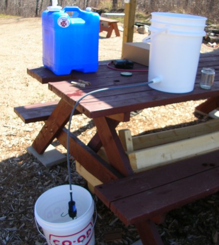

Next issue came up when I tried hand drilling the plastic pail with the provided self-tapping bit they. The bit dug in one side created an oval hole. Thankfully I was able to rasp it round and smooth and then silcon "to the rescue".

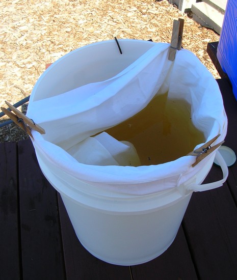

We tried it out last weekend with some pond water. We used a pillowcase to remove the big bugs (I think I will use a 75 or 100 micron Tyler sieve that I have kicking about instead of the pillow case in future.) The pond water was a decidedly greenish colour likely from the plant pigments in the water but not turbid. The filter did not require priming and it had a flow rate of about 500 ml/min. The water that came out of the filter was ever so slightly greenish in colour. We think we will add some chlorine, household bleach or pool chlorine, ((0.05 ml) of bleach to 1 litre of water, shake and allow to stand for at least 30 minutes) to kill any viruses or maybe we will try a Steripen. The water should then be acceptable for washing and showering. We think we will still haul out drinking water just because we are used to it (We have had gut flushing experiences from drinking high mineral content "pure" glacial water that we were not used to!!). I hope to get the water tested for nasties some time in the future to see how well the whole process works. If we did decide to drink the water we would likely run it through a carbon filter.

Hey Bugs! Thanks for sharing your experience with the Sawyer Point 1. I ordered one as well but we haven't installed or used it yet.
I was also thinking, have you considered having a rain catch and barrel and filtering that water when available instead of the pond water? It will likely be a lot cleaner and easier to filter. This is also a reference to Larryh's informative and throuth-provoking post above.
Also, from what I have read, viruses are not a major concern with drinking water, because viruses don't actually live in water but live in a living organism and are spread, in the case of humans, from person to person, rather than through drinking water, which is why the Point 1 is considered sufficient for most situations. The Sawyer "Point zero two" does remove viruses though, but it has a lower flow rate and is more than double the price if I recall correctly.
also, I got mine from their international seller at the following web site http://adventuresafetyproducts.com in case you ever need another one of for the benefit of other Canadians. I too went through the whole ordering form on the sawyer web site until the very end when you have to put in your address and there is no way to select a province, which was a little frustrating. I called their 1-800 number and the lady who answered was very nice and directed me to that web site.
So all in all, Bugs, would you say it has made your life a little easier? Would you recommend it? Is it too early to tell? Is it worth taking a gamble with the 60 bux?

Hey RnR
Thanks for putting me on to the Sawyer filter. I think it should work fine for general use but I don't think I would drink it (as mentioned in the post) unless we ran out of drinking water and it had been chlorinated and "brita'ed".
Been thinking about roof top water but not sure how much our little roof(s) will catch. If we have a dry spell, which our area is known to have, there might not be any water in the barrel(s) when we arrive. Might give it a try tho just to see. There is also the bacteria and algae growth that develops in most "normal" rain barrels as we have noticed in our rain barrels at home. Treating with some chlorine should, of course, alleviate that problem.
Like larryh I am well acquainted with cisterns as we had huge one in the basement on the farm when growing up. Other than the occasional floating mouse the water stayed clear and useable for the house with no treatment at all. Never really drank it but did brush our teeth in it. As I am writing this post I guess I suffered know ill affects lol.
We are considering the Sawyer as a good back up when/if we don't have room to haul out jugs of water for washing.
