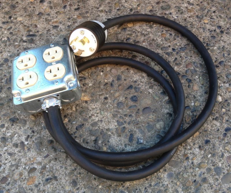

 | # Posted: 17 Jun 2012 10:03pm - Edited by: TomChum Reply
 Ok I made a new plug for the 30A combined EU2000i pair.  I thought it would cost about $15.  Guess how much it costs, in 2012 to build your own?  $44
 |  30A Plug gang for EU2000i combo

 | # Posted: 18 Jun 2012 10:52am Reply
 Perfect Tom. Thats exactly what I was talking about. I have a guy who wants to buy my EU2000i and I may sell it and get the Companion model and build that exact same cord. You used the exact type of box, cover etc that I would of. And even added the screws with nuts on the ends of the plug and not relied on just the center screw to hold the outlets in place. Great minds think alike

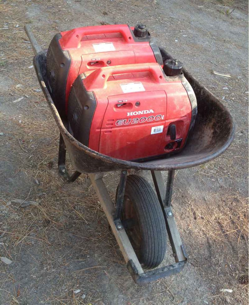

 | # Posted: 20 Sep 2012 01:04am - Edited by: TomChum Reply
 Hey TMT I found a Porter Cable at McLendon's for $99 and bought it.  I'll take the other piston compressor home.
 Here's another reason I like the pair of Honda EU2000i generators.  So easy to move around, and on rough ground, hills.  And it's easy to PUT them in the wheelbarrow too, they just about jump in their on their own.  SOOOO much better than one big heavy generator.  But they cost more.
 |  Pair of EU 2000i fits in a whellbarrow

 | # Posted: 20 Sep 2012 10:52am - Edited by: toyota_mdt_tech Reply
 Perfect Tom. That Porter Cable compressor will run with ease on just one of your Honda gennies. And do it in eco mode.
