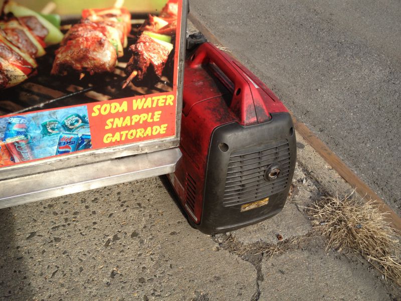

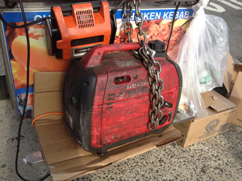

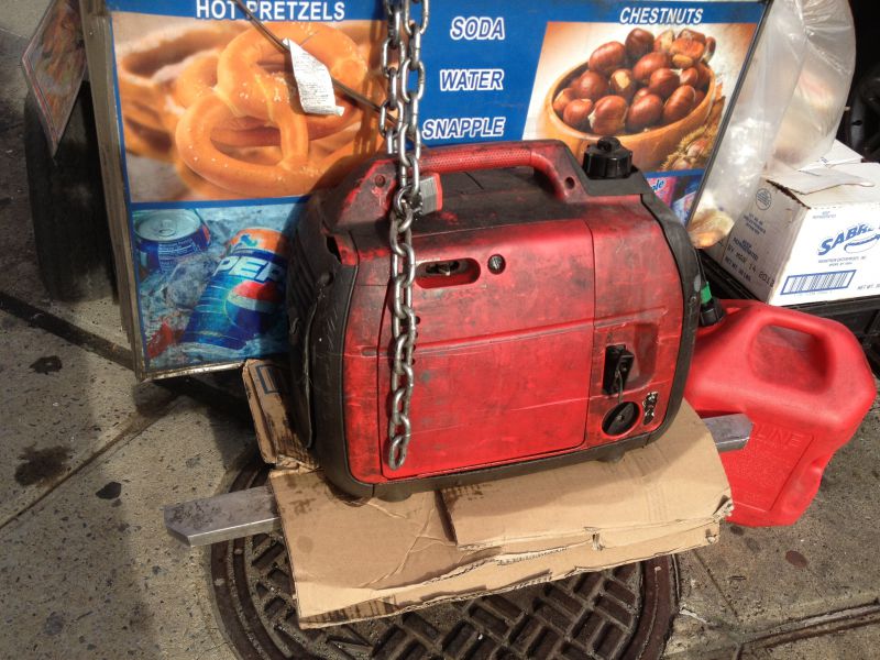

 Here we go, EU2000i in New York city. These are everywhere you look. Have not seen a Yamaha yet, only Honda. (But that could be because somebody jacked up a containerload at the dock and haven't yet run across a container of Yamahas)
